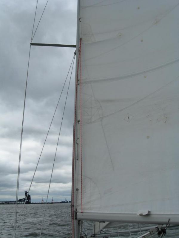

Anyone here use a furling main. I'm fairly new with this and wondered if there is a marking system for reefing. Catalina 310 2003
Cheers
Irish Rogue
PS. I meant a furling not reefing main.:eek:
Mar 22, 2009
360
Catalina 310 Gulfport Small Craft Harbor, MS
I have a furling main. I tend to reef around 18 knots. First reef for me is roll in about 3' from the end of the boom. Second reef goes in around 25 knots and that is rolled in about 6' from the end of the boom. I have marks on my boom put on by the original owner and I just use them. Have not actually measured their location so those distances are guesses as I sit here at my house.
I also have 135% Genoa. Roll in about 3-4 feet for first reef and 7-8 feet for second reef. I have marks on my genoa car track for moving the genoa car lead forward as I reef.
Crossed Mobile Bay a few weeks ago enroute to the Gulf Coast Catalina Cruisers Fall Get-Together with winds out of the North at 22+ (frequently hit 25-26) and 5-6' waves (on the beam) and in rain. Had double reef equivalent rolled in and maintained about 6 knots during the 3-hour crossing.
The main I had on for the first 18 months worked great and was very easy to furl and unfurl. However, I just got a new main last week and am now having much difficulty when I furl and unfurl. Just won't roll up or unroll smoothly. Working with the sail loft on this. Next bit of advice is to loosen the halyard for decreased luff tension. Will be giving it a try tomorrow.
