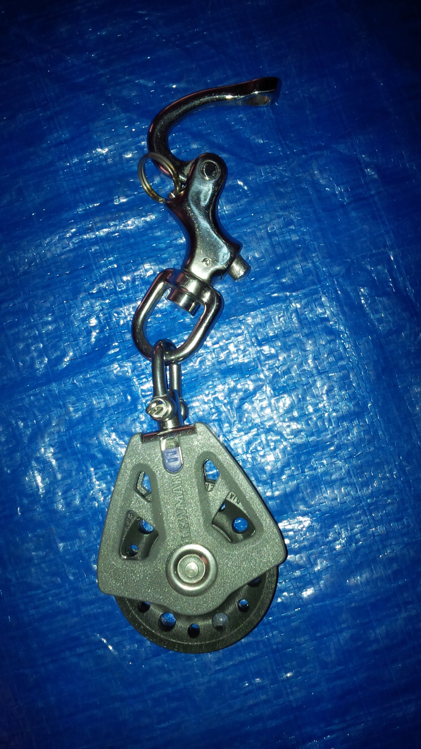

Still looking for some feedback on the size of the block being used for the Spinnaker Sheets. Don't want to go too small but also don't plan on racing the boat so no reason to oversize and spend too much money. The yacht shop already seems to have direct access to my company pay system.
I use Lewmar blocks with snap shackles. 5/16 optimal, 3/8 max, I use the same on the tack. Tack line and sheets are 3/8". Picture attached hopefully.IMG_20170502_150448.jpg

Thanks Jake ...do you know of they are ~50mm or ~60 mm blocks. Spin sheets will be 3/8" s you indicated.
