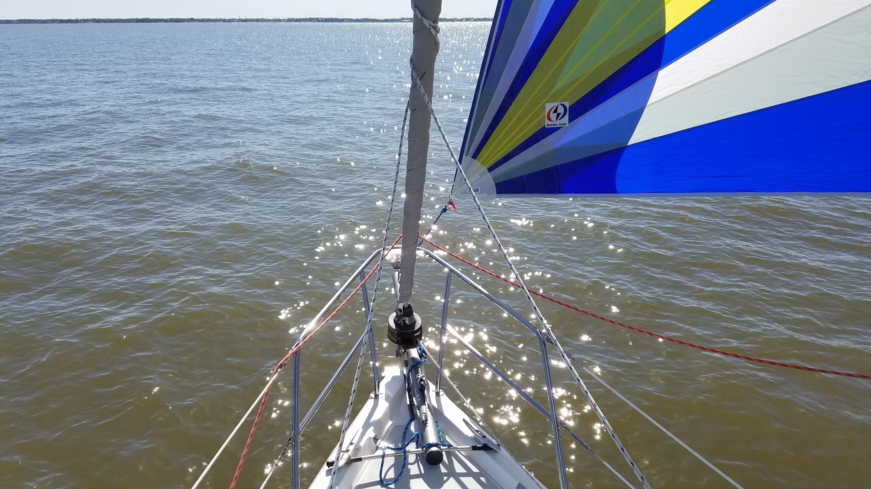

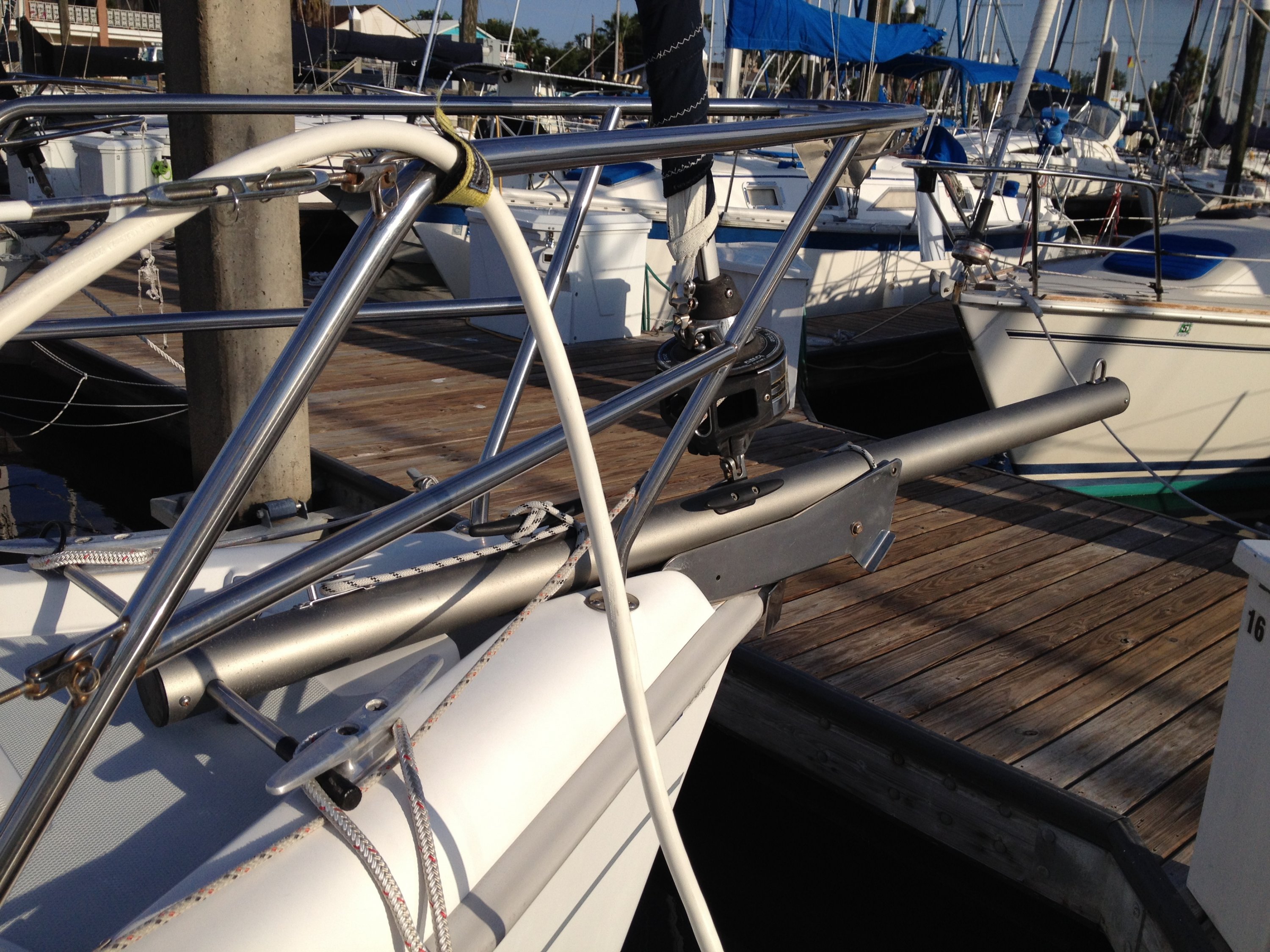

The 33 model replaced my 340 model, so they're close in size and rig. Except the 33 in the dock next to me has the forestay attached lower on the mast, so the spinnaker is probably smaller. I started using my asymmetrical with the tack on a block shackled to the anchor roller and had no problems. But, now I use a bowsprit that puts the tack about three foot in front of the anchor roller and the performance difference is noticeable getting the spinnaker out away from the mainsail just a few more feet. I used Harken 40mm blocks on the sprit and at the rings to turn the sheets to the winches. I used New England Flight Line for sheets, because it's tough to keep them out of the bay and it doesn't absorb water.The Seldon bowsprit looks like a nice piece of hardware, but I couldn't afford it, so I made my own. Hope this helps you.

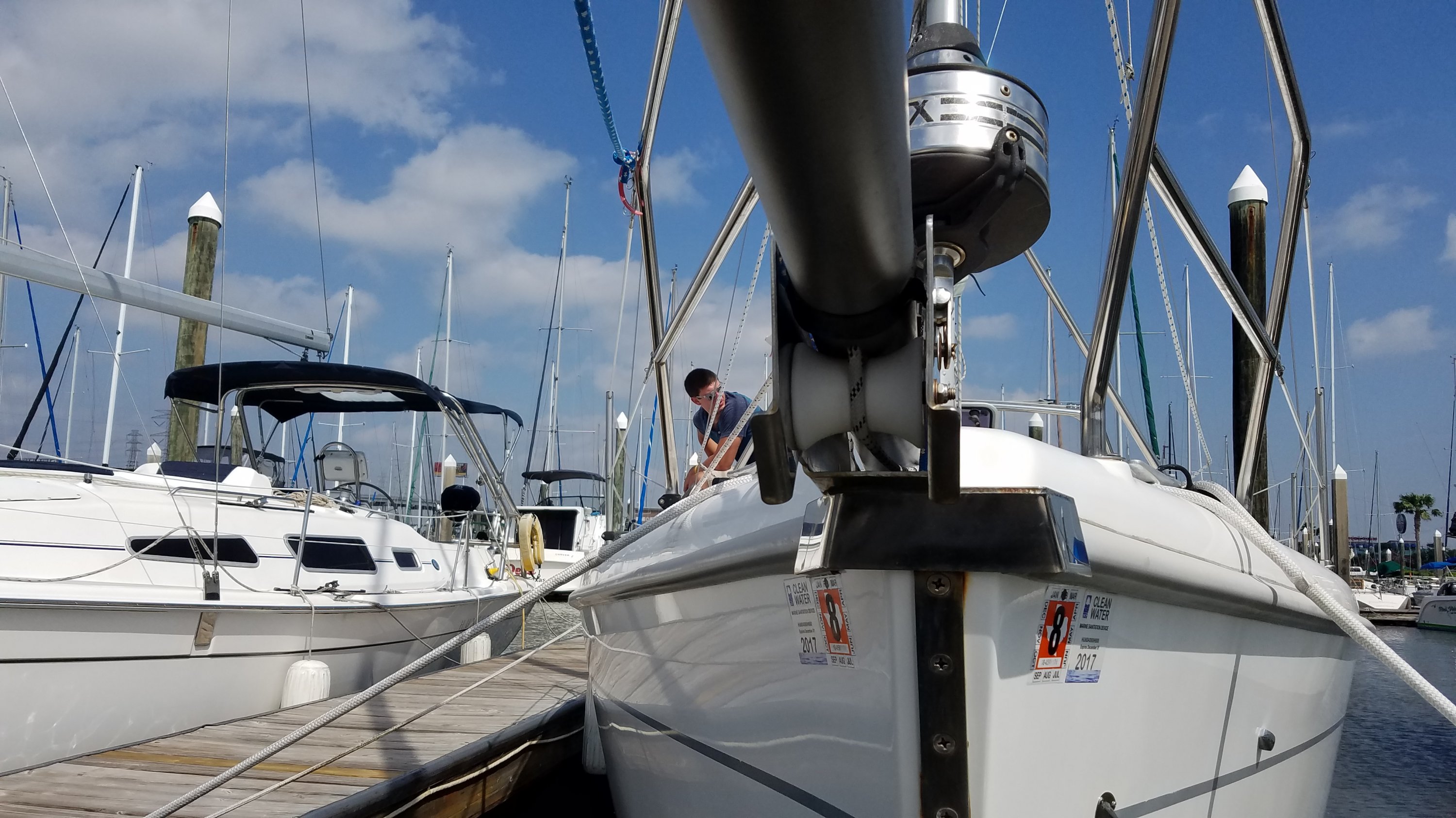

The line is knotted and passes through a stainless fender washer before it comes out of the 3" aluminum aircraft tubing I got from "speedymetals.com" for about $60 and under the anchor roller.
I'm sure there's a dozen things wrong with my set up, including not having the anchor on the roller ready to go, but so far it works for me.

Pretty slick design. You should patent it and sell them online. Looks like your neighbor has a 33 as well.

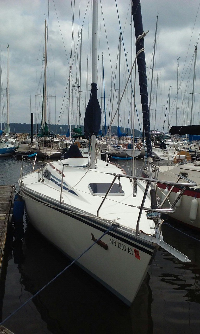

I purchased my 88 28.5 last year and it had an asymmetrical spinnaker with the boat, but other than the halyard, there was no setup for it. I did a home brew bowsprit using 2 pieces of aluminum angle stock, just to be able to try it out. It seems to work OK, though the spinnaker luff seems a bit long for the boat. Boat is on a lake in Minnesota, so it won't see a lot of heavy weather.
I may need to get a better bowsprit (looks a bit tacky), but for now, it's working. I just have to heal up from the new mainsail that I have on order.

Bill...I looks like the knotted line that goes under your anchor roller is what keeps the bowsprit from being pulled up. Is it secure in any other way or is that it? I think I will look at making one of these for a winter project. Too many things on list to start it this year.
It sounds like no issues wrt attaching the tack to the anchor roller wrt strain from the spinnaker pulling on it.

I am not too worried about the strain on the stem fitting/anchor roller on my bowsprit. I figure there's more force forwards and sideways than up. I have considered installing a bobstay, but I have seen no flexing, gelcoat cracks, or new caulking separation on the fitting. And I hope the plastic cleats, tapped threads in the aluminum, or the cheap snap shackle on the tack line will break before any problems occur on the stem fitting.
The line comes out of the bottom of the aluminum tube just forward of the roller and goes to the turning block on the aft end of the sprit and secured to the cleat mounted on the sprit. The turn gives a little mechanical advantage tightening up the line and locking the sprit down tight on the roller. I use the other cleat on the sprit to secure the spinnaker tack line. The 1/2" stainless pipe that runs through the aft end of the sprit and behind the bow mooring cleats takes all the forward force, so the sail tack is "pulling" the boat from those cleats, theoretically. You can barely see the rubber foot under the sprit that helps hold the aft end off the deck when there is any up force on the sail tack pushing the aft end of the sprit down.
There are no holes added in the deck, one line to uncleat to remove it, and really improves performance getting the spinnaker just a little further away from the mainsail. You just can't have the anchor on the roller or open the anchor locker while you're using it. I've got less than $100 in it, with the Selden or similar sprit well north of $750 probably. And I don't even want to know how much a top down furler would set me back. I'm a working man, I can't afford all those high dollar, new fangled boat thingies like all you rich yacht owners on this forum.
