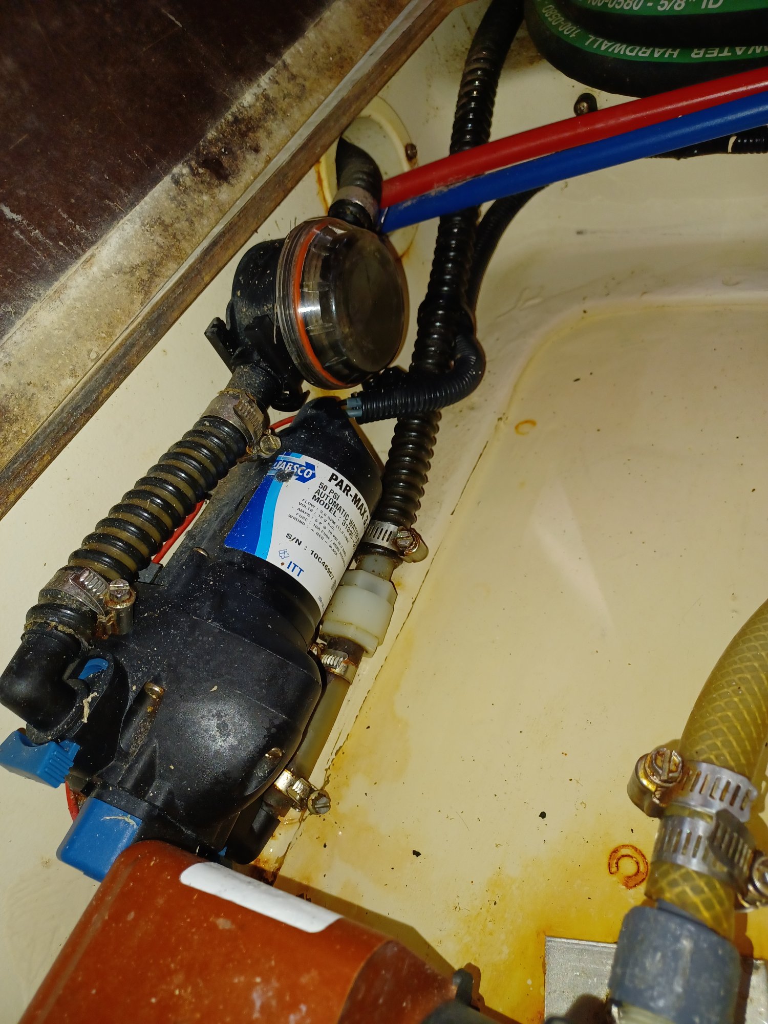

Am I correct that water from the galley and head sinks drain directly to the ocean via a throughfitting under the waterline? What about the shower? I have a sump pump panel switch, a sump pump switch under the lip of the head sink (no idea which position is on or off) and a jabsco 50psi model 31395-3000 under the deck between the head and the nav table. I cleaned the filter (the glass plate with red ring in the pic); the disgusting impassable stinking matted hair and decaying (what!?) lead me to believe it is the sump pump. When I turn on the sump pump panel switch, a light goes on, but no reaction from the pump, regardless of the position of the switch on the head sink. Is it possible that the pump burned out because the prior owners did not clean the filter, letting the pump run dry til it died? If this theory is not an entirely ignorant idea, how might I test if the pump is burned out? Where is the seacock on the sink drain...? I apologize if some of these questions seem silly ... am learning ... fast. THANK YOU All of you!

The above is all good advice, however to answer your questions, yep the sink drains straight into the ocean. Follow the line out of the bottom of the sink and you will find your thru hull. As for your shower sump. If you know how to use a voltmeter, you can turn your switch on and check the leads at the pump for voltage. If no power at the pump, might be the switch itself. If power at the pump, it most likely the pump. If you cant use a voltmeter, or dont have one, pick one up. You tube is your friend. I would be willing to wager a case of ones favorite cold one, that 99% of the skippers here have one aboard and know how to use it in detail.

Our boat came with the same stupid ITT pump. They have been replace with whale gulper. No filter needed. It will pump golf balls over board.

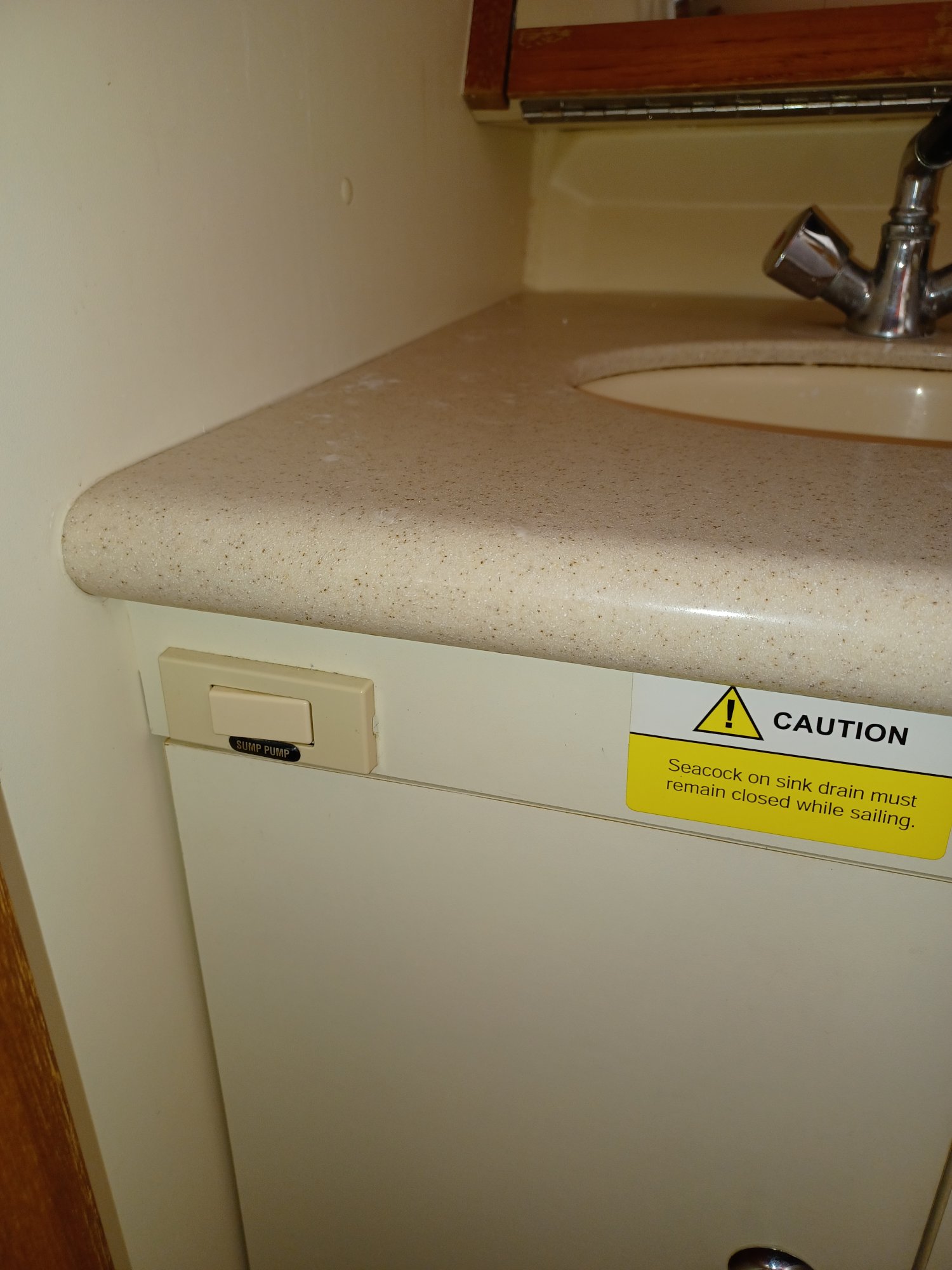

The switch on the panel supplies power to the switch under the sink lip. The switch at the sink is so you can turn on and off the pump while using the shower so it does not run continuously. If you cannot hear the pump running whent he sink switch is turned on then the pump is most likely burned out.
FYI the thru-hull for the shower sump goes above the waterline just above the hanging locker in the aft cabin. Should be labelled on a small teak box sitting on the shelf.

Thanks for that! I've cleared the filter on the shower pump, but water still does not drain from the shower into the line ... does this indicate a blockage? If yes, how to clear that blockage (chemical, etc?)? If not, is it necessary for the pump to work to siphon the water down the drain through the pump and out?

Can you hear the pump running? The pump needs to run to get any water out of the shower sump, otherwise will stay in the line and the floor of the shower.
