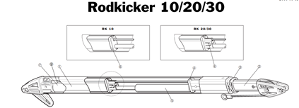

Turns out the unit I have, which I believe was stock on this model is missing some "innards" The manual I have on the boat says Rodkicker 10/20/30, and I can't tell which one I have - important as the replacement parts are different There are no markings on the unit to help. Anyone have any experience with this ? On the manual the missing pieces are the gas culinder, spacing tube and most importantly the end plug (part "6")
Can anyone help with this ?

Interesting thread on same subject: Rodkicker Issue | Sailboat Owners Forums. Long shot.......have you measured your Rodkicker and looked up the model 10, 20 or 30 in the catalog against those measurements to conform the model? Should be a 20 based on this link Parts selection : Seldén Mast AB (seldenmast.com). Then suggest contacting a Rodkicker dealer for the parts 5, 6 and 7........5 - gas cylinder, 6 - end plug and 7 - spacing tube.

The "guts" were an option for the boat, there should be serial numbers on both tubes, parts are still available. There's also a long, hand etched number on the underneath side of the boom, near the mast

thanks all - indeed, a Rodkicker 20 with the hard spring. Seldon recommends the 308-073-05 kit - pretty pricey. I read somewhere there may be alternative suppliers for gas cylinder, one is MasterCarr, but we can't find the correct replacement
Any other suppliers, ideas, information ? Maybe 'll just run the topping lift line aft and use it ?
