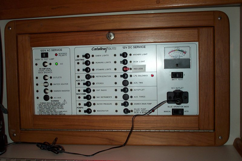

Does anybody know if this boat automatically charges while on shore power? I assume that it has screw plugs which means I should fill it with distilled water if needed?
probably. One simply way to be sure is to monitor the voltage at the batteries once you plug in. Another way is to look at the charger. Most have “idiot” lights.
Presuming you mean battery caps, yes. Don’t overfill.

If the white breaker on left of panel labeled charger/inverter is on, and it's plugged into shorepower shown by green light also on left then yes unless some major muck-up. There's a voltmeter on the right of panel that reads1708396710659.png the battery voltage. To find charger stick your head into the port lazarette in cockpit and look forward, it's got lights and adjustments for type of batteries and temperature. To find batteries look under the starboard settee in the cabin.

In 20 years previous owners may have done any number of things with the boat’s electrical system. Checking the battery voltage when plugged in versus disconnected will at least tell you if there’s a working charger. But you’ll want to start looking around and tracking wires to understand what you have and how it connects in case you run into problems.

Is your boat on stands right now or are you able to keep it in the water? If your boat has been winterized, the batteries may also be disconnected. You should do a compressive search of all the components and learn as much as you can about the charging system. There is also a master AC switch in the port locker underneath the rear corner seat. At least there is on my boat. That switch will also need to be on to get power at the panel. How many batteries do you have? There should also be an echo-charger or some other relay that allows the charger to charge 2 banks of batteries. My boat had an echo charger that was mounted under the seat cushions where the batteries are located. Good luck and let us know how it goes!
