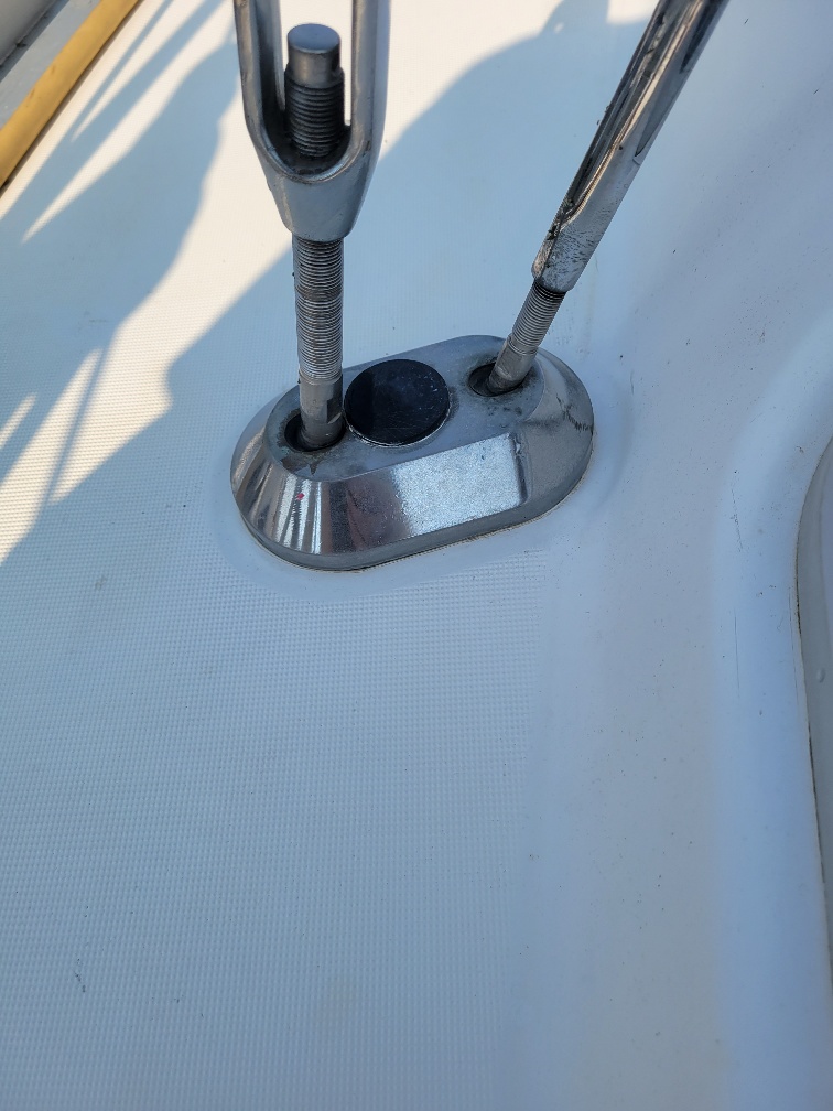

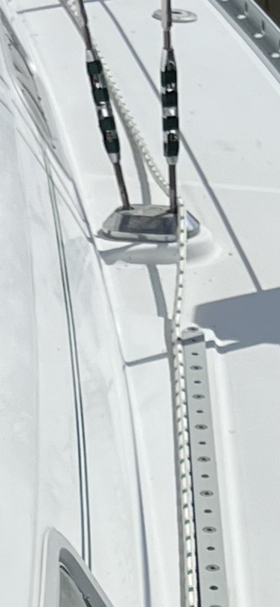

Thank you Roy. The boat is new to me but from the view in this picture, it looks like the cover is pushed down and covers the opening without any screws. My guess is a little gentle prying will allow me to lift it and expose the holes with the rods.

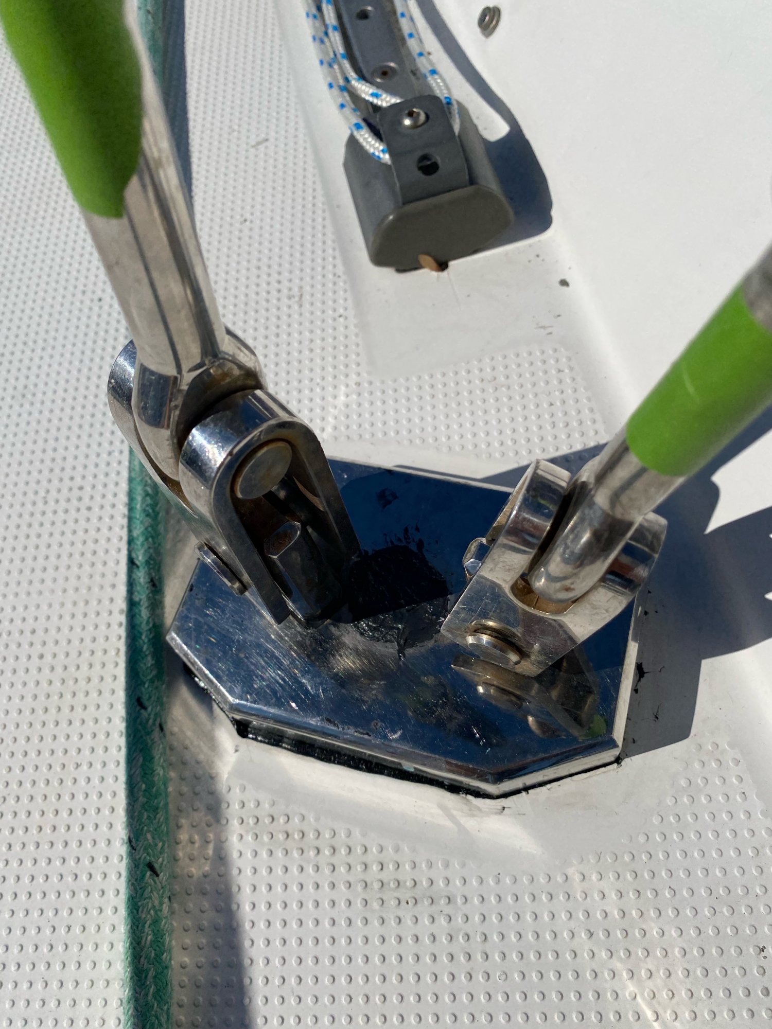

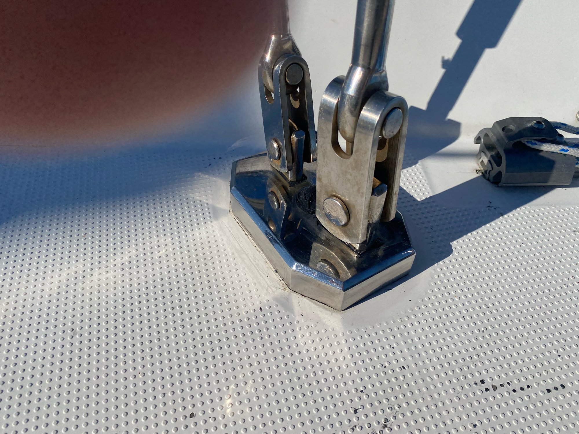

I just redid both chainplates on our Bene... not the original fittings but a similar system.
..... My guess is a little gentle prying will allow me to lift it and expose the holes with the rods.
The 'cover' is held from below by two (almost hidden) screws in the overhead either side of the tie rod.
I did one side at a time, secured the mast with halyards, backed off the shrouds, disconnected and removed them from the deck fitting (you have original Beneteau setup so may have to totally unscrew the turnbuckle body from the bottom stud). There are two screws under the deck either side of the tie rod that hold the deck fitting in place.. The tie rod threads out up through that fitting, so maybe you don't need to remove that. Ours leaked around the 'ball' end of the tierod where some ancient Butyl had dried and cracked. We used Sikaflex to rebed the deck fittings and reseal the tie rod end. Fresh (quality) Butyl might do too..
You do have to thread the tie rod back into place so that may disturb the sealant somewhat; so I added sealant over the tie rod top between the shrouds after the tie rod was retightened.
Mark your turnbuckle settings AND tie rod thread position with masking tape first soas to get yourself back to the original settings.
Once one side was complete, we secured the other with halyards and repeated. Not a bad job, completed in about half a day.
If you are primarily leaking around the tie rod fitting the it may not be necessary to remove the deck fitting, but if you're going to all that trouble you may as well rebed that as well.
You can see the difference between fittings below but the basic physical arrangement is very similar.

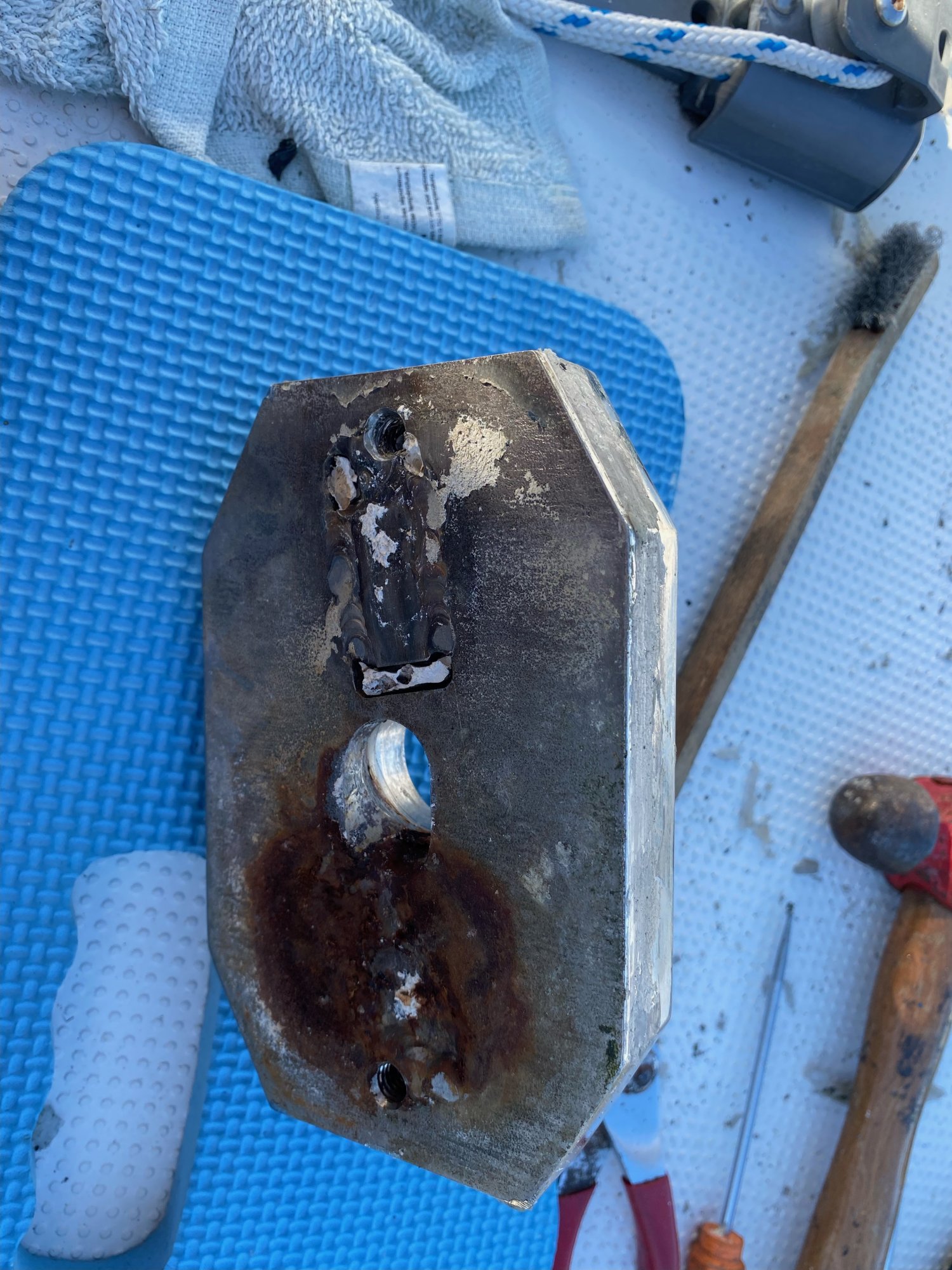

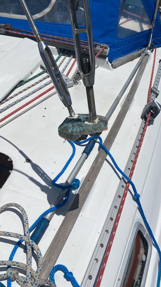

I came across these pictures where that connection you showed, failed.
It's a Bene.
Sep 24, 2021
386
Beneteau 35s5 Telegraph hrbr Thetis Island
It's a Bene.
View attachment 211231 .
Ouch!... good find....
Looks like severe corrosion of the deck fitting itself..Must have pulled free of the tie rod ball too, I expect, unless all that looks just as bad!! Somebody wasn't paying attention!
I've heard of a corrosion failure of the crosspin (at the bottom of the tierod) on a B 40.7 in the caribbean.. due to a long ignored deck leak at the chainplate.

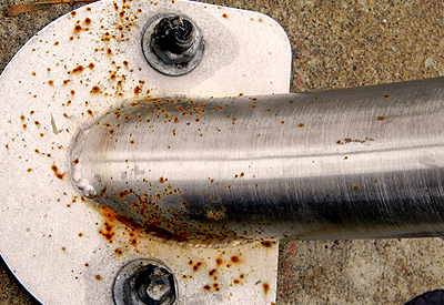

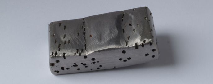

24,753
Nice clean repair and procedure @Hollyberry .

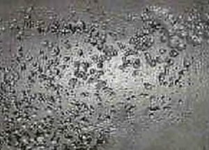

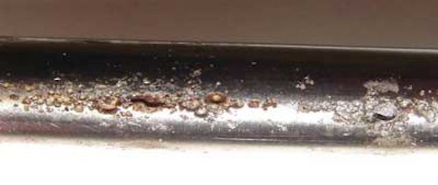

No matter the brand, all boats need to be inspected for stainless steel corrosion. It is an annual task on my boat. Crevice and pit corrosion is the secret destructive operator on Stainless Steel.
The material looks fine on the outside. It is where water sits on the stainless, in the cracks, little surface pits, and places hidden with out oxygen that corrodes. Like a cancer it eats away at the part from the inside.
These are a few examples.
The through deck placement of chainplates and the swage fittings of shrouds are common suspects on sailboats. It is up-to the owners to be vigilant and protect our boats.

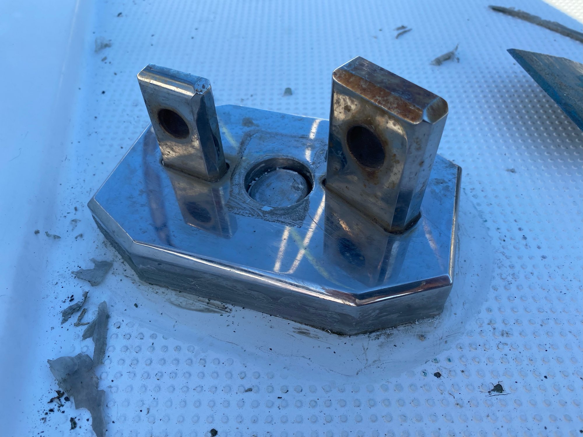

To support jssailem's point, unlike the Beneteau deck fitting (chromed bronze) our replacements are solid SS. Even so, you can clearly see below where the tie rod leak sat (and eventually traveled) to the 'downhill' retaining bolt and dripped into the boat there. Significant effect on the SS in that area.
Had this been a salt water leak and the original bronze fitting it's not hard to envision serious degradation of the material leading to the failure shown above. Could be why we have these new, improved custom SS bits.....
