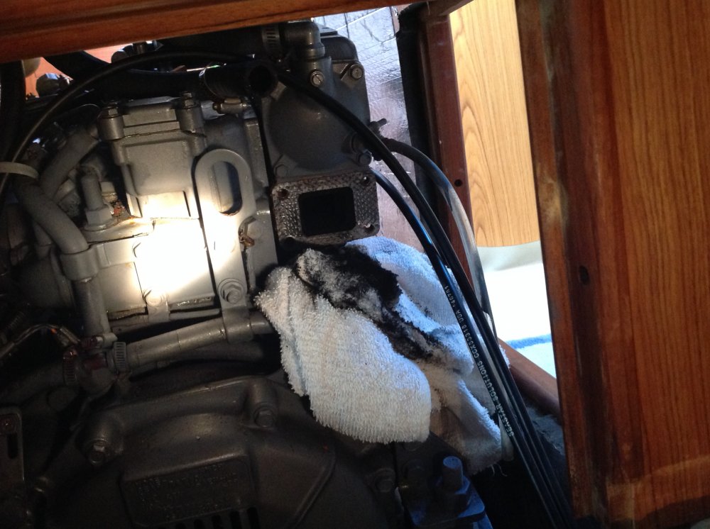

I didn't see any sign of gasket sealant when I took it off. Is there suppose to be?
There typically isn't for original equipment, it it's a metallic exhaust flange gasket; but there are those who differ, and the debate is a stepchild of the engine oil debate. I've done this on a Universal M25 and used the new metallic gasket bare. Get a new gasket, at least.

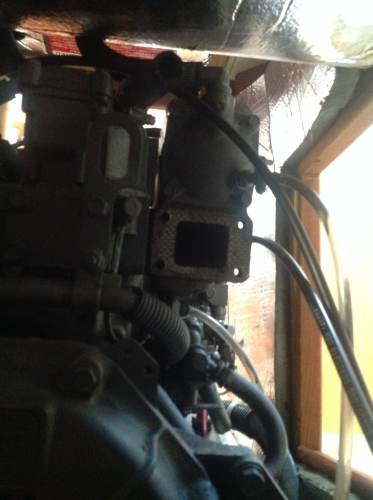

Yes you are seeing the entire unit, manifold, nipple and elbow
What you have removed here is not the manifold. The manifold is the thing that collects all three exhaust ports on the head into one outlet - hence "mani"-fold. The thing you have removed is a flange, riser, and mixing elbow. The flange attaches to the manifold. The riser is not standard Yanmar, as it's supplied by the engine installer, usually.
When I re-did such an assembly I purchased a new flange, just in case I ruined the old one taking it off the pipe; a new flange gasket; new studs and nuts. I had a riser made by a local plumbing place out of schedule 80 iron, and fitted the new elbow and flange. I then wrapped it in exhaust insulation.

Jviss. Yanmar makes two factory elbows. The photo is the Yanmar cast iron riser. The other model is not cast and there is no rise to the shape. Rare to see shop made on these motors. The best direct bolt on part is HDI Marine - no contest. Flange riser nipple all in stainless. Gasket too. All for about $275 US. Elbow only $155. https://hdimarine.net/product-category/yanmar/

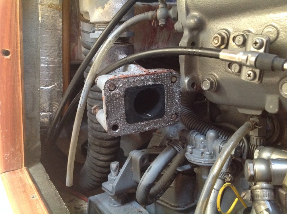

The pictures of their model show a smaller round opening in the riser as compared to my original, which has a larger rectangular opening. Did this reduce the flow of water in your engine to any noticeable effects?

If I read you correctly, that rectangular opening in your pic has no water flowing through it, only exhaust gas. The water is introduced at the elbow, and flows out the other way into the hose.

Your right, I wrote it backwards. I meant the gases. But did the model design effect performance of the engine overall?

Round or square it is the area that matters. After all the rubber exhaust hose is round. And the inlet/ outlet to the water lock. In any case never could detect any performance degrading. Also never heard anyone complain either. You could ask when they call back. Remember your present system has been pretty strangled probably for a good long time so performance will improve anyhow.
ps You could always use your old flange- the square one

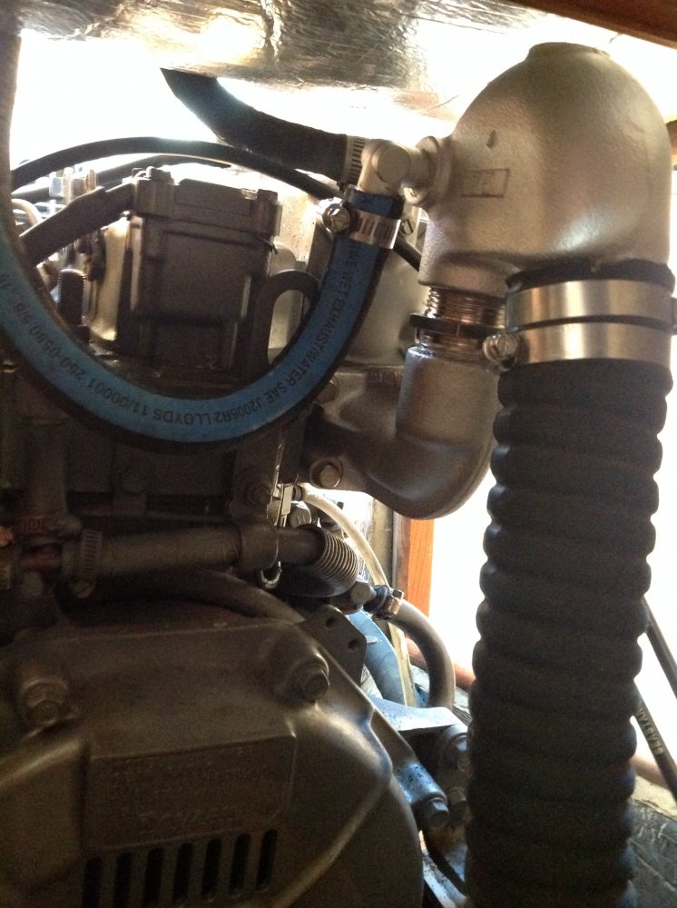

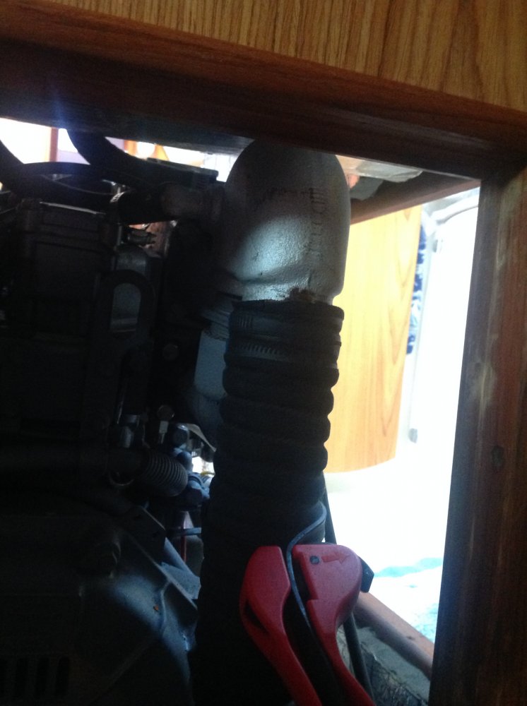

Well, problem solved, the job is completed and it's running perfect again! No Black Smoke or loss of power. Hard to say if I have more power but I'm sure there is some.
Due to the confined space and impossible to even get the size wrench I needed to connect the parts in there, I assembled all three pieces outside and then lifted it into place. Not an easy thing to do, what with holding the part and trying to start a bolt. By far that was the hardest part.
I reused the existing exhaust hose, for now. As no one had the size I needed when I needed it. Everyone can get it in two days but that's no real help. Heading out to Newport later today for lunch and will get it there and install tonight. No real issues getting the old one off, used a good pair of rubber palmed gloves and a filter wrench for grip and it twisted off easy enough.
I did have to use a longer hose from the vented loop to allow for the angle of the fitting on the elbow. I simply routed it behind the engine instead of across the top as it was.

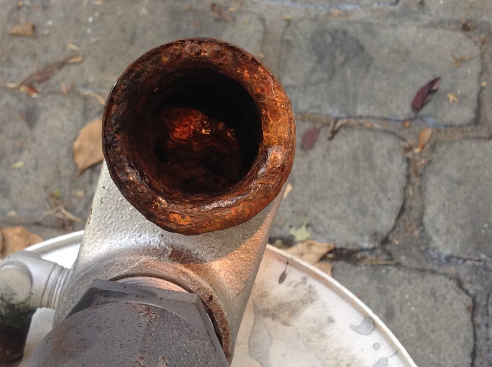

Took some photos of the process for others to see and judge the work involved. In the picture of the old parts you can see a large chunk of carbon (actually there were 2, same size) that fell out when I removed the elbow. It was just a blocked mess.
