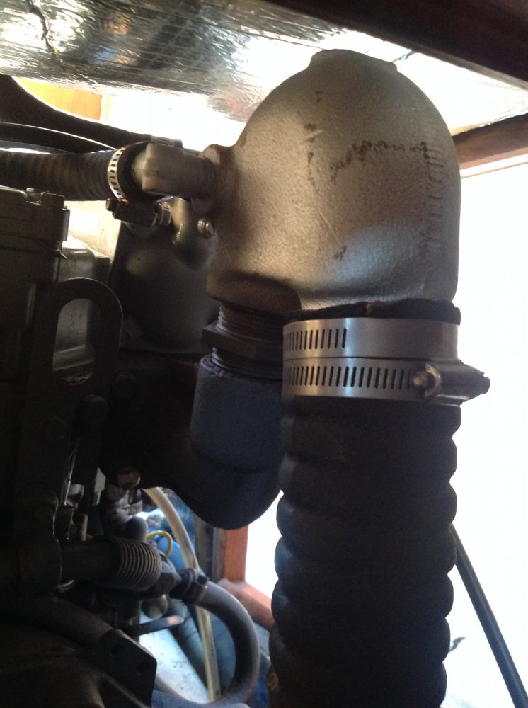

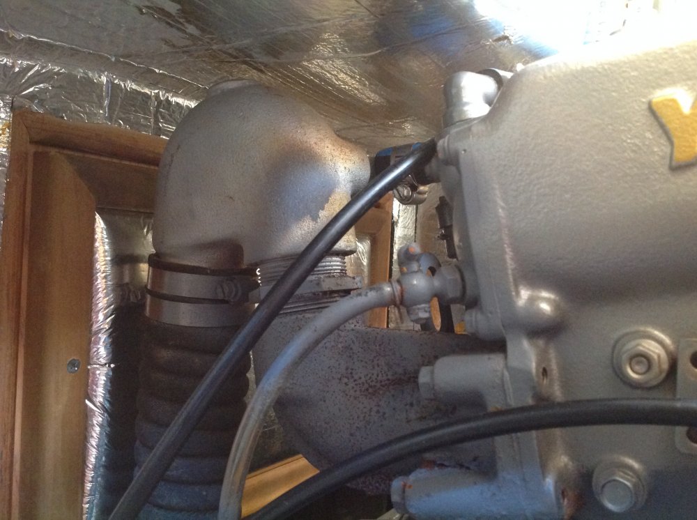

I thought I would work off yesterday's Thanksgiving Dinner (and given the 2 degree windchill outside).
Also, thought some might like to see inside a 17 year old Mixing Elbow. By far cutting it in half was harder than doing the whole job.
Take note of the blockages at the seawater entry port and where the exhaust and water mix and exit to the exhaust hose.
No wonder I wasn't going anywhere fast.

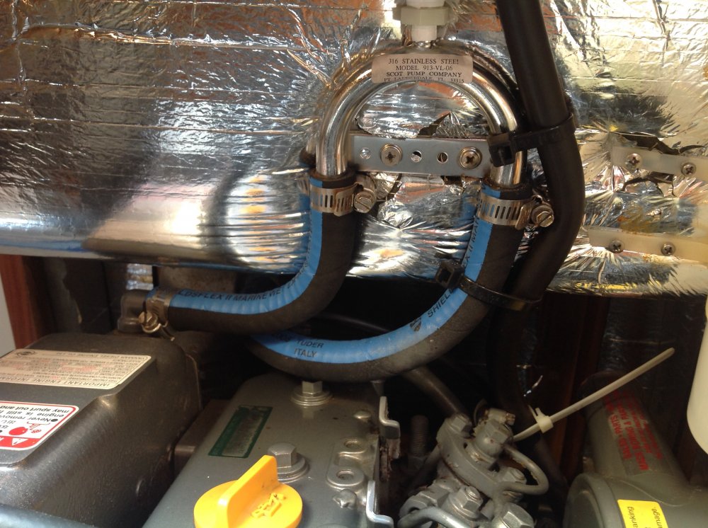

If you decide to replace your mixing elbow I highly recommend you look at HDI Marine. They make elbows from 316 stainless. I looked at their products and spoke with the owner at the recent Pacific Marine Expo held in Seattle. Check them out.
HDIMarine.net
360-824-0800
