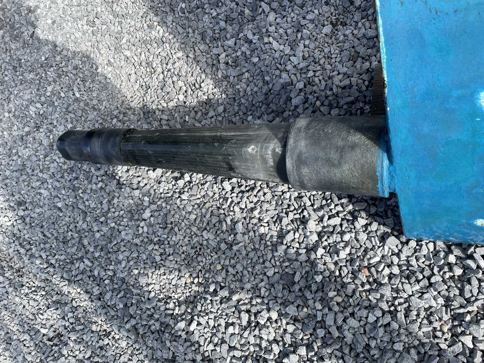

Hi all,
Hoping that someone can help me out with a rudder issue.
We purchased the 411 6 months ago with a very stiff rudder. Figuring that we will haul it out at the end of the season we used the boat as is. The rudder got a bit worse but still usable.
In mean time I purchased the whole bearing kit for the rudder from Beneteau.
Hauled the boat out and dropped the rudder to find out the rudder shaft is carbon fiber and the kit doesn't fit, it was made for stainless steel shaft.
There is no obvious reasons for the rudder to be stiff. Actually it came right out without a problem.
Any info or suggestions would be greatly appreciated.

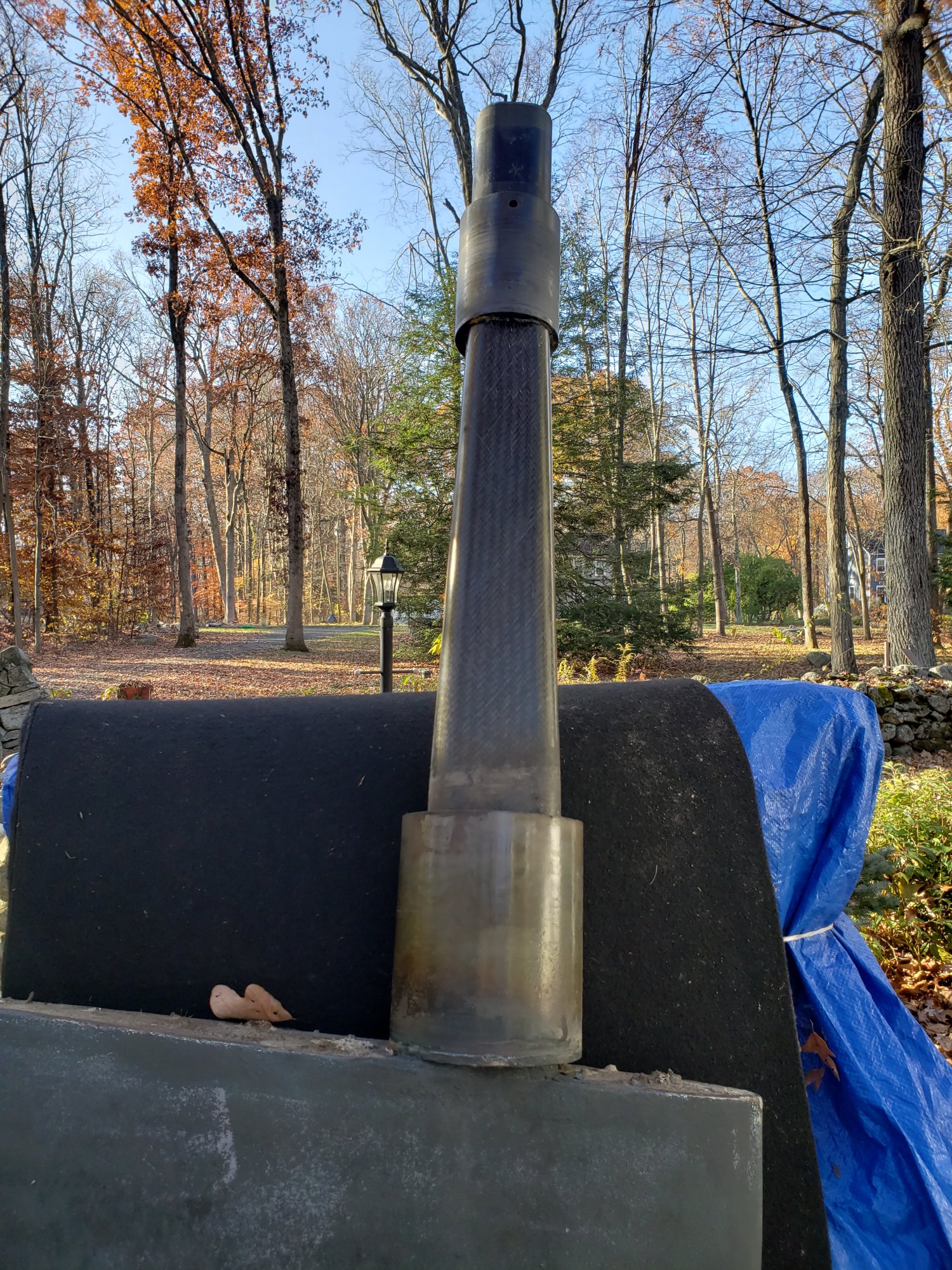

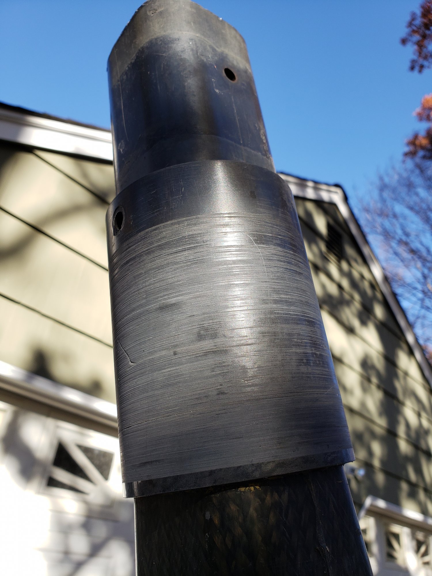

I had the same issue on my 1999 B411. On my rudder, the upper bearing is some type of plastic. There was plenty of grit and dirt on the upper bearing. This caused "threads" of plastic to form from both upper bearing surfaces. I took a lot of measurements. In the end, I 220 grit lightly sanded the threads off of the bearing OD and used a water-wet extra fine cylinder hone to do the same on the upper bearing ID. My lower bearing was a different story. It looked like I had sufficient clearances but had to wait to Spring to reinstall. I did lightly sand the lower bearing OD just to clean it a little. I was able to test the upper bearing clearances by inverting the rudder and inserting it from above- worked well but was a little awkward.

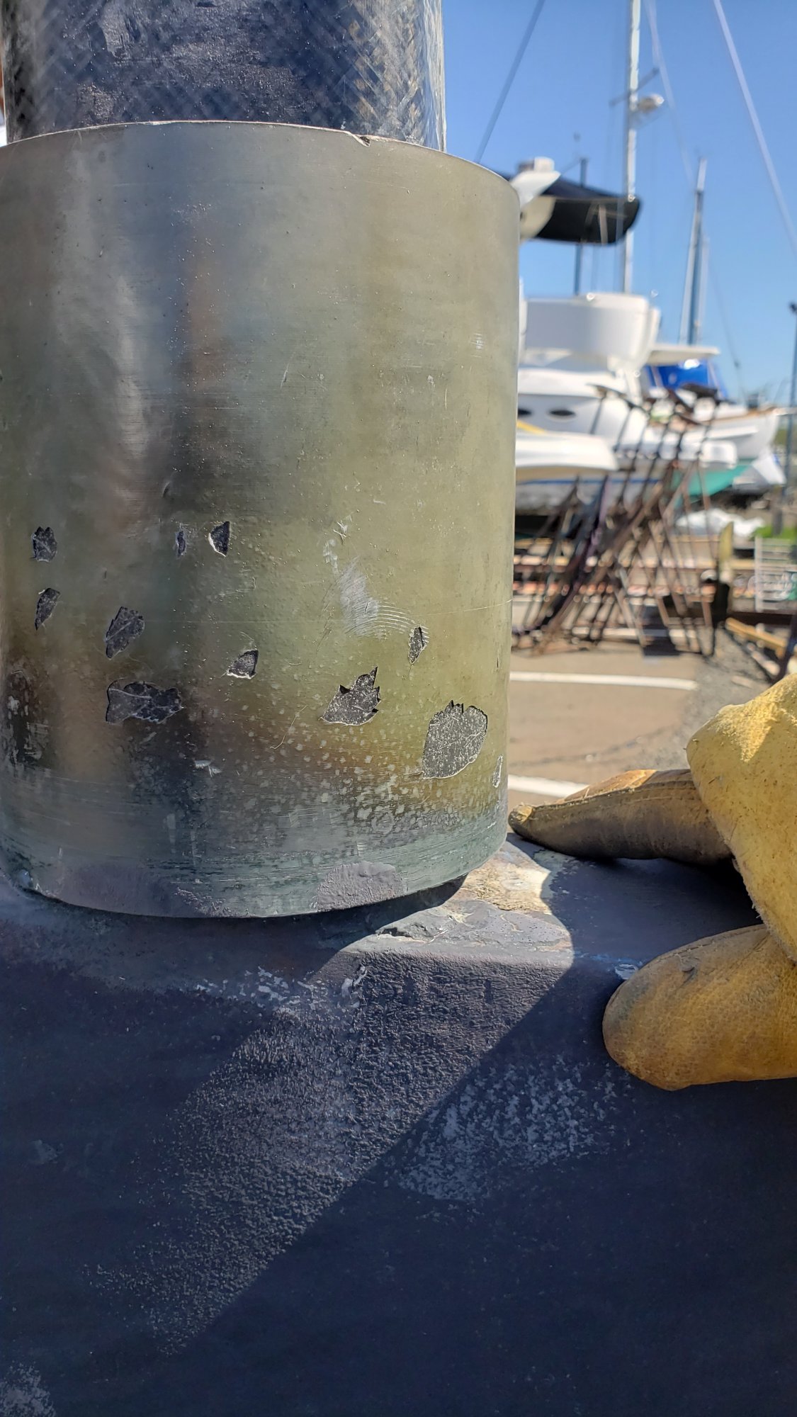

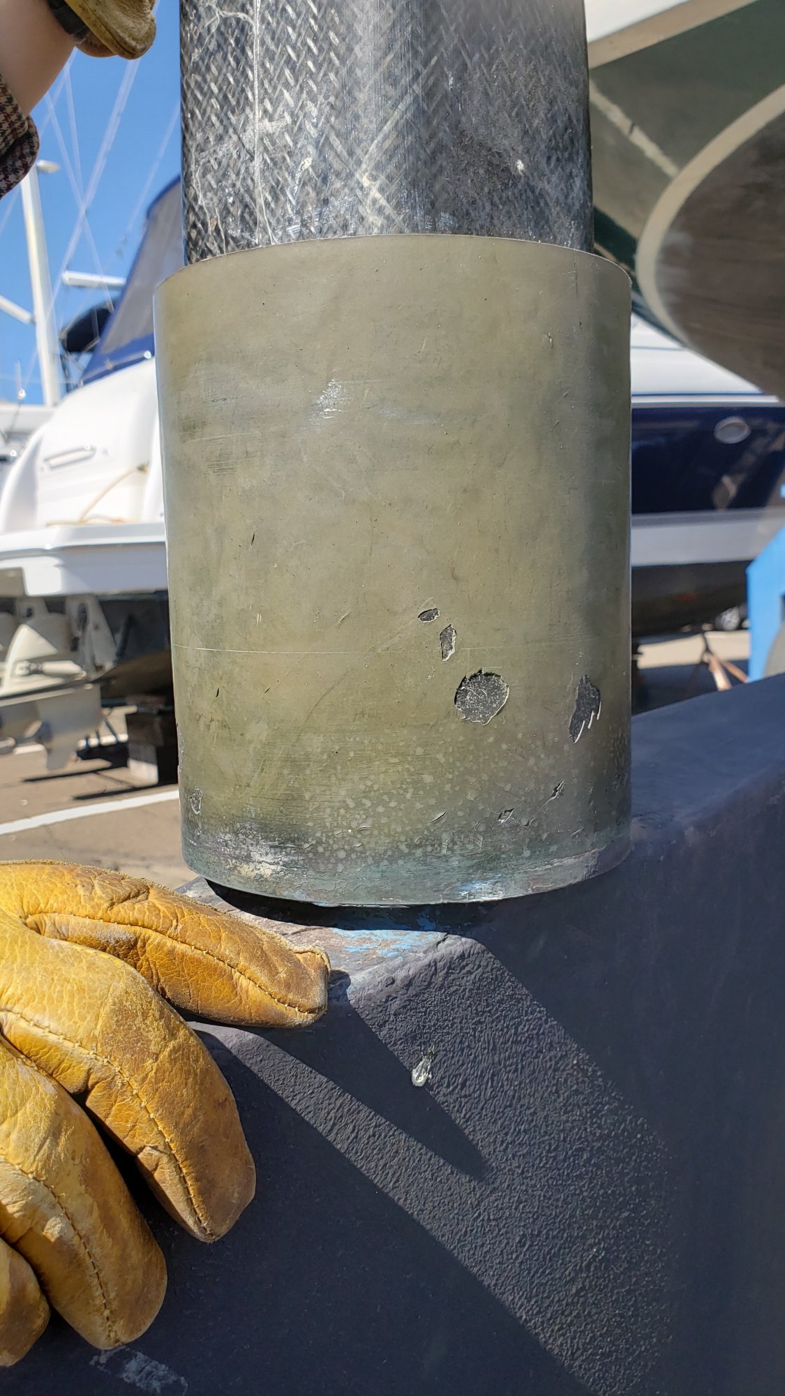

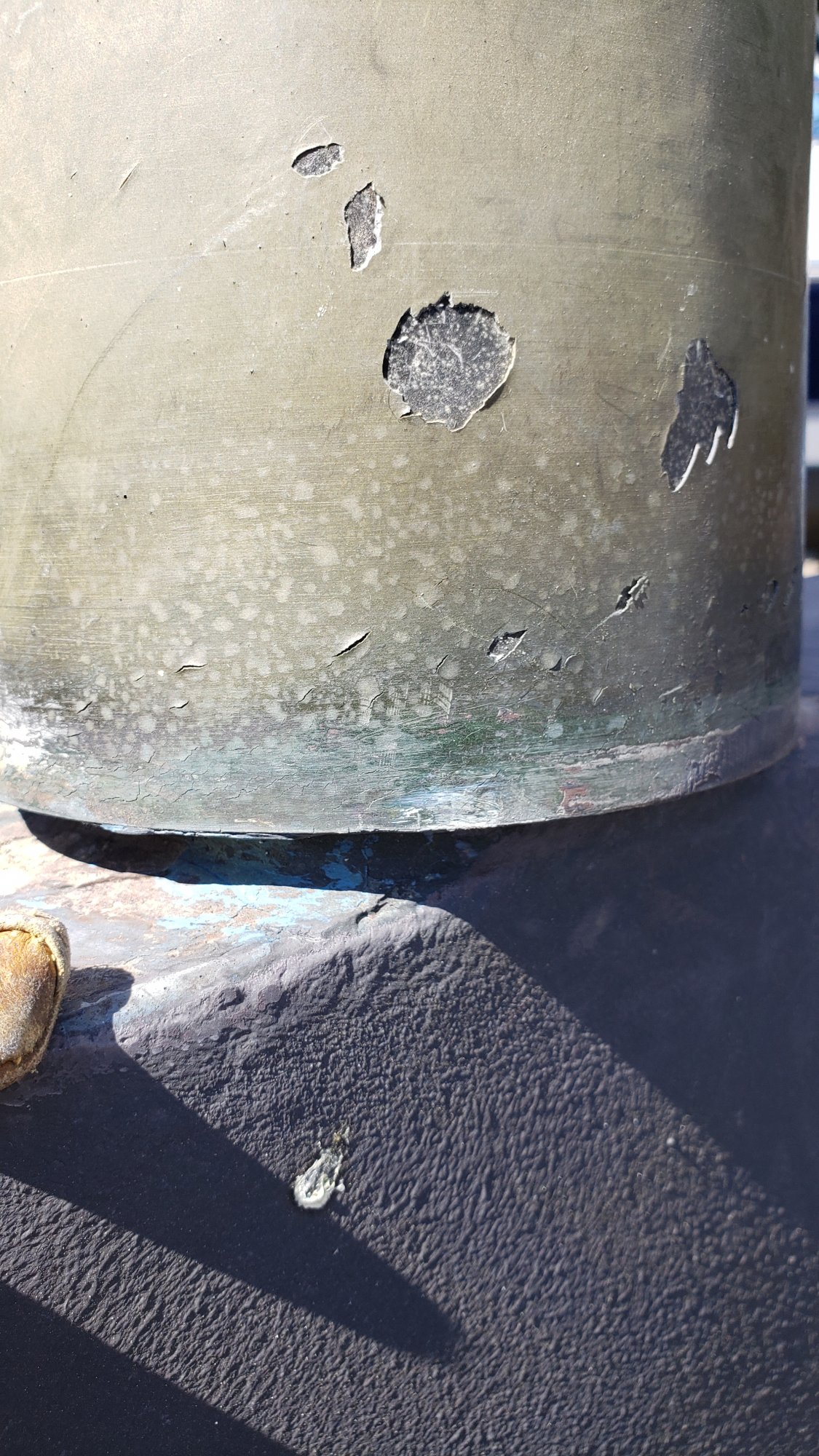

Fast forward to Last Spring. When I tried to install the rudder from below the lower bearing would not go in. The rudder bearing OD had 1/4" surface cracks and tiny blisters at those cracks. I emailed Tides in the beginning and also after finding the cracks. Got good response from Skip Lookabaugh <skipl@tidesmarine.com>. His appraisal of my rudder was that someone had applied a resin (epoxy?) surface layer to the lower bearing. Made the decision to sand the bearing OD (since the resin layer was added by someone after initial manufacture) until I got a good fit. Been smooth sailing for this year. Two of the pics below (202011...)are just after removal and the (202105...) are the cracks and blisters referenced above.
