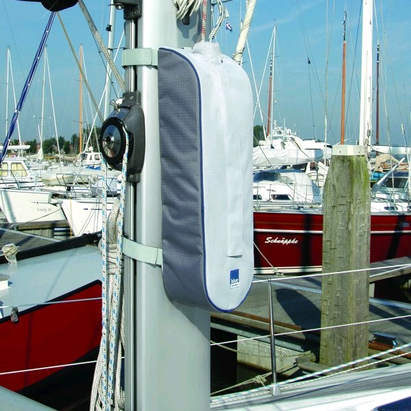

I do not remove my halyards. I do have a little extra length to them. I keep the tail of the line in a canvas bag on the mast to mitigate some of the exposure and to keep the lines organized.
In the spring I use the extra length with a messenger attached to haul down the line that has been exposed to the weather and give it a good bucket rinse at spring commissioning. My running rigging has been on the boat for 6 years. 2023 season opening I’ll give the lines a careful inspection paying attention to all signs of aging.
