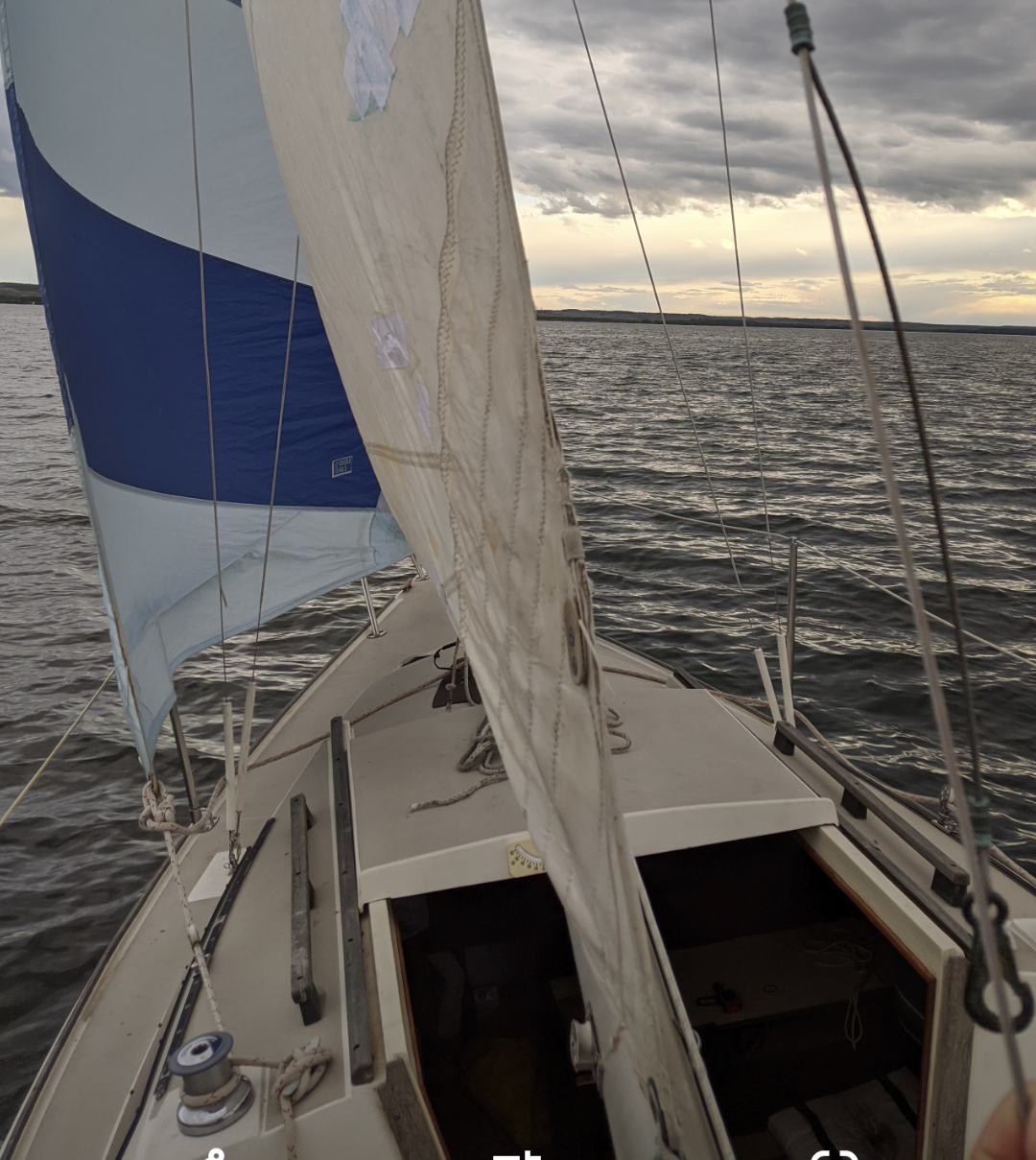

Thanks! Perhaps in the videos they have additional blocks on tracks further out on the main deck or something. This was one examplehttps://youtu.be/kcBFyZk1VZ4 but either way, it doesn't seem like I'm doing anything crazy then.

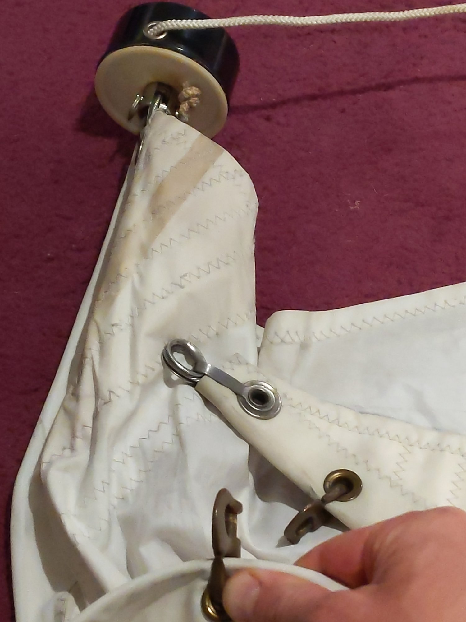

As for the jib... Here's a picture. There's a solid steel cable running through it, my assumption is for hoisting it free from the forestay so it can be furled. But it also has clips which would be jammed within the inner part of it when it furls. I guess in worried that they might wear out spots of the sail from sticking out into it each time it rolls up

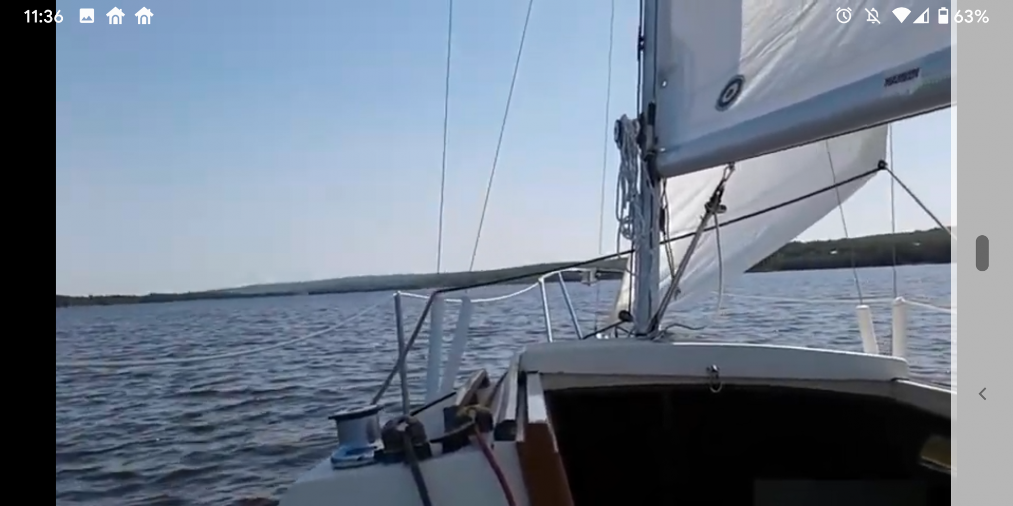

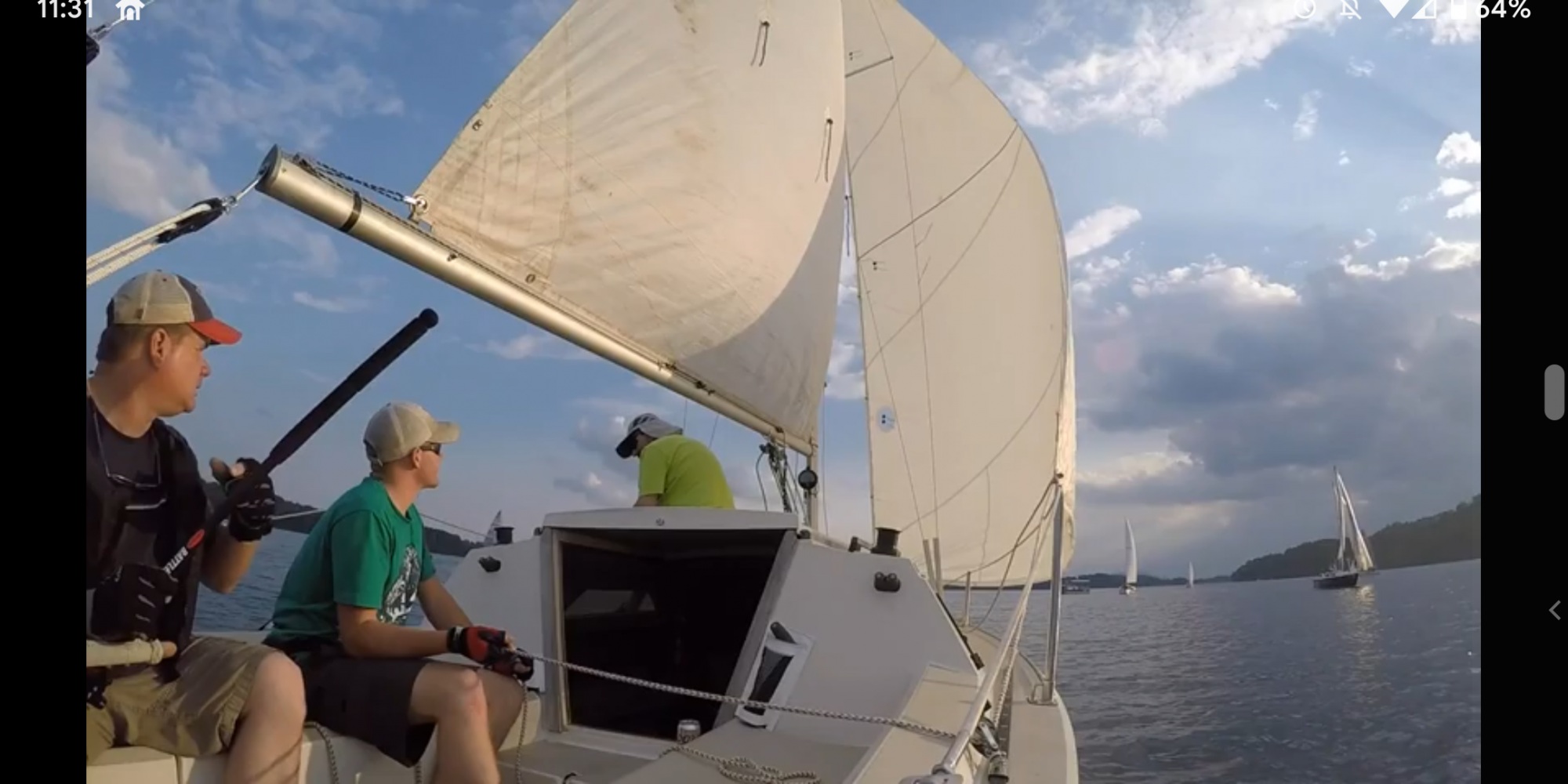

Here are two more screenshots of what look like configurations not using the standard jib blocks. I guess I'm just wondering what the advantages of the modification are / making sure I'm not missing something! I haven't been able to get an owners manual yet so I'm mostly guessing at everything :)

The stock setup for a 222 is with a 110% jib on a wire luff roller furler, the plastic drum Shaeffer kind. It's widely panned. The "eyebrow" jib tracks on the edge of the cabin are standard, and are for adjusting the amount of twist in the jib. The sheets need to route through the block on the jib track on the cabin. Wire luff roller furlers are used just to roll up and store the jib - they are not stiff enough to partially roll up the jib to reef, and though people do that, it won't roll up uniformly. You need a rigid luff furler to reef well. I don't know why there are piston hanks on your jib, that's certainly not standard. As for jib track running down the side decks, yes, this could be added by someone in order to sail with a bigger "Genoa" jib with greater overlap of the mast, and thus the track would need to be mounted further aft than the track on top of the house. Genoas are commonly 135% or 150-155% and could improve speed in lighter winds, but not too light as then the weight of the sail prevents it from setting well in very light air. Because the track on the side deck opens up the sheeting angle, it's likely that a boat fitted with a Genoa will not point quite as well as the original 110% jib. Also, tacking an overlapping sail is a pain.
