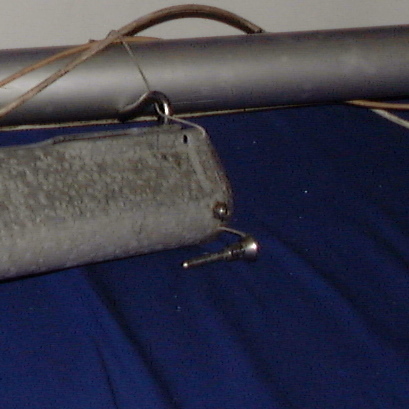

I use push pins that the PO lanyard on for just about everything. This one was used to pin the goose neck. You can just see the thin nylon lanyard. He drilled about a 1/16 hole through the skirt of the pin.
West marine has them for under $7 the way they are made the ball cannot retract on its own the pin must be pushed in so the ball can drop into a notch and the pin cannot be extracted accidentally.
On the other hand the fast pins have a spring behind the ball that will allow the ball to collapse and the pin can be yanked out. They have their purpose but not around rigging.
I have also found that frequently the clevis rings get snagged by the sheets and yanked out. I use them but no where near the sheets. On the shrouds I use cotter pins.
