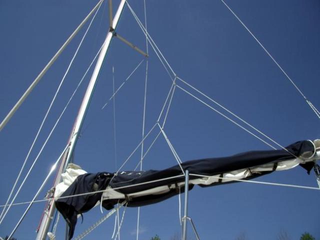

Larry, I'm sure you've searched the archives and found Georges fine assembly of all things H260 including the manual. A rigid boom vang is a sweet option. You can say goodbye to that normally batton snagging topping lift line. Lucky you.
Bilgewater, I'd sure like some pics of your reefing system. Anything like the pic from Harkin below? Almost went with the simple lazy jack sys pictured below also but the boom would start to look like spider web of lines, with that and cockpit reefing lines to snag everything in sight. Opted for simple(nothing) but a cockpit reefing sys seems a very worthy summer project when I pull the boat out for the broiling season starting next week.

Soling 42 - I'll try and get some pics this weekend. Yes, the system is very much like the Harken drawing, but with two lines instead of one. I think you have more control and get a bettet setting sail with two lines.
I never bothered with lazy jacks. Always thought they were more trouble than they were worth, especially with a boom kicker.
