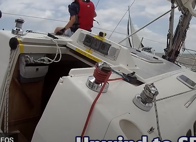

Bill's posts from racing his 340, "Sunspot Baby" give a clear picture of the running rigging.. An autopilot is a very good crewmember to have aboard when singlehanding..
Yes, @Bill19233 has a third cabin top winch located outboard on the starboard side, where my turning block/line stopper for the starboard jib sheet is located. Of course he races with crew. Looks handy, but not sure of cost/benefit for me, cruising not racing.
Screen shot from one of his videos
Likes: Bill19233
