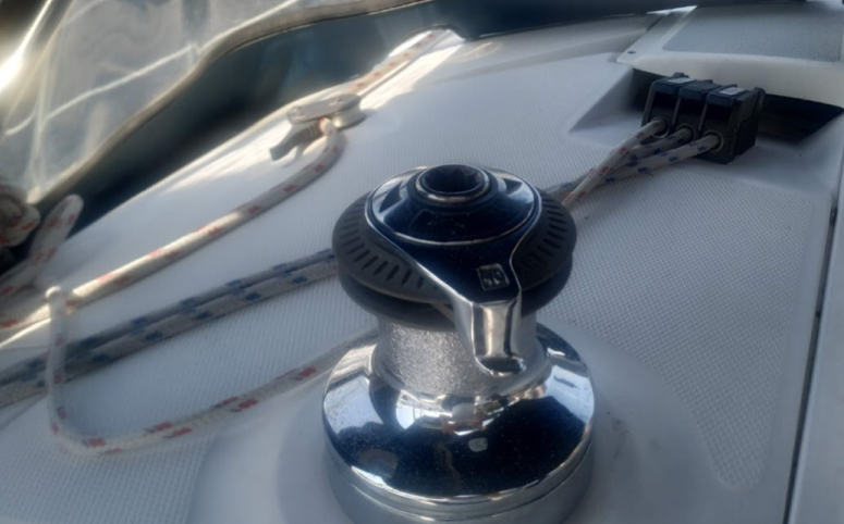

I'm just wondering about very basic best practices for securing the lines on a 2000 340. It has two winches, on either side of the companionway, no cleats on the sides of the cockpit. Are the flimsy grips sufficient for the jib sheets? A number of experienced sailors have noted the absence of a third winch and cleats on the sides of the cockpit. How do you keep the lines secure without cleats? And are you just meant to use the clutch for the mainsheet? (I also note that the line for the boom vang has nowhere to go on my boat.)

Hi. Your rope clutches on top are used to “stop-off” the sheets and halyards, as I see you suspect. These are more efficient to use than horn or jam cleats b/c if properly aligned fwd of the winch, the winch can hold the tension while you set the clutch, then free the winch. If horn or jam cleats there, you’d have to remove the sheet or halyard from the winch b/f stopping it off. That’s on top. As for headsail sheets, most of us have ST winches at the cockpit coaming and the sheet remains in the grip until it is released to ease or tack. As for the “flimsy” grips, they will hold tension but I would prefer a horn cleat; but, in any case, there should be a sheet winch on either side of the cockpit. So, you should have four winches, IMO.

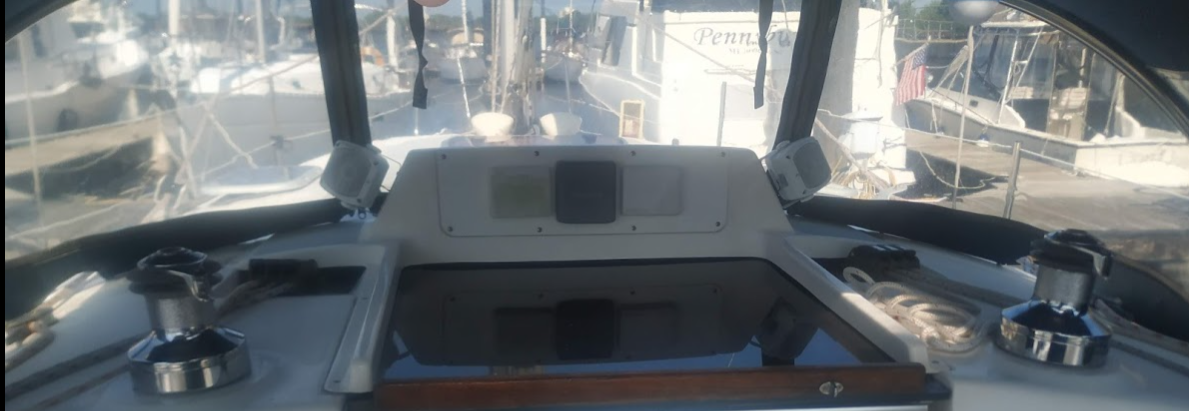

@Kings Gambit because of the Hunters fractional rig layout the jib sheets are on the cabin hood inside the shrouds.
The two STwinches beside the cabin companion way are used to trim the jib sheets.
@MikeTheHunter I would use the sheet trimmed in on the lee side, wrapped on the winch and left there ready to adjust. I would not “lock” that sheet in any way. You want to be able to release that sheet in a hurry if necessary.
The other sheet is the “lazy sheet”. You can coil it and lay it in the cockpit or in a sailing bag.

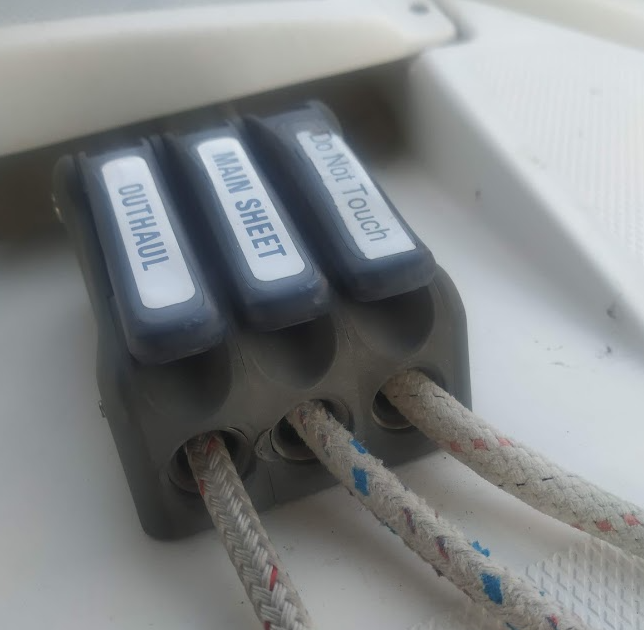

John,
OK. I see it now in Pic#2. Thx.

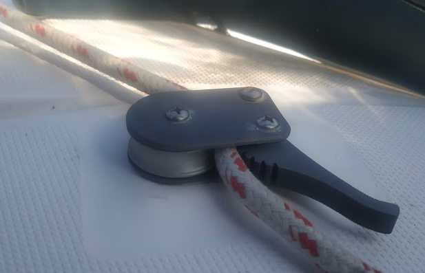

I think he would need to use those grips to stop-off the jib sheets if the winch were needed to trim the mainsail or the outhaul. I have those things (grips) on the Bavaria to stop-off the furling line when the headsail is roller-reefed, and the jib-sheet-car control lines. They essentially function as clutches but by using the turning block (sheave), do not have to be aligned (fair lead) to the winch as a clutch would be. Rope clutches cannot take much side loading.

I believe the block cleat (I don't think that's a jam cleat--what are those cleats on the block called?) on the 340 are there in the event that you do need to free up a winch for the main sheet or halyard. The block cleats look small, but with the smaller head sail on the B&R fractional rigs there isn't nearly the pressure on the jib sheets as there are boats with greater than 100% head sails (in fact, the 376 manual states that with the small head sail one may not even need to use winch handles to properly set the head sail while tacking or gybing).

I'm just wondering about the safety of having the jib sheets on the cabin top rather than on the cockpit combing. If you need a quick release, and you are solo or have inexperienced crew, you have to go around the wheel to get to them. Having them is a stopper just makes it worse. I would much prefer them in reach of the helmsman.

Witches on top of the cabin top mitigates sheets in the cockpit, which I never liked for safety reasons......easy to get tangled up on something or worst yet the leg(s) of the captain or crew. All 4 winches are on the cabin top and withit autopilot no big deal to leave the helm to release or winch them on a tack or jib. That was a really good Hunter design feature along with built-in sheet and control line pockets on each aft side of the companionway just below the winches.

Mike, the 340 came standard with the 2 cabin top winches, although I've seen pictures with a second winch on starboard. I find I don't need the winch for the main sheet and normally just leave the working jib sheet on the winch on both sides. If I need the winch for other purposes, I'll use the line stopper to hold the sheet temporarily.
