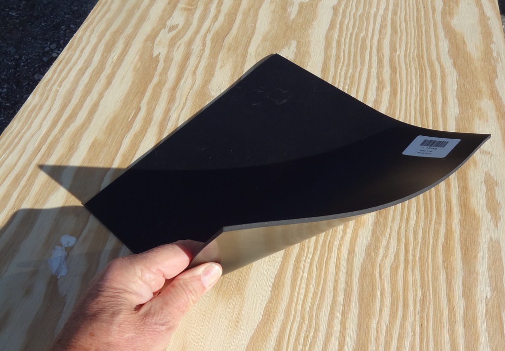

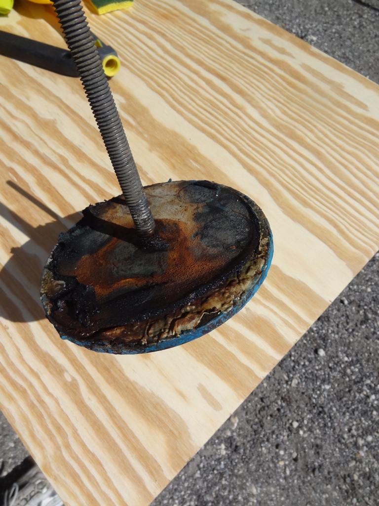

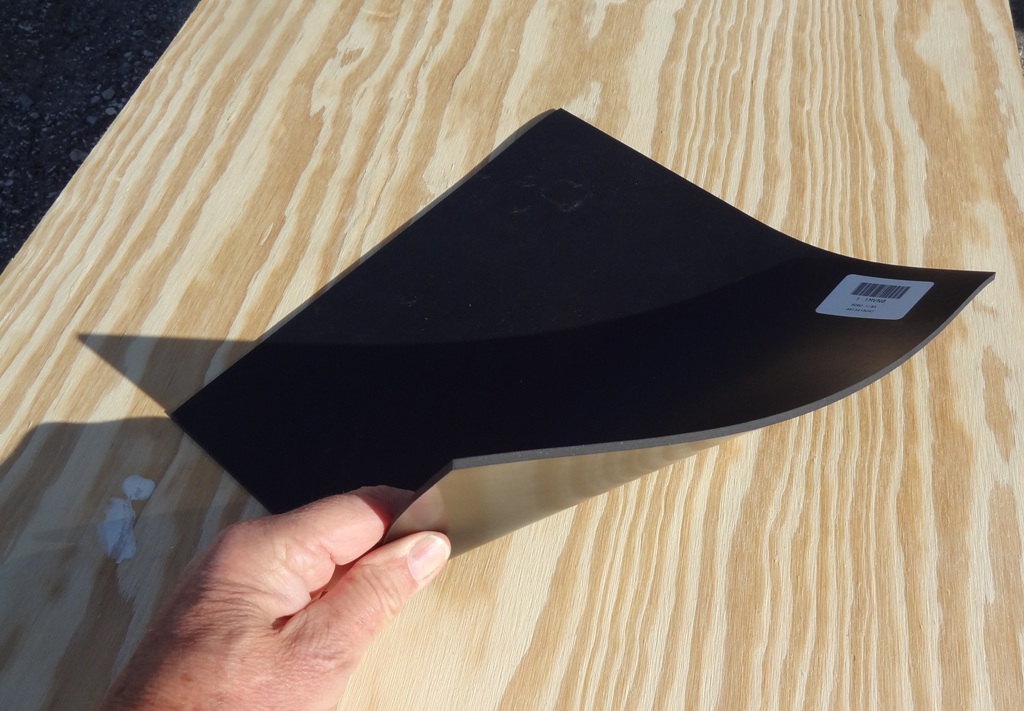

The ballast valve on my boat was not sealing properly either. With the boat launched I pumped as test some water out of the ballast tank (with a hose pump) and found it quickly filled up again.
It is needed to have a good seal there otherwise the water level in the tank will constantly change when sailing, as the pressure on the hull changes by situation.
As on the dry for maintenance I checked the valve gasket. The picture shows what I found. I bought a sheet of neoprene and cut a new gasket, glued it on with 3M 5200.
I keep the valve closed when mooring. Hope that helps,
Hart
Aug 3, 2013
3
Hunter 26 Wells next the sea
Wow chaps, thank you so much for the responses - both much appreciated and welcome. Glad she hasn't yet gone into the harbour based on what I have found. Now, a supplementary question, if I may?
I got the impression that the gasket sold by the site would quite likely amount to something like the neoprene solution you have suggested - especially when the item description suggests you 'cut to fit'!
Could you give me an idea of the thickness of neoprene you used to such effect?
The photos give me hope! Your 'before' image looks much like mine and has undoubtedly been influenced by leaving the valve open as advised.

Thank you all for helping the fellow. Glue it with 5200 but make sure old glue is removed from the plate and clean it off with alcohol or acetone.

Dave, Hart, Chris - thank you all so much for your prompt and valuable help. I am now looking to see if I can get 3m 5200 this side of the pond. The valve came out easy as you like the other day and now sits outside here in the yard - looking very much like your 'before' image Hart. Have to say the existing gasket looks very sorry for itself and is in no way attached to the metal plate. I will contact 3m UK to see if there is an equivalent if I am unable to locate the real thing.
