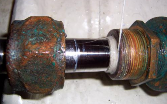

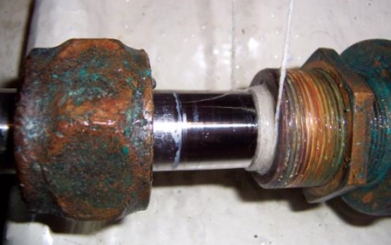

Sorry. The prop shaft illustrated. Do you know the steel type used?
That's a pic of my shaft after many years in service with 5 months every winter without turning a degree. Given that it was made in 1998 or earlier, it's likely Aquamet. There are more exotic alloys out today that have higher strength that Aquamet but I don't see how they could have more corrosion resistance.

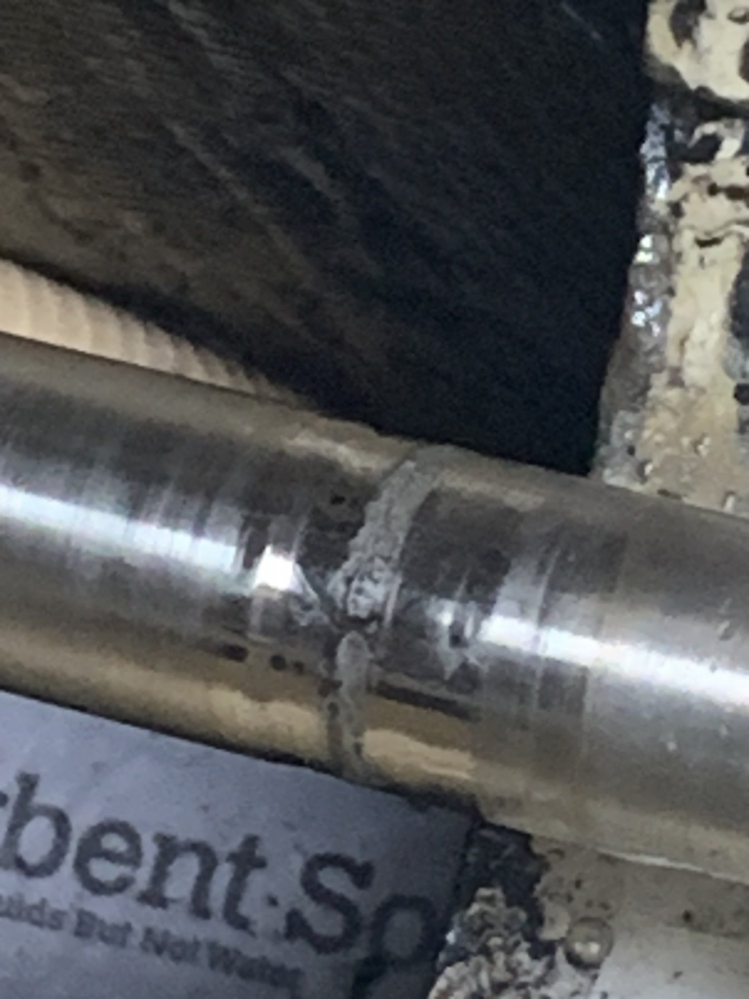

I had to replace my prop shaft when I discovered pit corrosion even though the area under the traditional stuffing box looked shiny and smooth.
This is what I found after opening the stuffing box and then sliding the shaft up the shaft log. Evil hiding out of sight.
