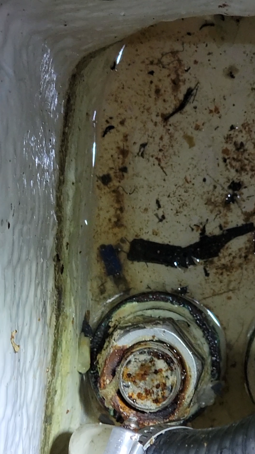

It would also be good to know if (a) it's even possible to drop the keel (on the hard!) without damage to the hull, (b) what the keel bolt and nut are made of and their torque specifications, and (c) what gives with the large hard rubber rings (shock absorbers?) beneath the nuts on the four keel bolts in the main (larger) bilge.

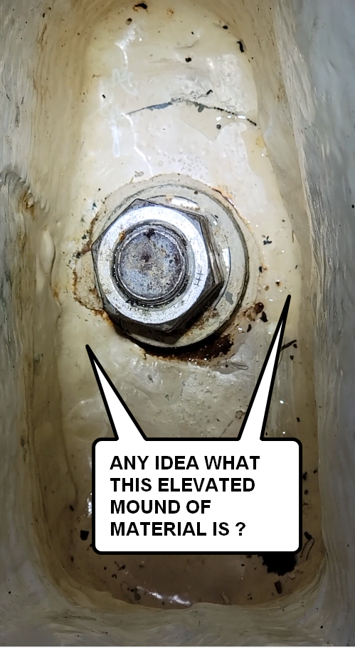

Do you have any idea what this crap is :

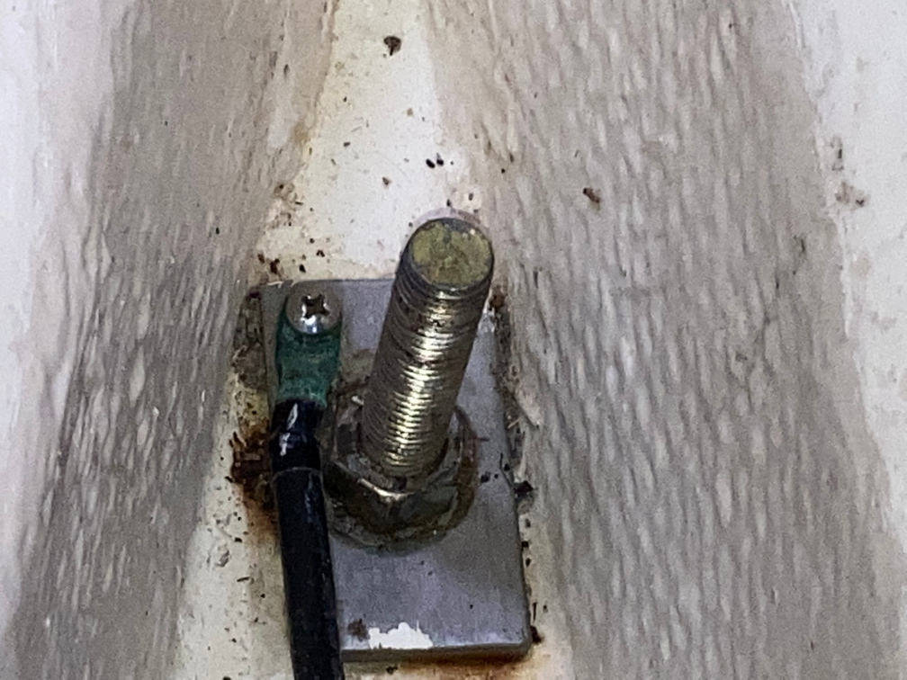

It also appears in your other bilge :
Does it appear under all of the keel bolt washers or is this an optical illusion?

Boat cancer?
Someone speculated that it might be the (steel plate?) washer, covered in the last fiberglass layer and gelcoated.
Should I peck away at one and... "discover"?
In the first photo, perhaps you can see the tiny pooling of water oozing out of that crack above the bolt?

That's what I thought for a first guess.
A little learning is a dangerous thing. Alexander Pope (1688-1744), or Big Al as we used to call him. You've got to find out exactly what you've inherited, warts and all. I can't say I feel well at all looking at what you've got. And I have no idea what you've even got. I'm sitting here wondering, is that nut bearing down on a large SS surface or is it just pressing down on FG and gel coat. There are enough cracks to make you wonder. You really hope for something like this :
I saw it live in the video. I can't remove it from my retinae, try as I might. Let us know what is under there.

I hate to say it, but those rubber rings were probably added to try to stop water coming in around the bolts.. probably needs to get looked at very closely while on the hard as has been suggested.
Upon further reflection (and morning coffee) I've got to say that what you've inherited is a mess put together by one or more mental black holes. Although I don't think that picking away at one of these bolts to see what's underneath is going to place your boat in any peril, it's definitely a waste of time. The sole purpose of this mess in your bilge was to stop the water from coming in and not to correct the problem from the outside.
Guess I was optimistic, referring to them as shock absorbers.
