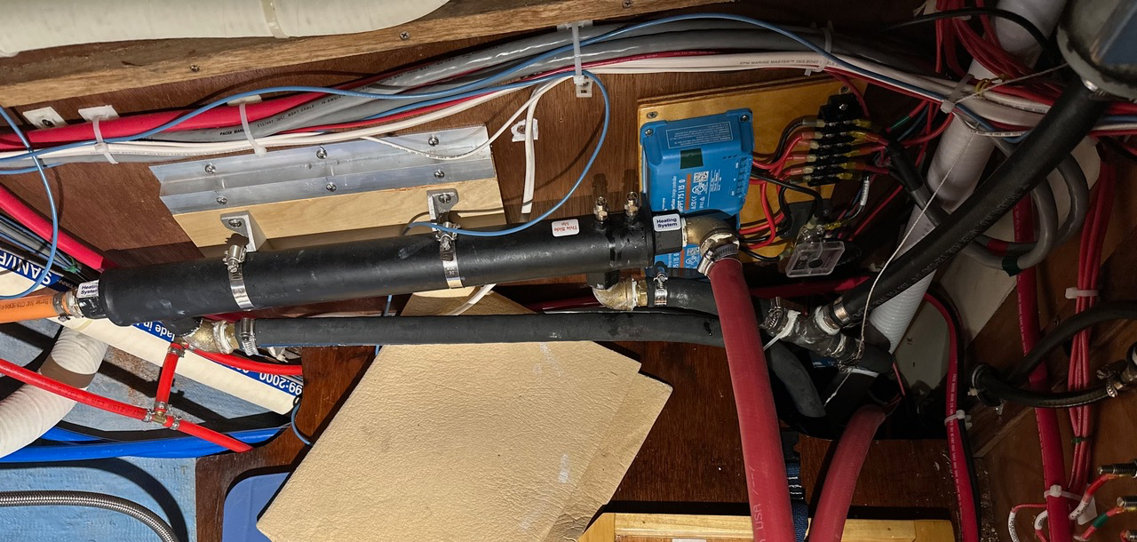

The heat exchanger heats the heating fluid from the engine. They are 2 separate systems. The engine coolant and the heating fluid never mix, they are separate systems. See the attached photo, the engine coolant enters the bottom of the heat exchanger while the heating fluid goes through horizontally. As a result it gets warm regardless of whether the heating system is calling for heat or not. In my case, this is both a benefit and a deficit. After motoring for a long while (a not so popular pastime on the ICW) the hot water lines get warm, this reduces the amount of water that must be drained to get hot water. On the other hand, all this and the batteries are in the same compartment, the LFPs aren't all that happen in the summer with the extra heat.

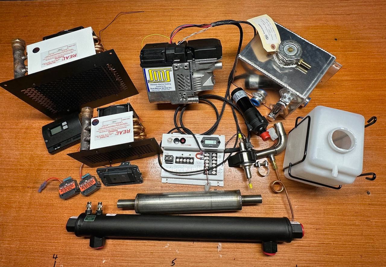

The parts and pieces, clockwise from the upper left: large fan unit, Webasto heater, expansion tank, ciruclation pump, exhaust drain fuel pump, expansion tank, overflow tank, muffler, heat exchanger, fan and heater switches, small fan unit, thermostat, and in the center is the SureWire panel where all the electrical connections are made.
A whole mess of stuff here. The black tube is the HX, the orange PEX on the left is the heater feed, the reddish hoses on the right go to the HW tank and then on to the rest of the system. The black hoses are from the engine.

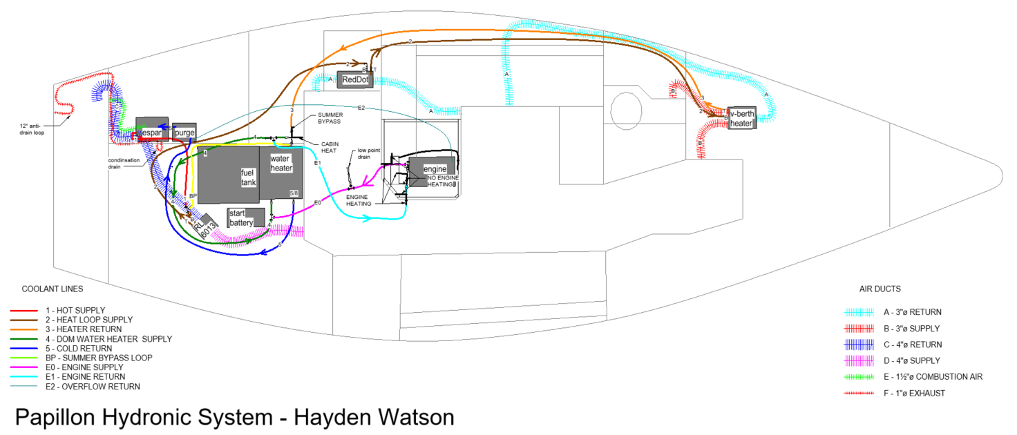

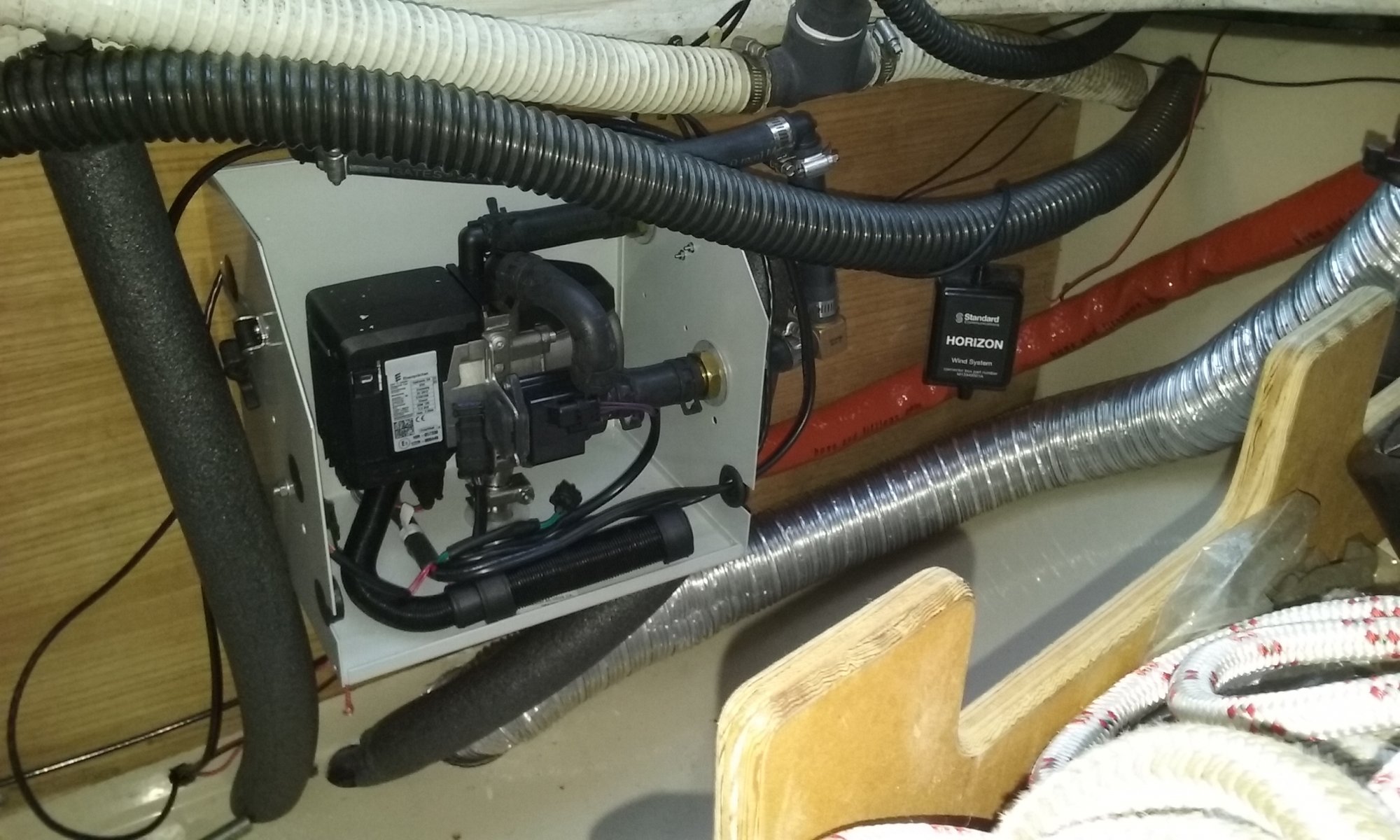

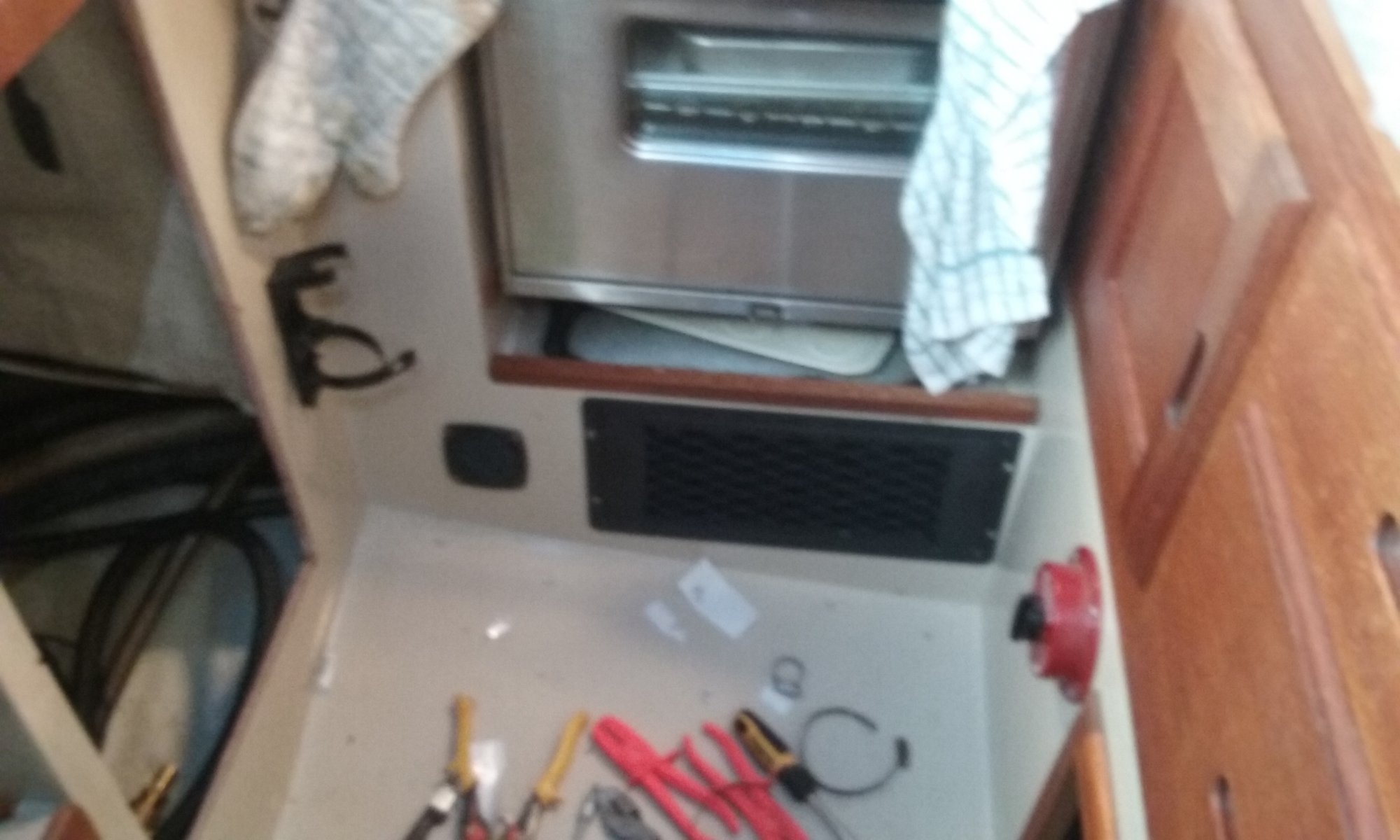

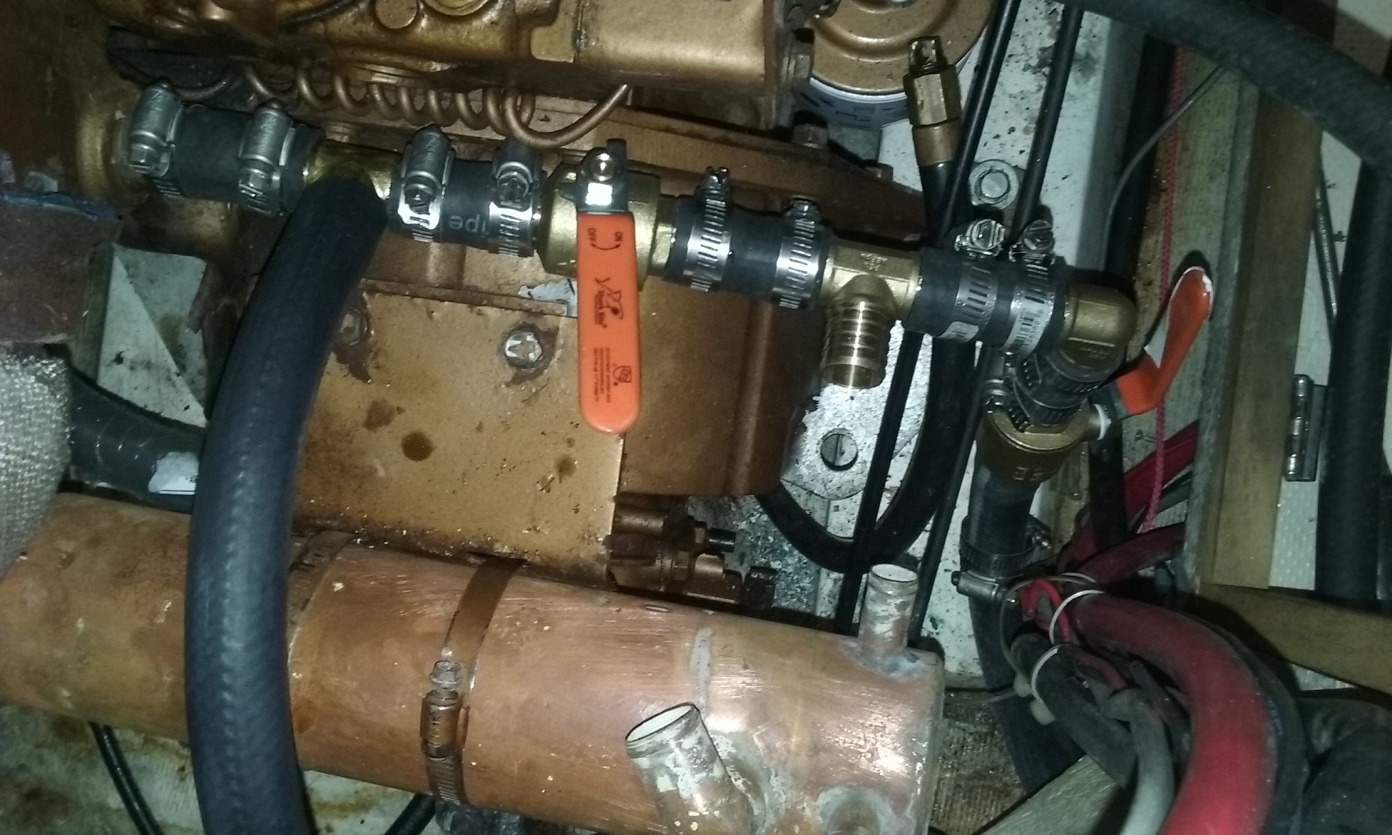

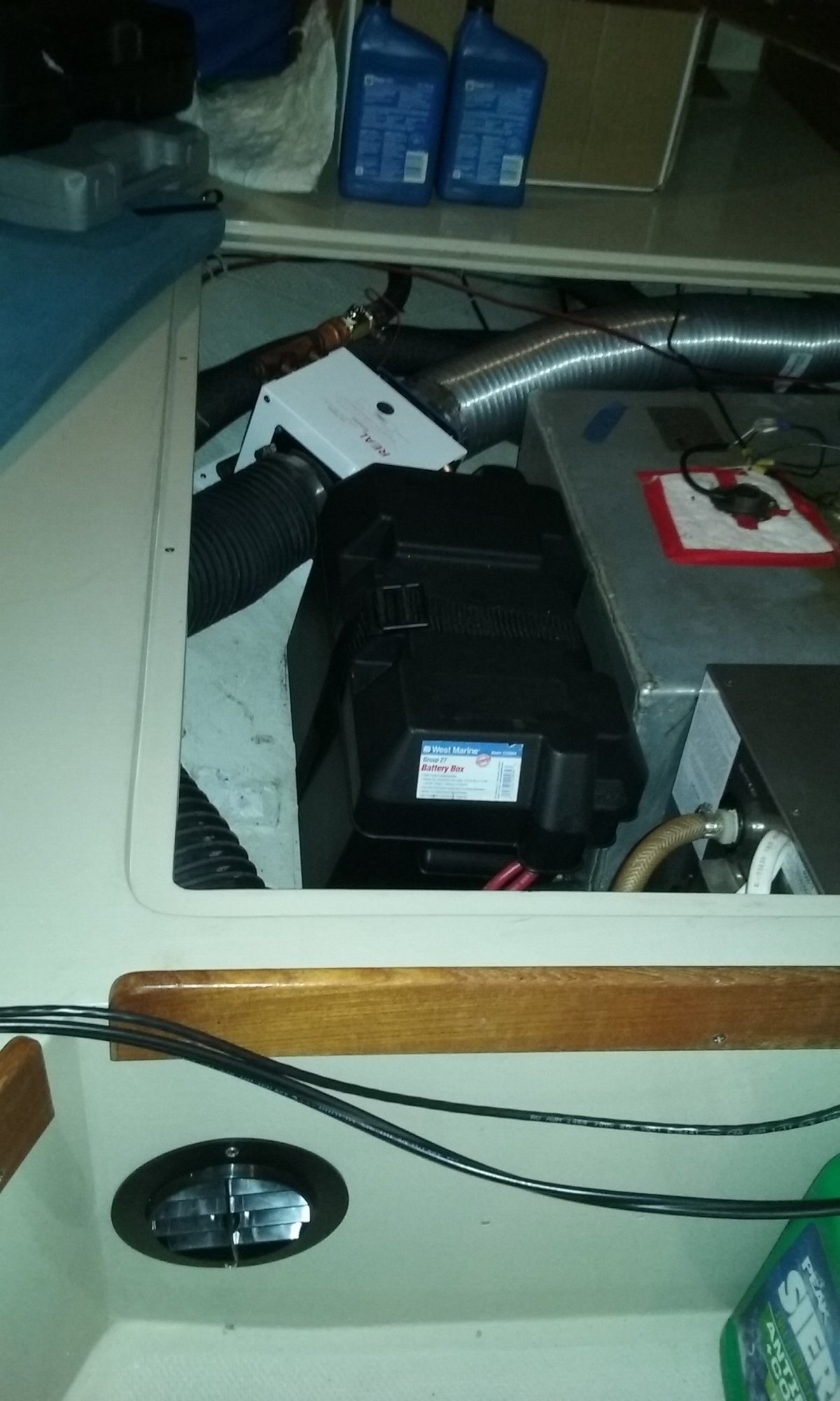

I built a hydronic system into my 1988 C30 Mk2 back in 2017 and it has performed fantastically. Mine also uses the Real fan coils that @dlochner has in his system but I used the Espar S3 D5E for my boiler. I upgraded all of the fans in the fan coils to PWM controlled case fan with much greater max airflow but with the ability to run slow and silent when I do not need that much heat. Here is a line drawing of my system.
