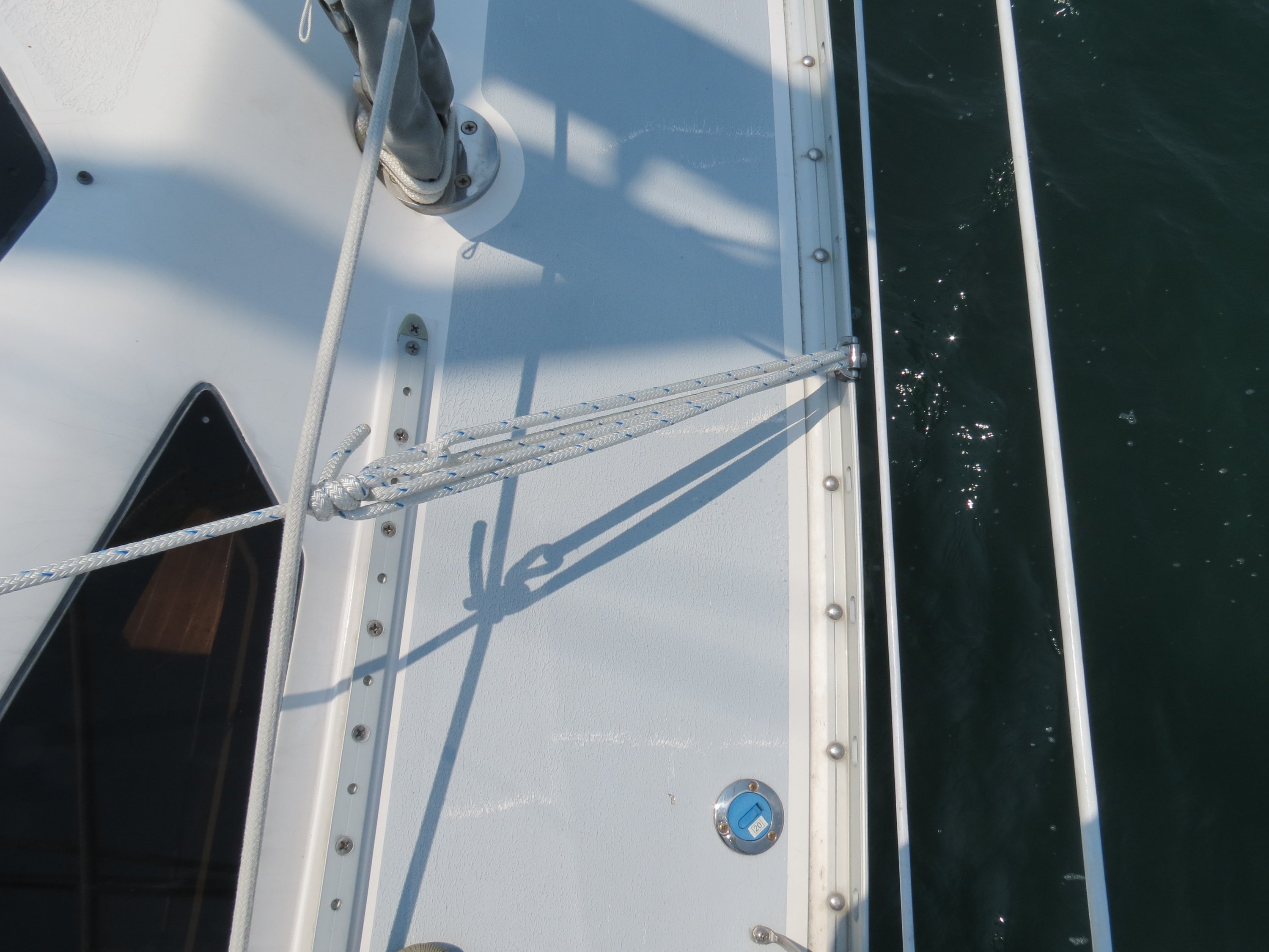

I feel your pain. My 1997 h40.5 has the same problem- see picture below. I don't really know if it is paint or gelcoat, but I would bet on gelcoat. I don't know what to do about it so I have done nothing. The picture has a couple of spots, but I have more on both sides. I suspect that if we got some matching gelcoat, it could be touched up. What I really don't know is if the repair would look worst than the present condition.

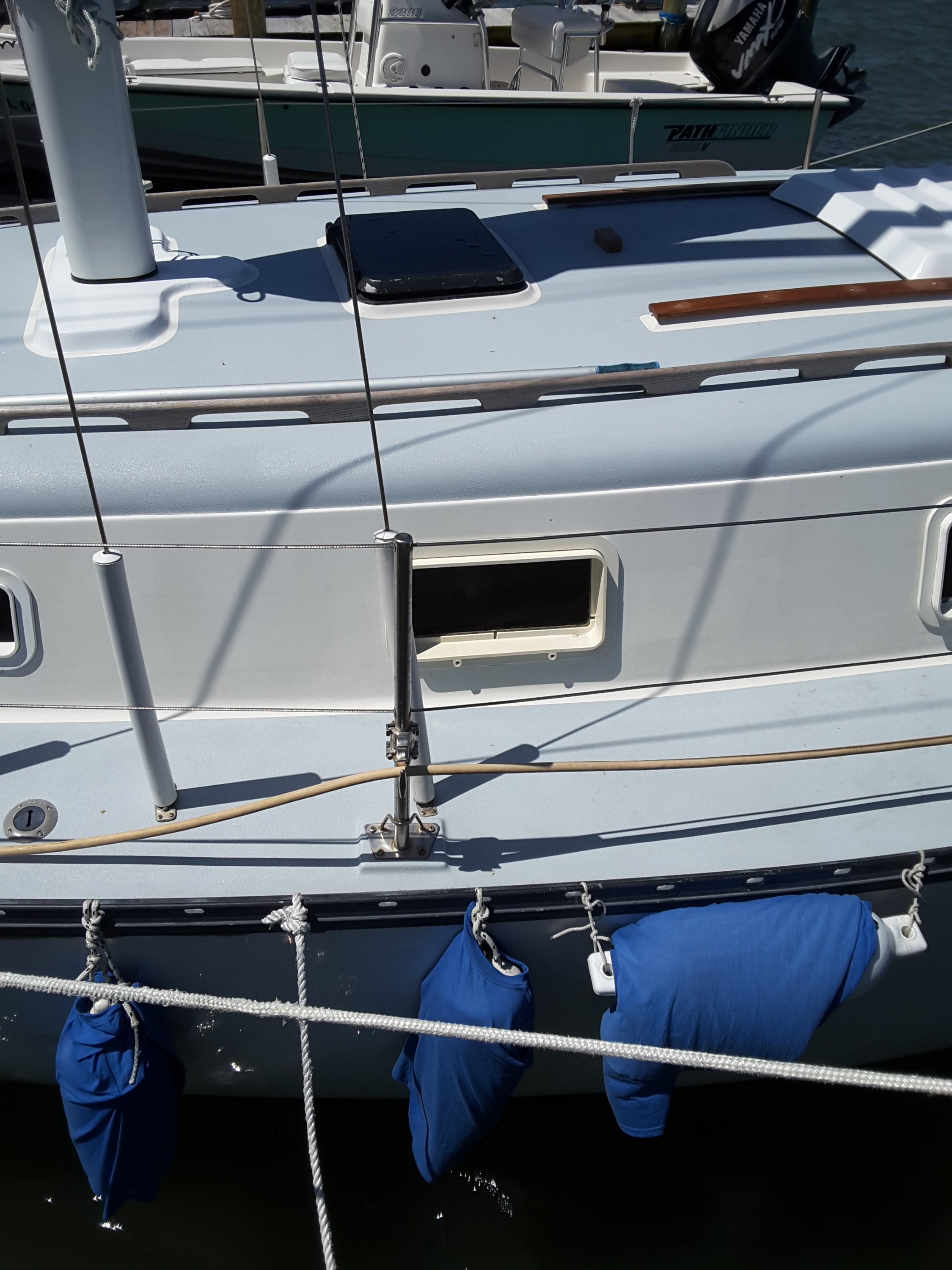

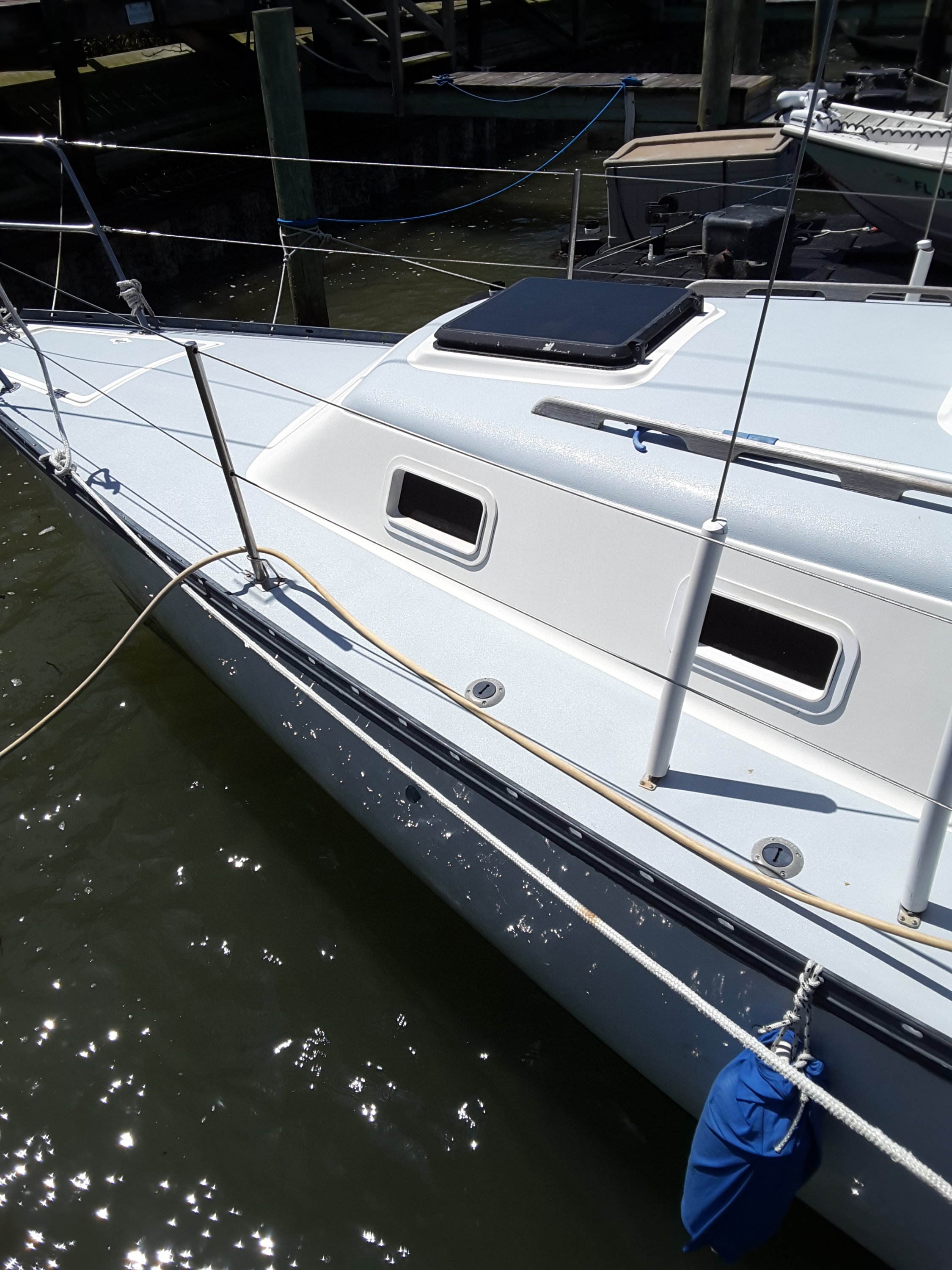

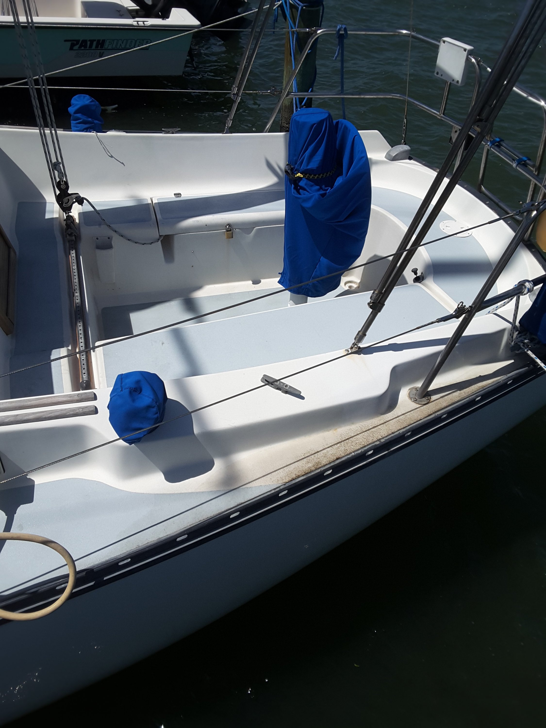

I painted my "grey" non-skid three years ago and it looks great in the Florida sunshine. I get a lot of "Looks Good" comments from dock walkers.
What paint did you use and how did you apply it? I'd love to see photos as we have a similar issue.
May 27, 2004
2,059
OK Guys, I didn't paint it myself so...
I'll call the yard tomorrow and get the specs on the paint. I didn't try to color match but I do know it was rolled on.
As to pics...
Weather here has been the pits but should be good Thursday and I'll take a couple of pics with my tablet.
Likes: VanIslandGuy

The yard guy called in today and told me he used Awlgrip 2000 Top Coat with Griptex additive on my non-skid.
