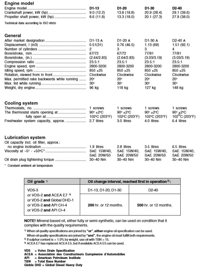

If its the original engine, it wont be a D-40 as they were first produced many years after 1990. More likely to be a VP2003.(is it 3 cylinder?)
My 32s5 has a 2002
