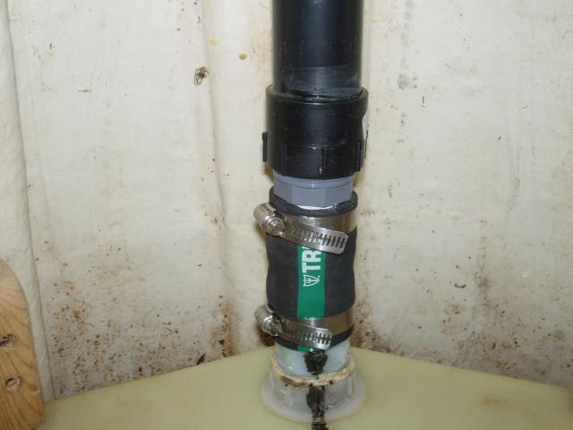

My new to me Ericson 28 has the stinkies. I plan to rip all of the sanitation hoses (including the vent hose) out and replace them with Trident 101 and to simplify the system. No need for overboard, "y" valves ect...
I haven't been able to decide whether the holding tank stinks too or whether the stink has "stuck" to the outside and can be scrubbed off. I haven't pulled the tank and hope not to if I don't need to. So...
Can a PE tank BE permeable?
Thanks all.

No, the HDPE plastic tanks are not permeable AFAIK. Wiping it down with bleach should fix it... The problem is the hoses. One easy way to confirm this is to take a rag or washcloth that has been soaked with very hot water and place it against the hose. Pull it away after a few minutes and sniff it. If it smells like sewage, then the hoses are permeated.

Any flexible hose will permeate eventually. If you can reduce the surface aera, it will permeate less. I use ABS pipes for longer runs and use couplings to Trident101 rubber hose to provide flexibility. ABS will never permeate even it is imersed in that stuff forever.
ABS can be bent with heat gun. Just don't brun it on one spot.

Nope...PE tanks don't permeate
However, unless you put plugs in the fittings of tank you've removed, odor from inside the tank can escape...something that has misled more than one person into believing the tank had permeated. A poster here a year or so ago had pulled his tank out and put in his garage...nothing could convince him that the odor in the garage wasn't due to a permeated tank.
But it's very possible that odor from your permeated hoses, from the "primordial soup" than can live in bilges etc has attached itself to the outside of the tank..and to every surface the hoses pass through.
So once you've gotten everything out, buy some PureAyre PureAyre ... Thoroughly clean your bilges and every area the hoses have passed through with detergent and water...let it all get dry....then put the PureAyre in a pump garden spray jug (MUCH easier to use than a trigger sprayer..the Roundup brand ones at Walmart cost about $15, but are really good quality) and "hose down" every surface, nook and cranny AND the outside of the tank. Don't rinse....just let it dry. And if you're in a mood to get rid of most of your closed-up-all-winter odors too, spray all your life jackets, foulies, cushions and other soft goods and put 'em all out in the sun to dry all day.
Now you're ready to re-install your system. Use Trident #148 for your head intake line and vent line if it's smaller than 1".
It's not necessarily true that all flexible hoses eventually permeate.... That used to be true, and most still do, but not all. Trident 101/102 have been on the market for more than 15 years without a single reported odor permeation failure...and Shields has just introduced a new hose--their Poly X--that they put a lifetime warranty on--and for their price/ft, it better last that long!

Guess what I did on Sunday? My nose hairs are all gone, my lungs are permanently polluted and the EPA is searching for who ever caused the green cloud of toxic gas over eastern CT. Yup..I removed all of the old hoses, Gusher overboard pump and holding tank. Go figure, the tank wasn't pumped out nearly as far as it could have been and not rinsed. I did the initial cleaning of the area it was removed from with Citrus Boat Wash and let it sit. I couldn't rinse anyway 'cause the marina water isn't on yet. Hell of a tiring and stinky job. Mucch more scrubbing to come. I did buy a gallon of PureAyre and am gonna need it.
Well after getting the tank home (that's another thread all together) is emptied the disgusting contents into a bucket and accessed the situation. What a mess. I don't think permeable is the issue here. This tank stinks so badly with so much build up I'm thinking there is no hope. It would take gallons of wash water (from my power washer maybe) and I think it would still stink. What would I do with that wash water anyway? 50' down wind from this bomb is unbearable. Reminds me of Jim Carey..."wheeeeew, do NOT go in there!"
