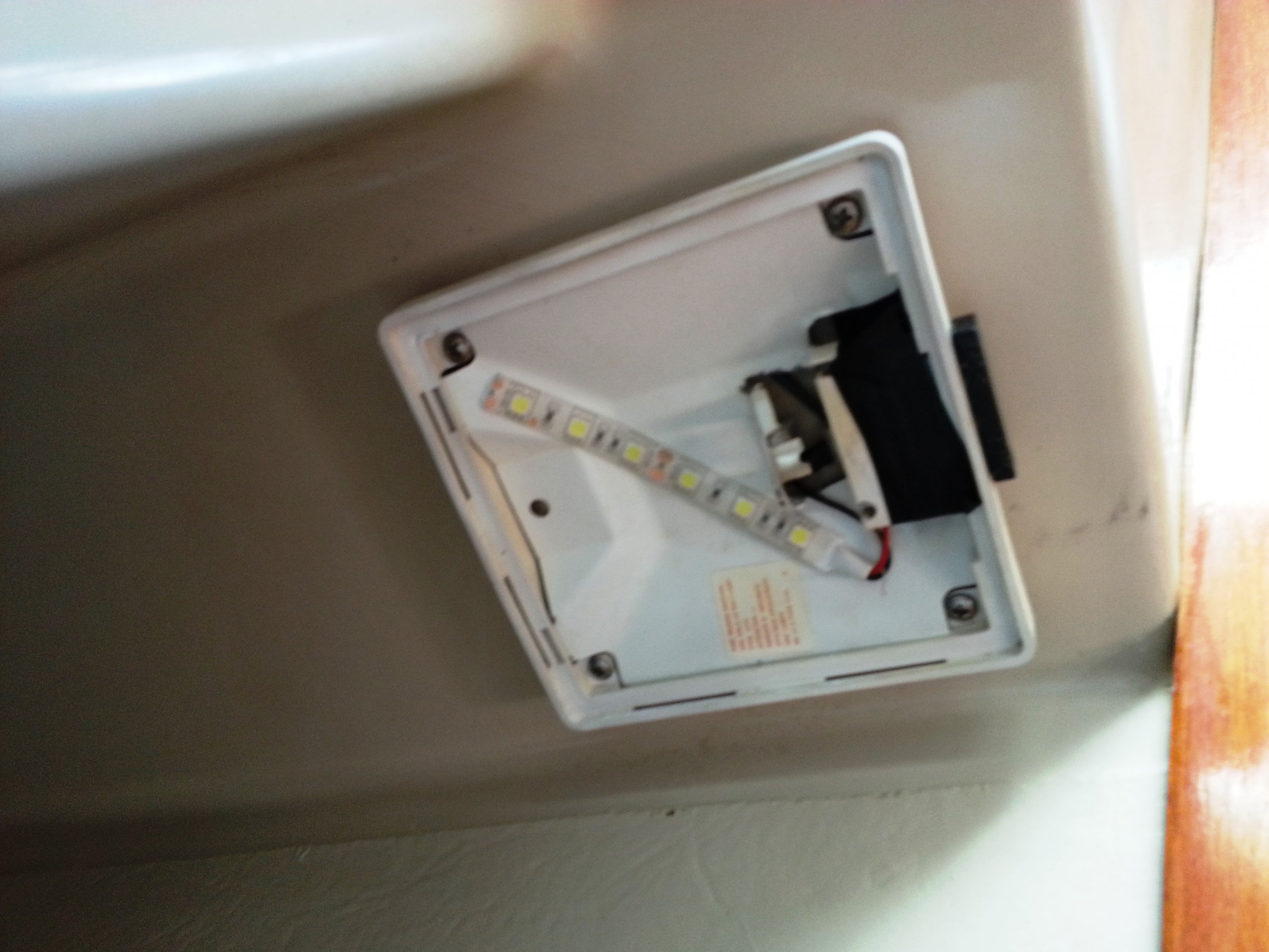

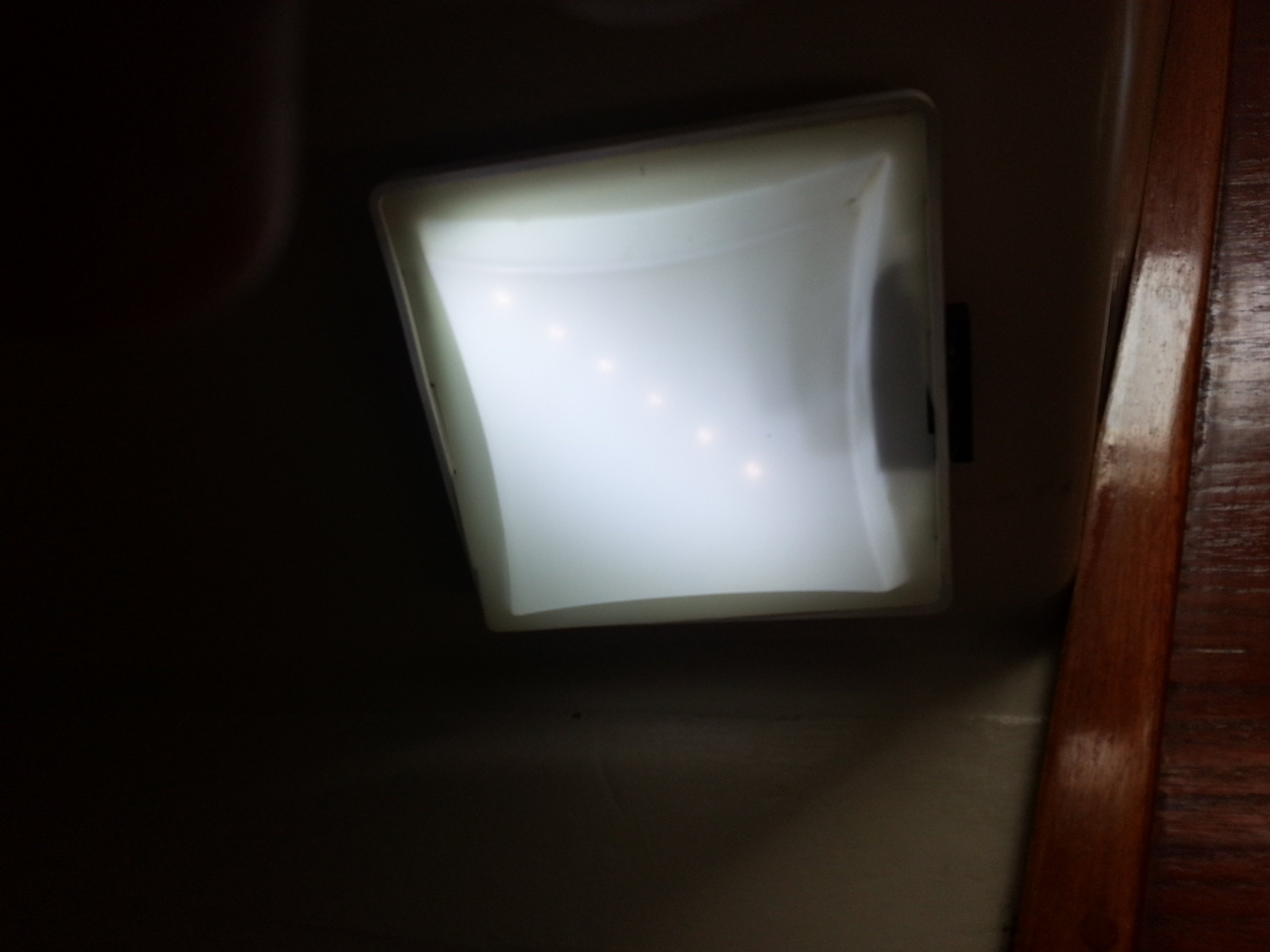

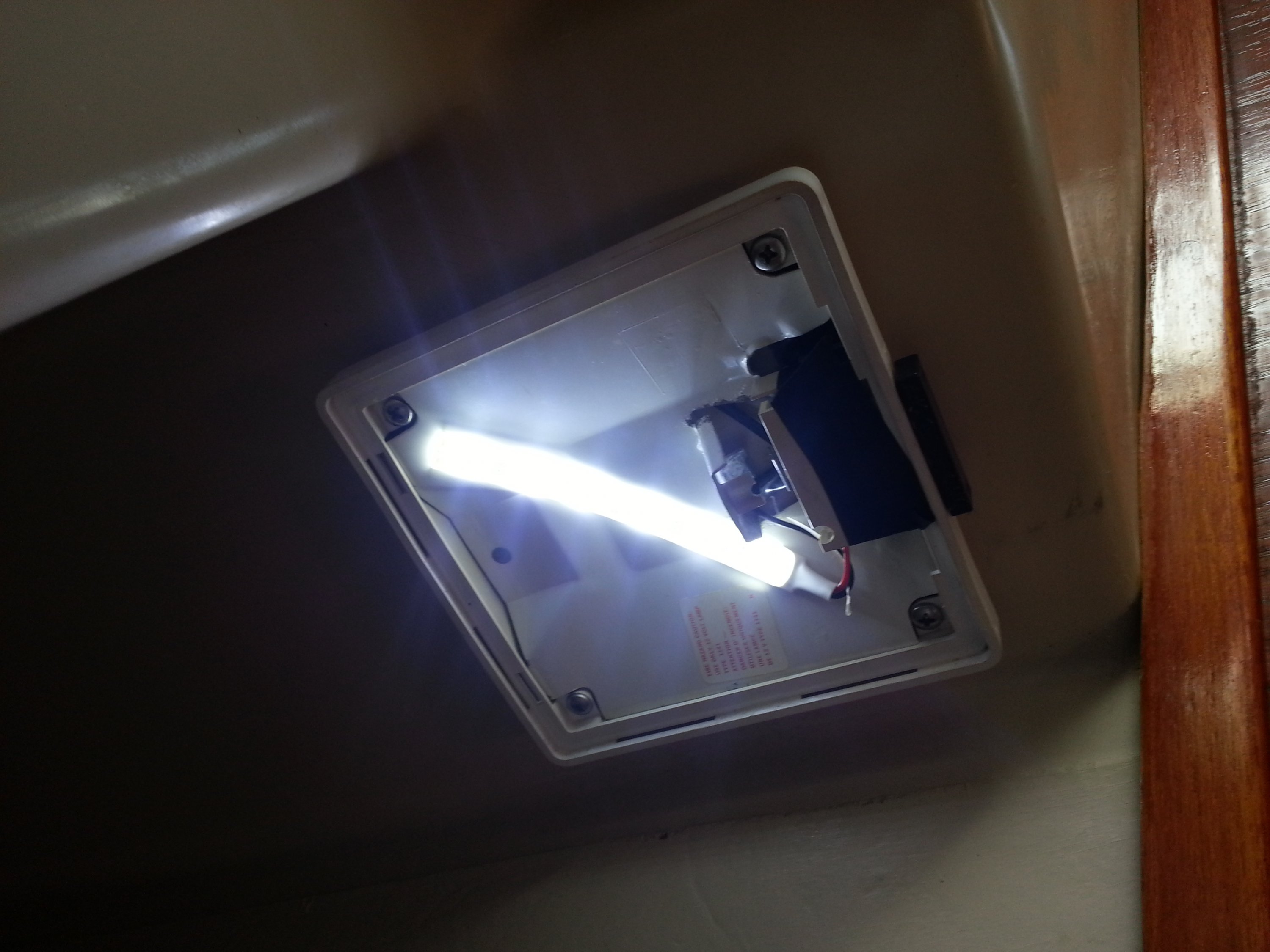

I went the the cheap way. I removed the light fixture, then bought a big roll of LED lights from amazon. Cut into small strips and soldiered them to a wire and then soldiered them to the connections on the back of the fixture.
