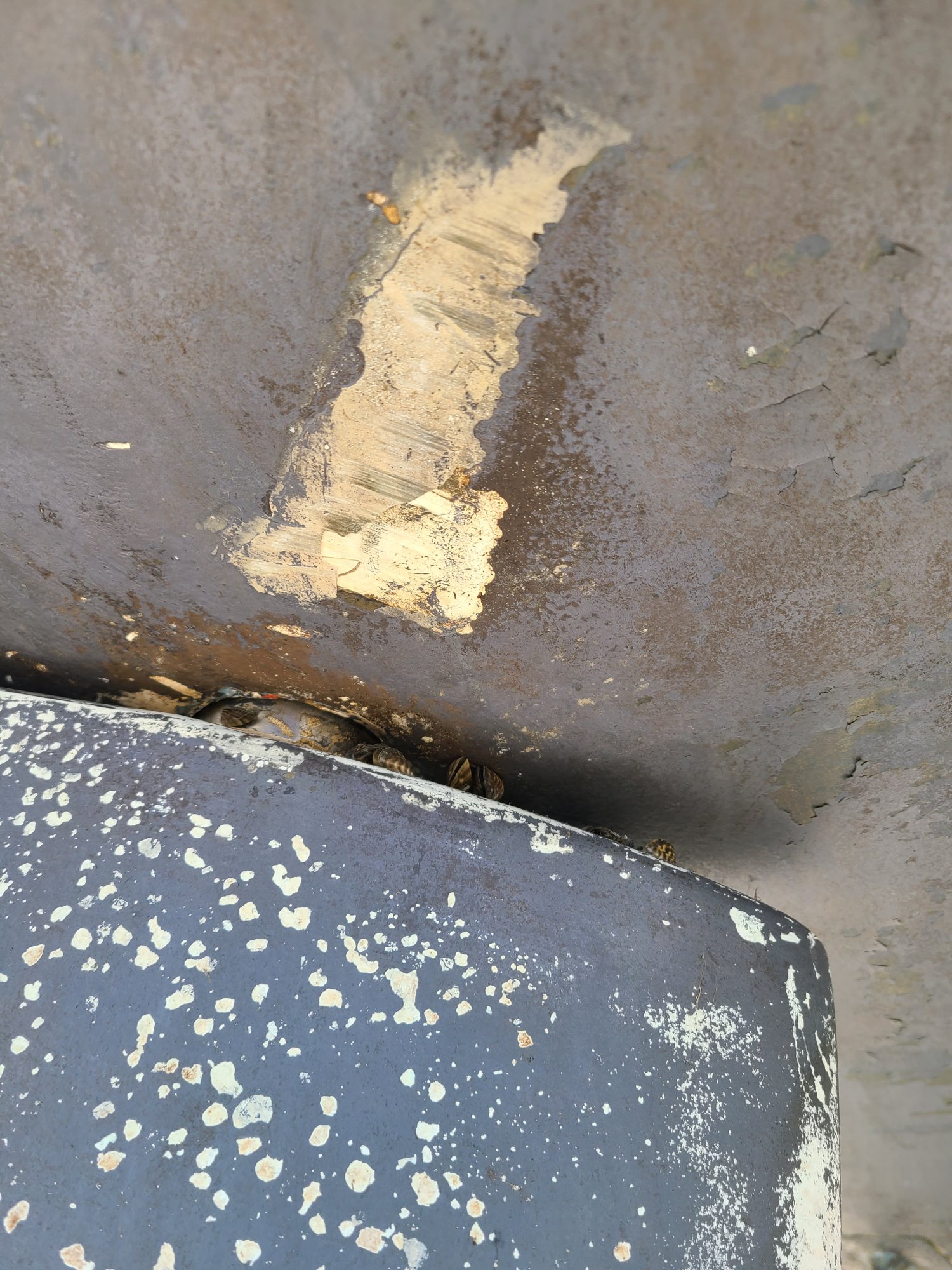

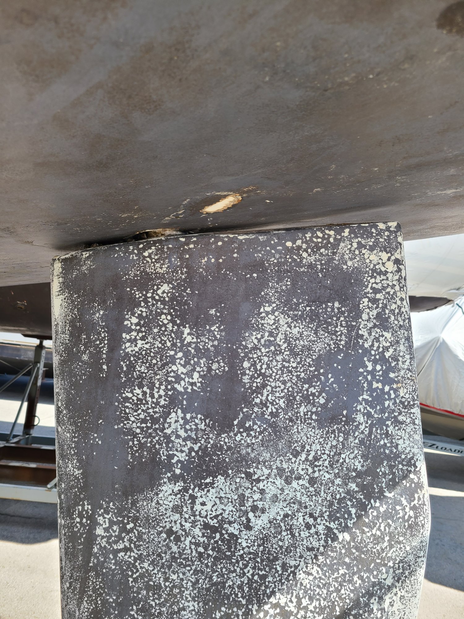

I recently noticed that the rudder touches the hull on both sides when it's turned either to the far right or far left. It bottoms out on both sides scraping the hull which now requires repair and paint. I don't know much about rudders or the steering mechanisms of these boats....any advise as to where I should start?

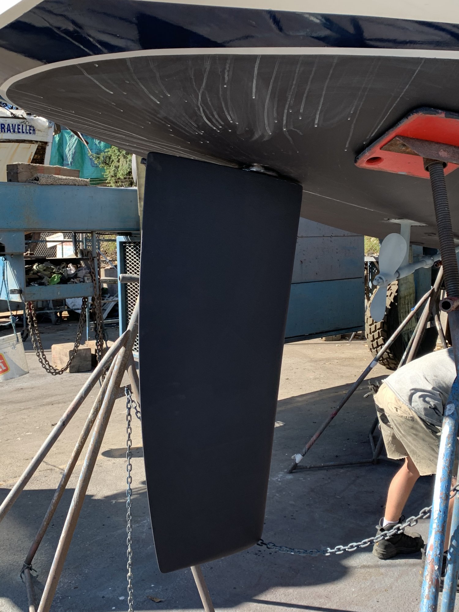

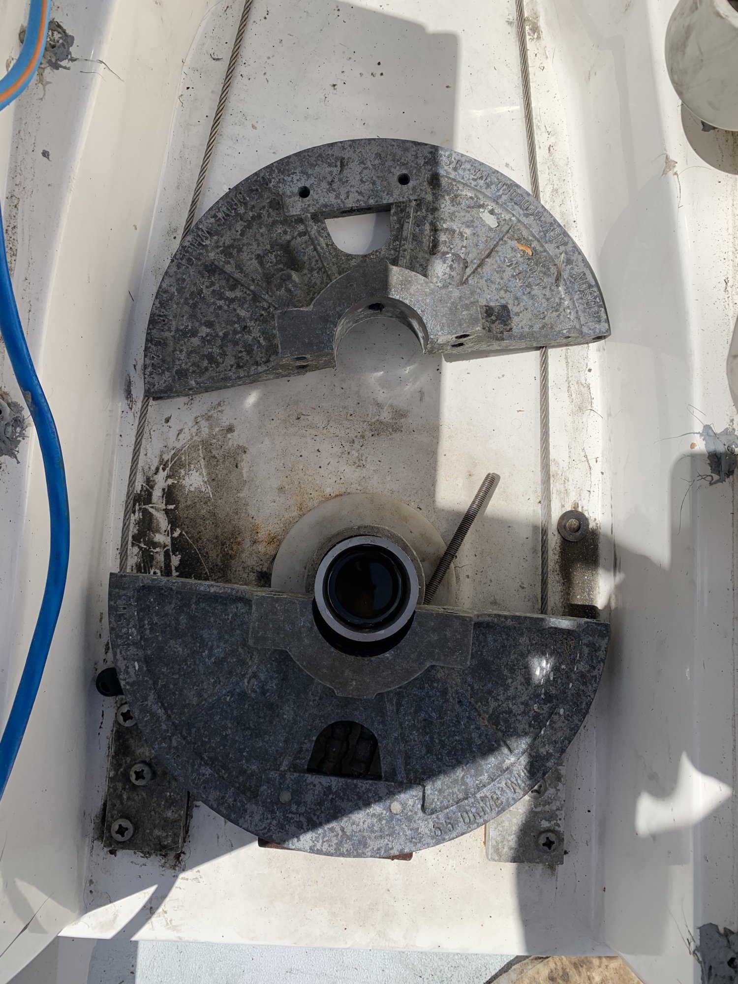

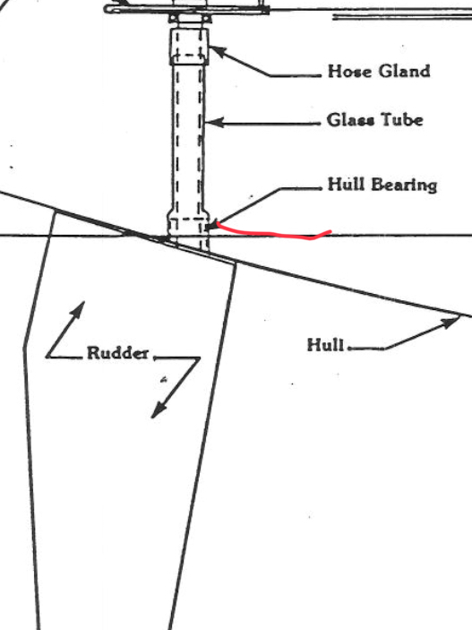

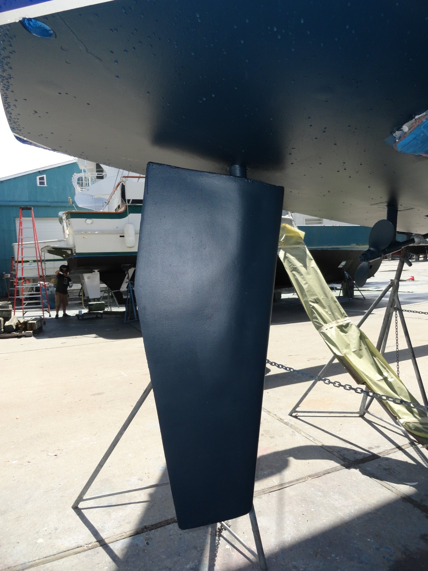

Here is what my H31 (‘83) rudder looks like. As well as a drawing of the rudder assembly it may be that the rudder is just too snug against the hull. A forum member JMCE1587 lost his rudder on his H31 and would know more about it. However I am pretty sure that the depth of your rudder is adjustable.

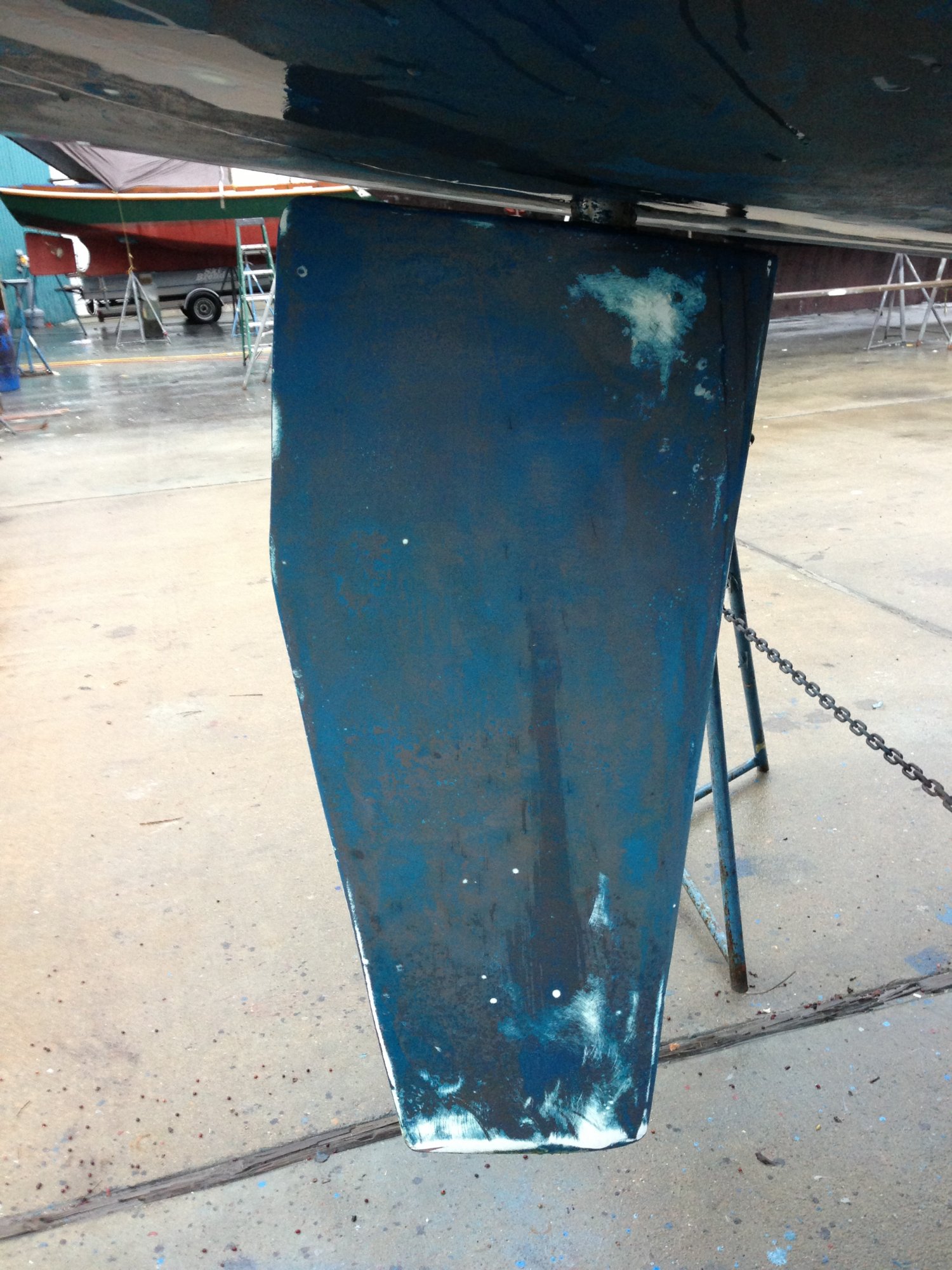

Here is a picture of JMCE1587’s newly installed rudder.

The rudder post on my 33.5 is held to the radial drive wheel with a 5/8" bolt that passes through the rudder post stock and through a machined hole in drive wheel. The rudder bushing will cause side to side movement if worn but the bolt prevents the post from moving up or down. The area that is rubbing is within the range of motion of the rudder before it gets to the stop. My guess is that either the rudder is swollen from water intrusion or there was a previous repair that wasn't done properly. Seems like the solution may involve dropping the rudder. Not a fun task.

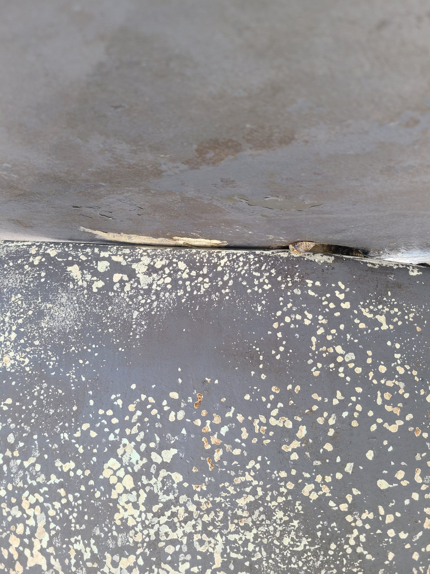

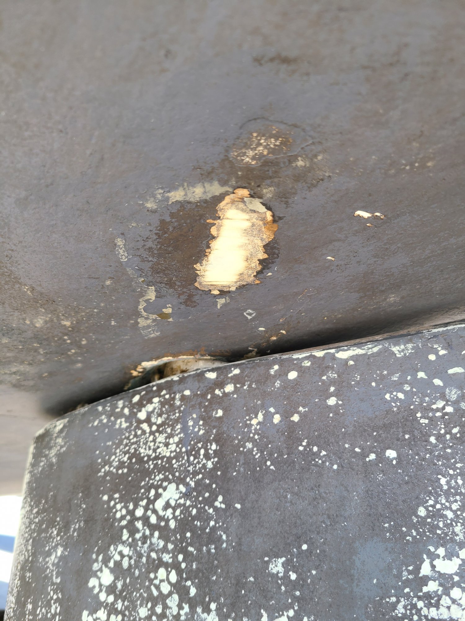

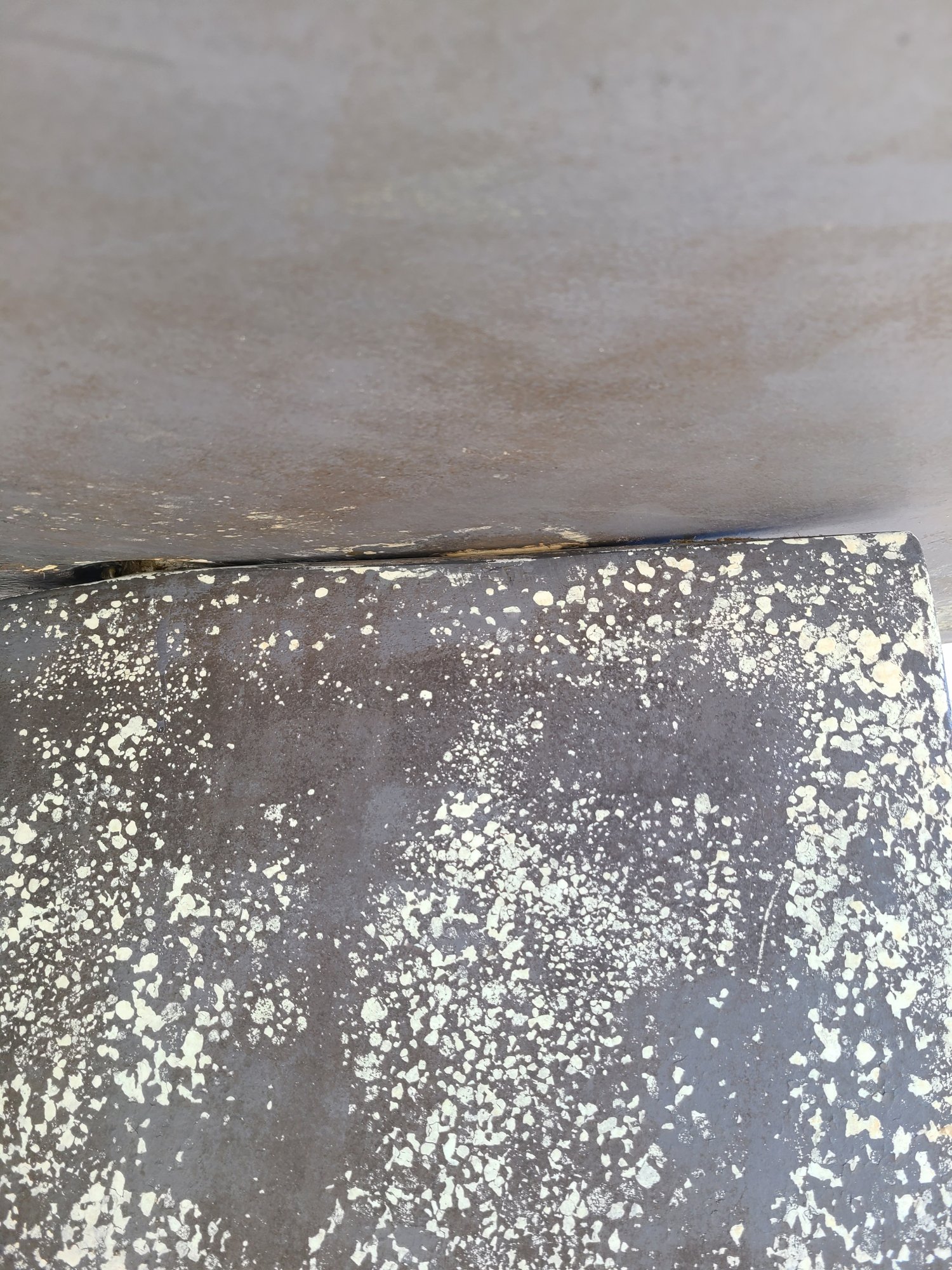

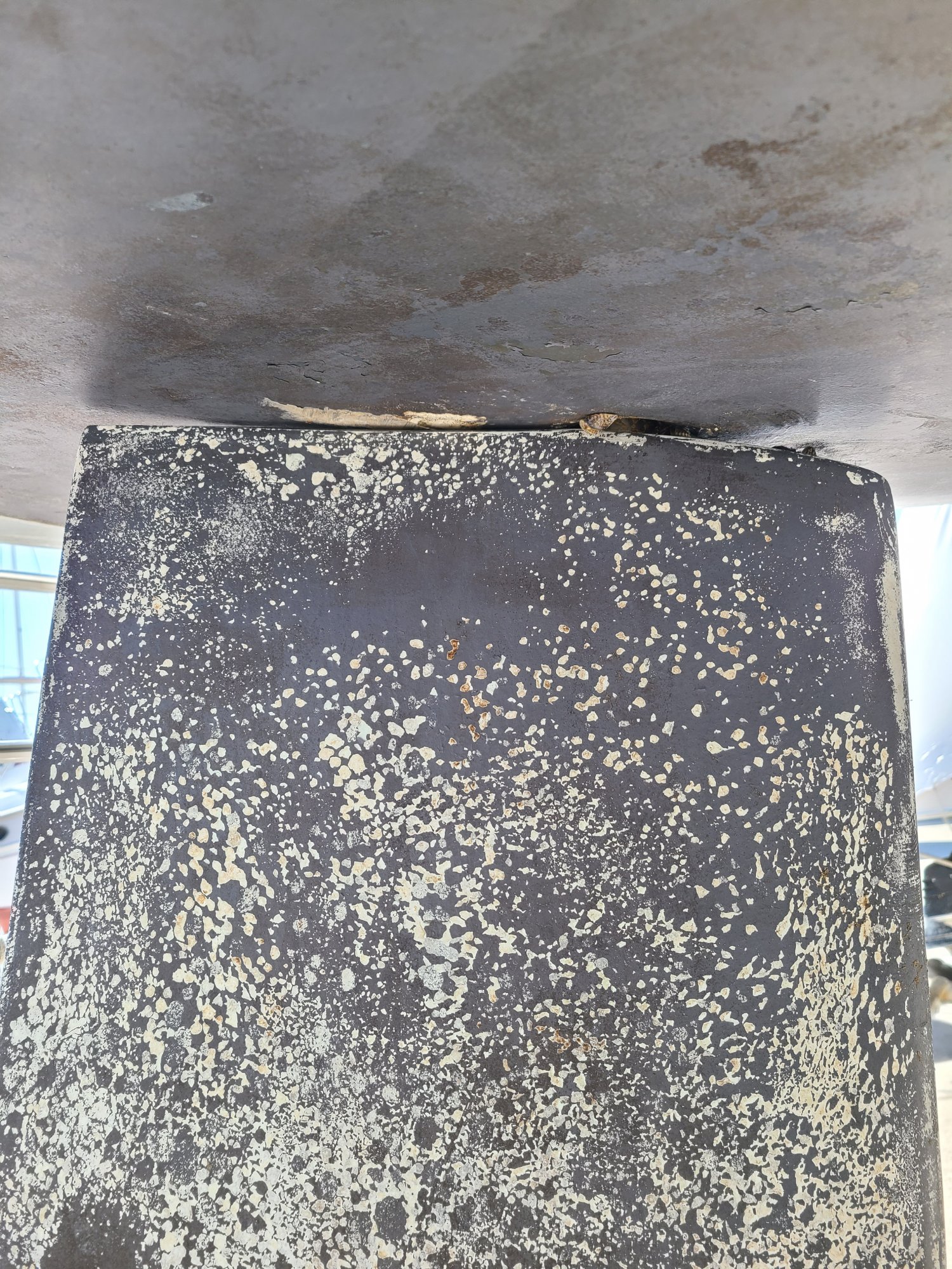

I bought a ‘89 Hunter 30 with a damaged rudder last year and replaced the rudder last summer. The setup is the same as the sketch above, but has a Teflon disc between the rudder and hull and another under the radial drive wheel. Can it be that someone dropped the rudder in the past and placed both discs under the drive wheel lifting the rudder up? If your boat has the aluminum radial drive wheel with stainless steel bolts, I suggest working on the bolts to ensure they are free before getting to the yard. Took many heating and cooling cycles over 2 weeks to get the through bolt loose
