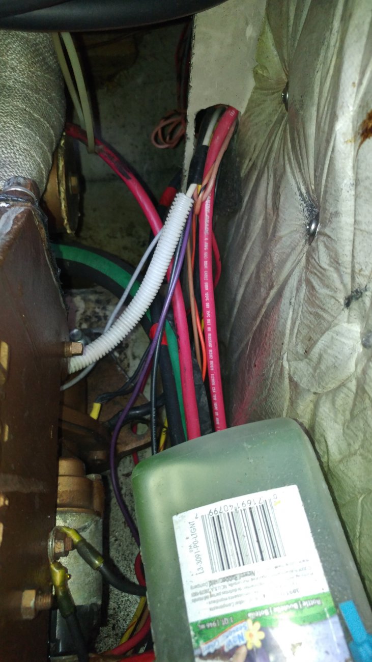

Wiring harness looks like it was replaced, found info from first owner about it and saw no evidence in engine and the cockpit.

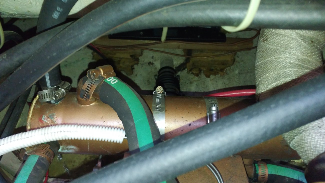

Water leak at starboard side bottom of heat exchanger, pretty good flow at seam. Not sure if there is a rebuild kit for this and it looks lime this is the original heat exchanger

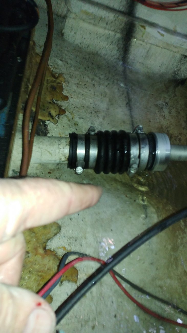

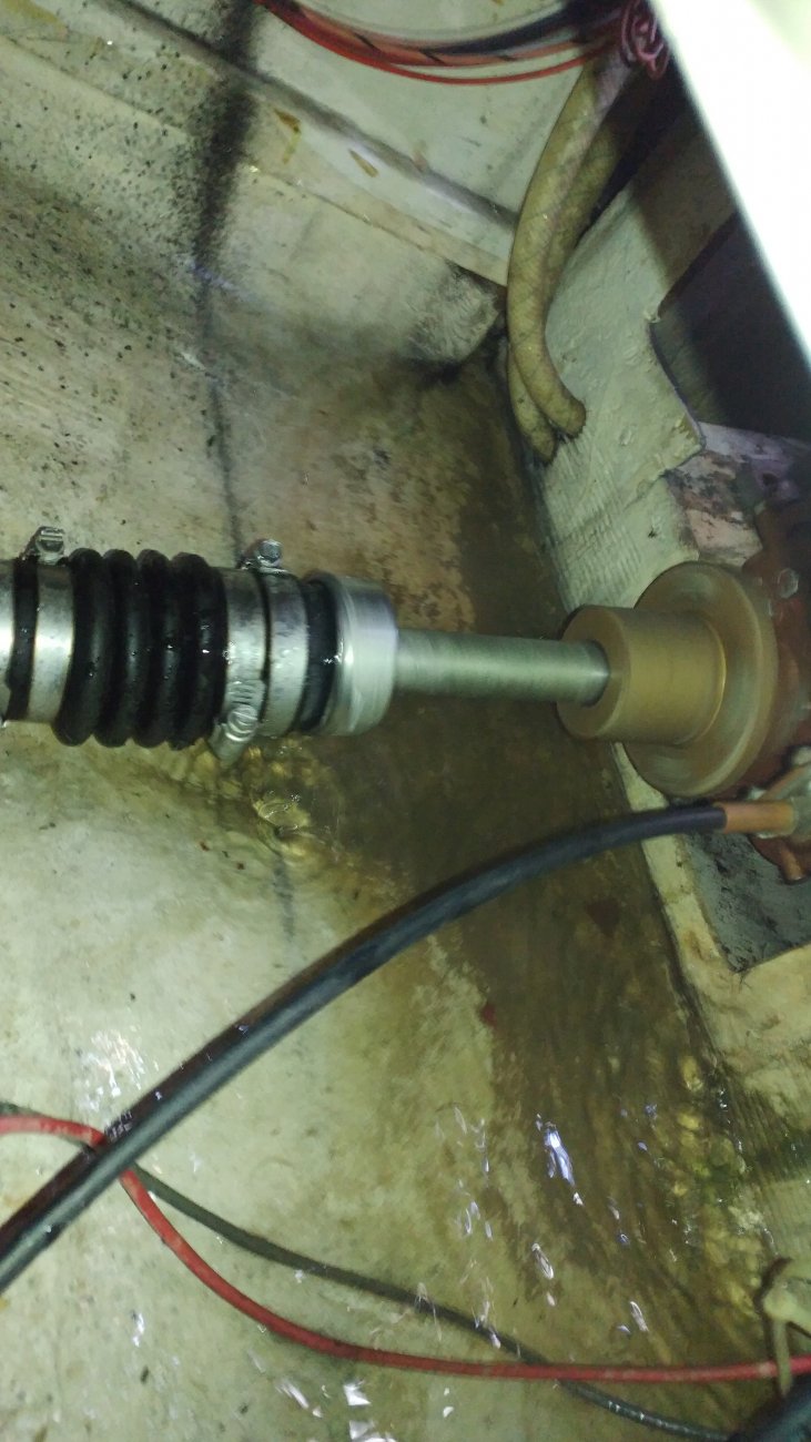

The stuffing box looks new but flings water while running, broker, who sells nee Beneteau and runs a repair yard, isn't sure this is correct and recommends it be looked at.

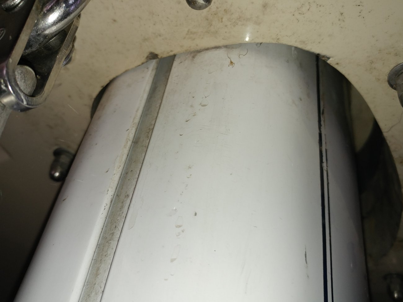

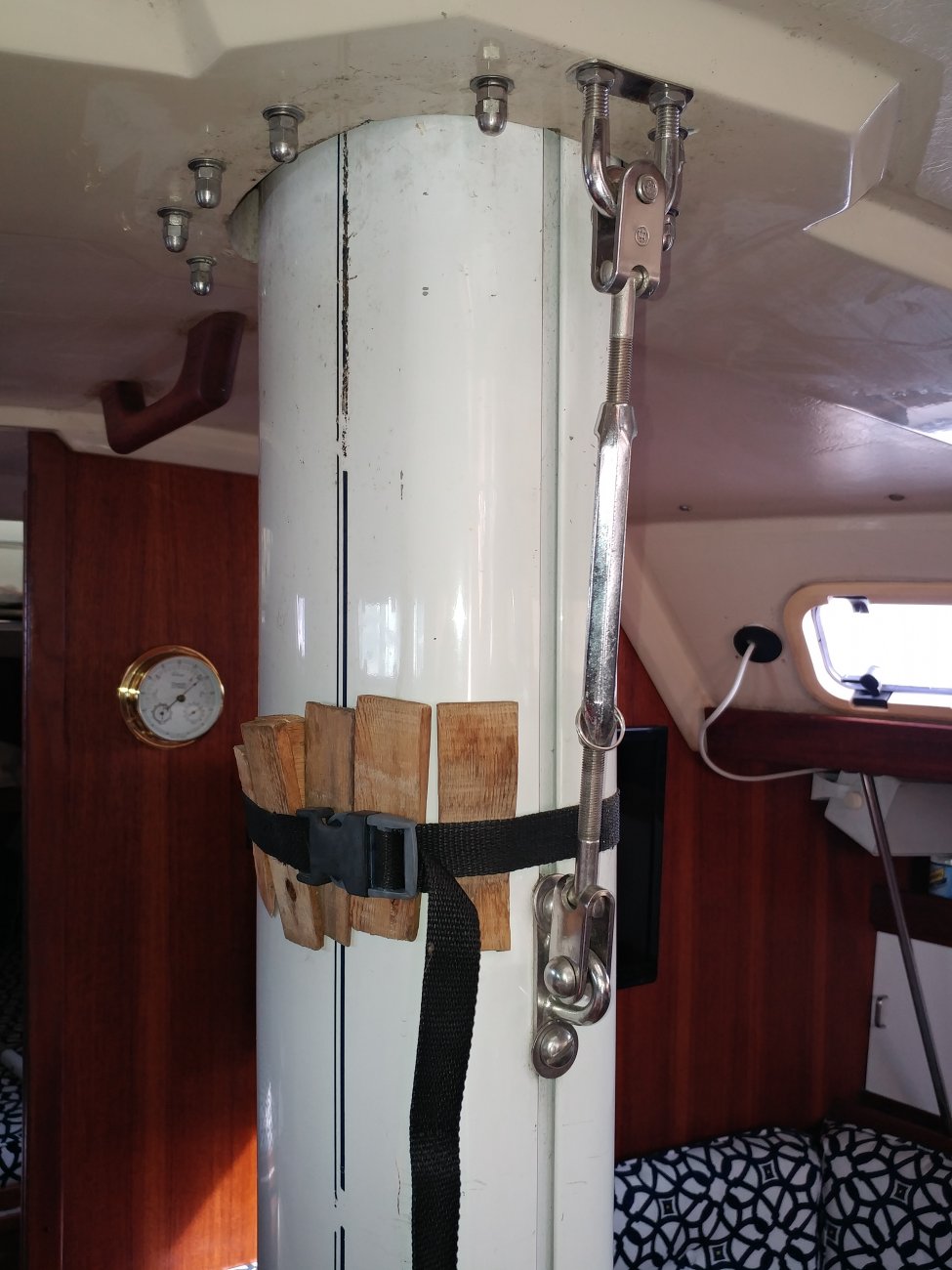

Mast seems to be aft in the hole in the cabin, not centered. Standing rigging looked fine and all of the turnbuckles were pretty centered, so not over tighten or loose.

What you’re calling a stuffing box is actually a shaft seal, and should be an easy fix with either a new bellows or an adjustment. Unless the seal ring got (somehow) something sucked into it and got scratched. If there’s air in the tube, it’s going to leak. The picture doesn’t show a breather tube?

Early ones didn’t have a breather tube. Agree with Meriachee, shouldn’t be a big deal to fix. Do a search on a PSS shaft seal or check there web site. Might something as easy as adjusting the bellows. Most recommend putting a split lock ring on the shaft to. Keep the seal from sliding back. Not a show stopper.
The HX exchanger end plates easily come off. You can get new end gaskets from Catalina Direct. Not a big deal if in fact that’s where the leak is. Not a show stopper.

HX - just buy a new one. Sendure or Seakamp $300
Heat Exchangers 101: Sources for replacement Good Guys at Sendure
http://c34.org/bbs/index.php/topic,6920.0.html
Stuffing Box - there's an entire section in the wiki, repack it, 1/2 hour job, $30 if you have to buy new packing.
Repacking a Stuffing Box 101 - by Maine Sail: http://forums.catalina.sailboatowners.com/showthread.php?p=775788&highlight=stuffing box There are also lots of articles in the C34 Tech wiki. http://www.c34.org/wiki/index.php?title=Stuffing_box
Mast - check if there are wooden wedges up there, if not, get some, soft pine, $20 Google "centering mast in the partners"

The critical issues stuffing box (really a PSS shaft seal) and the heat exchanger are the ones that can sink the boat. These need maintenance or replacement.
The PSS shaft seal requires a haul by the yard. Here is a link to PYI the maker of the PSS shaft seal. https://www.shaftseal.com/pss-type-a-seal.html
Then the heat exchanger is covered by Stu’s link.

Thanks all. Agree it looks good, @Stu Jackson there were wood wedges on the mast, not installed, but strapped to it below the turnbuckle.

The pss has gone through a number of revisions. As far as a sailboat is concerned, there are essentially three revisions; the first has no breather tube. The second has a nylon breather nipple, and the third has a stainless nipple.
You cannot retrofit.
The forensic audit department would conclude that the black lines at 90degrees from the ring would suggest that there’s been wear on the carbon ring. That happens for one of three reasons, the thing is new, it was run dry, or something got in there and scored it.
I’d bet it was run dry. With no breather tube, any air in there can’t escape, and you HAVE to have water in there.
If you buy this boat, buy a whole new pss, and a retention collar. Easy to install, and come back in 5-8 years and discuss it.

A few comments with regard to the PSS shaft seal:
First, if it's been in there a long time, what happens is the bellows looses it's elasticity and doesn't put as much pressure on the carbon ring. Solution is to loosen the set screws on the ring and slide it back a few more millimeters. This will result in less water splash. If still not enough, move it back a tad more. It's okay to have a few drops come out because that means everything is lubricated. The heat in the engine room will evaporate the little bit that does come out. If it is always bone dry, then there could be too much pressure and too much wear. One could put an absorbent towel under it to retain the occasional drip.
Second, for a safety ring, just use a zinc.
Third, since there is no bleed capability, when launching the boat just move the bellows back until there is a squirt of water. This means there is water in the bellows and enough to lube the ring. No big deal, no need to buy a new one just for the bleed thingies.
Otherwise, the PSS shaft seal is a nice optional item to have.

I had a Catalina 30 for ten years- looks like the same engine. It is actually a Kubota D-950 diesel. There are parts manuals on-line. You can get engine parts at any local Kubota dealer if you have the Kubota part numbers. Agree on buying a new heat exchanger. Probably 30 min to change out.
