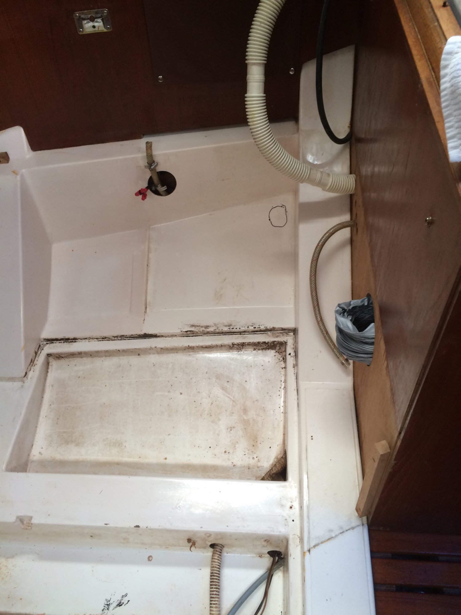

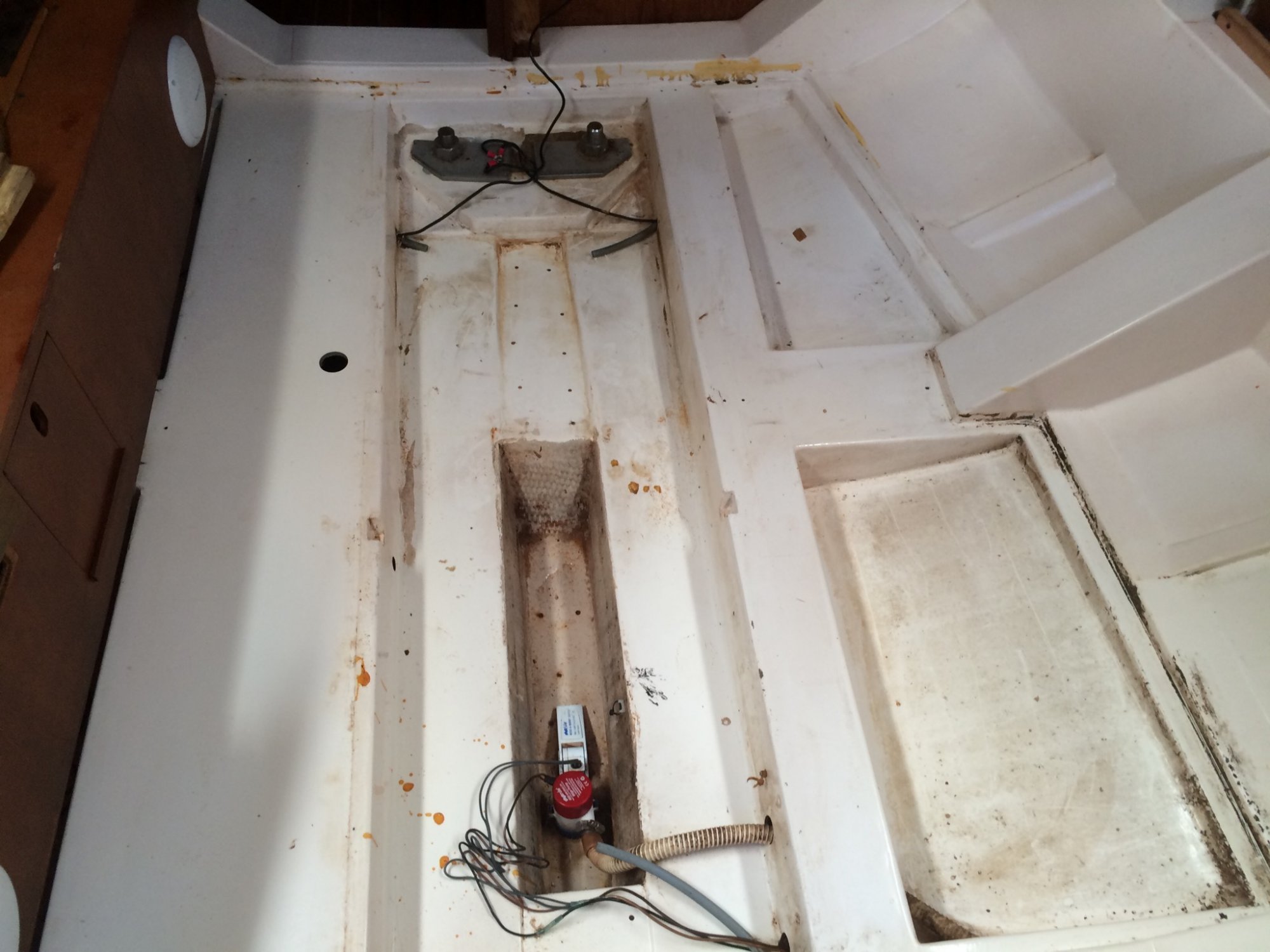

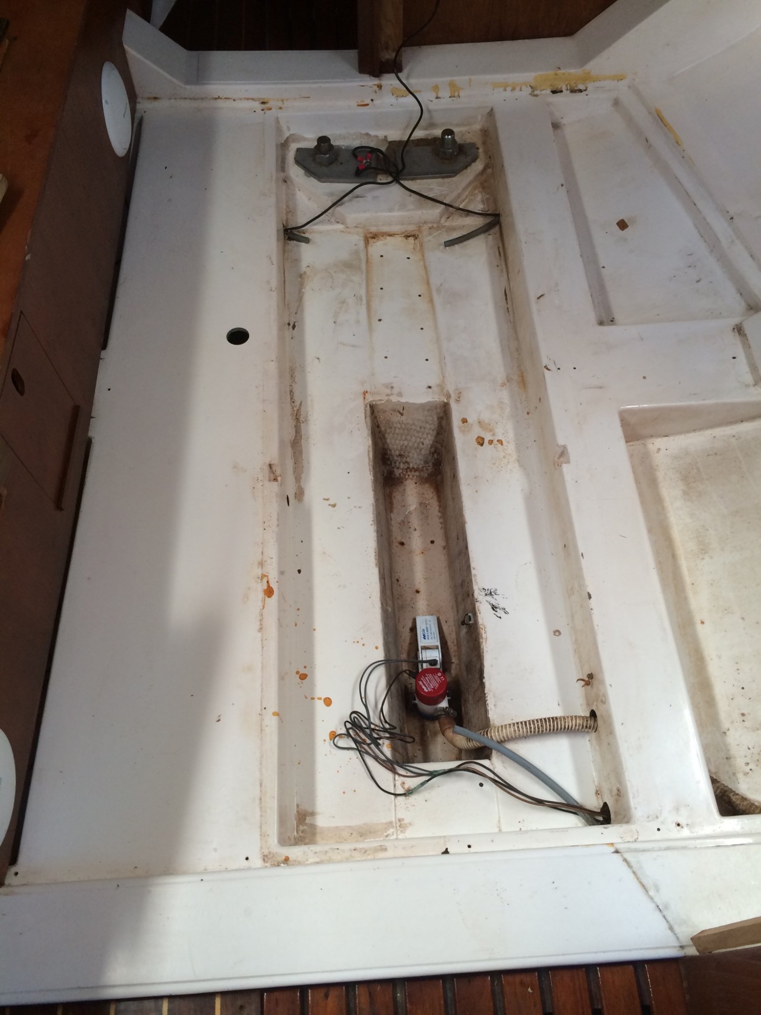

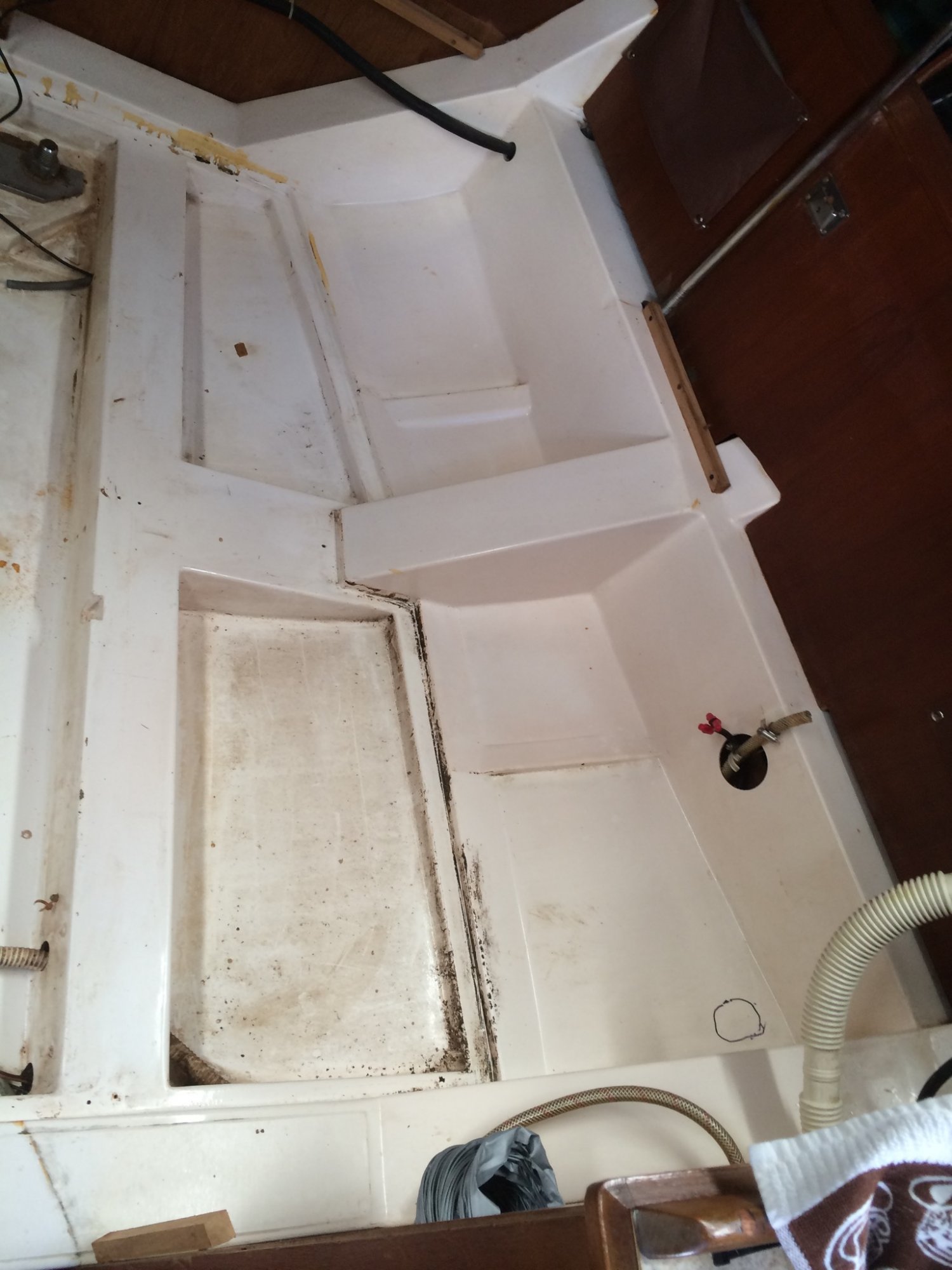

Thanks everyone for your responses. I think I'll first try the Marine-Tex and see if I can get a temporary fix. If I can stop the leak long enough from the inside to get the hole area dry I can come back with something a little more robust. I'll let you know how it goes.

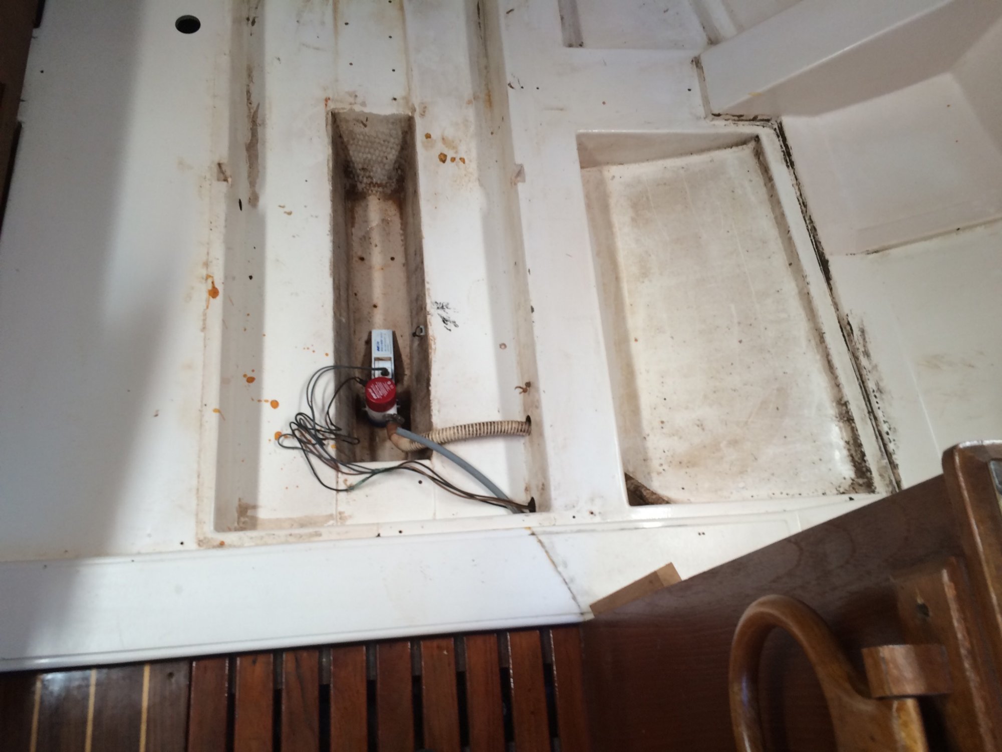

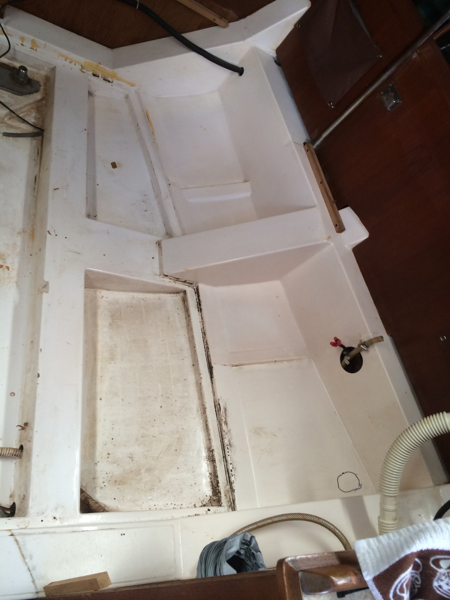

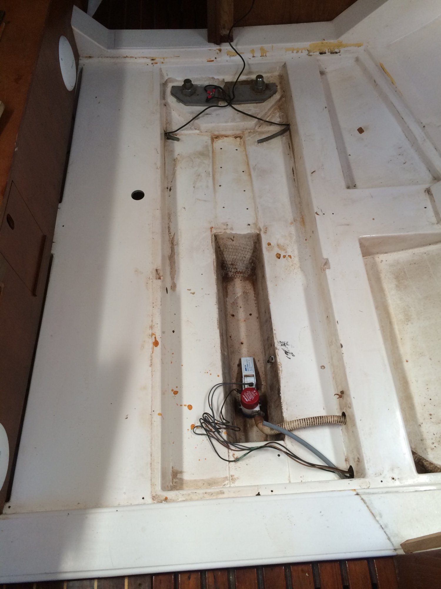

Follow-up: I pulled the boat to have the leak fixed. Good thing because I had some issues going on with what appears to be water seepage by the keel where the bilge portion of the hull joins with the keel. The paint was peeling off. Apparently there is an internal gap between the interior of the hull and the liner in the bilge area. The yard thinks that water may have been leaking for sometime and sitting in this void area. Has any one had an experience like this? I'm thinking of putting an watertight inspection port (like 3" diameter) in the bottom of my bilge for periodic inspections and/or drainage of the space.
