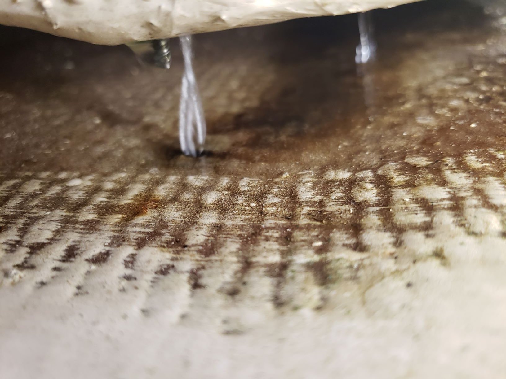

Well, I found my leak this morning. See picture attached. It's up in the bow area under the v-birth floor. The hole appears to be less than an 1/8". The stream of water in the pictures is squirting up hitting the underside of the v-birth floor. What appears to be a second stream of water in the background is actually water running/dripping from the underside of the v-birth floor. I'm wondering if I can do a temporary fix from inside for now and make a permanent fix later the next time I pull the boat. I have minimal access. I can somewhat reach it with my hand using a mirror. I may be able to rub some type of putty in the hole. I wont be able to do any real prep work or get tools is the area. The temporary repair will have to be a wet repair. What recommendations for product can I use?

Unusual leak.
Perhaps you or a prior owner hit something. (Those models were laid up kind of thin.)
If you can get a hand at least partially over the hole perhaps you could press some sort of specialty sealant into it. First run a small plastic tarp with lines on each corner under the front of the boat and back until the leak slows a lot.
Plan on a haul out and a bit of grinding back and glassing from the outside. If you use poly resin, you might get 'er done in one long day.
10,116
Looks like a drilled hole! Ouch.. Mask and fins.. sail a bit out to clearer water out of the marina and put a screw in from the outside; some underwater epoxy on it and a rubber washer on the screw.. or get a diver to do it.. That would hold ya for a long time.

I am thinking that when the hole was drilled for the little bolt (visible just left of where the leak hits the floor), the drill went a bit too far.. ?
