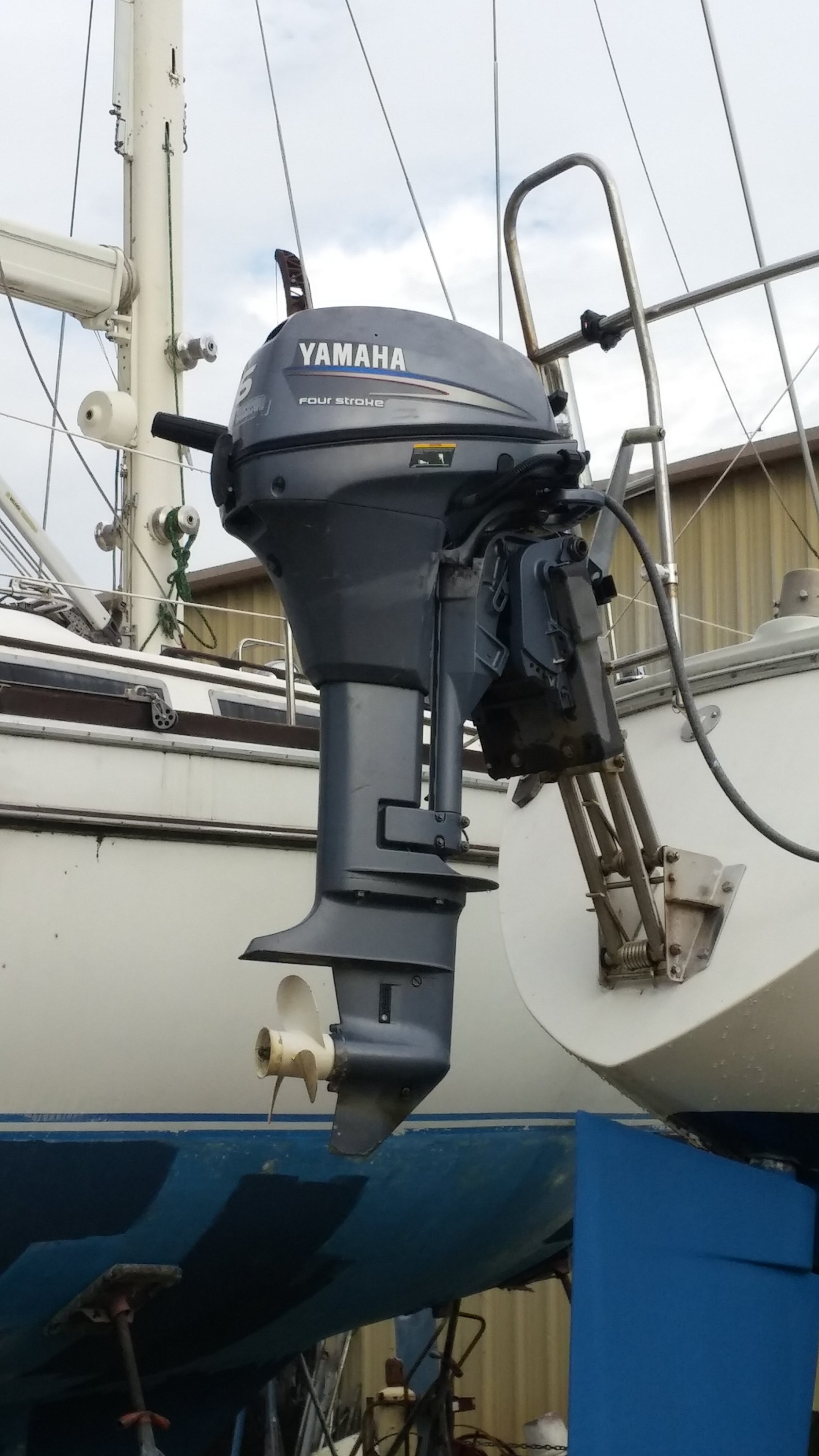

I have the Yamaha T9.9 25" shaft with E Start and Power Tilt. It's 115 Lbs. Nice OB but heavy.
I see the Garelick mounts have tilt adjustment for sloped transoms so the mounting plate can be set to vertical. Then with your power tilt you just tilt it down until level.
The Yamaha 6hp 4 stroke short shaft is listed as weighing 59 lbs so your looking at roughly 45 to 55 lbs additional weight. I think I would op for a new bracket and ensuring the transom has a good backing plate.
