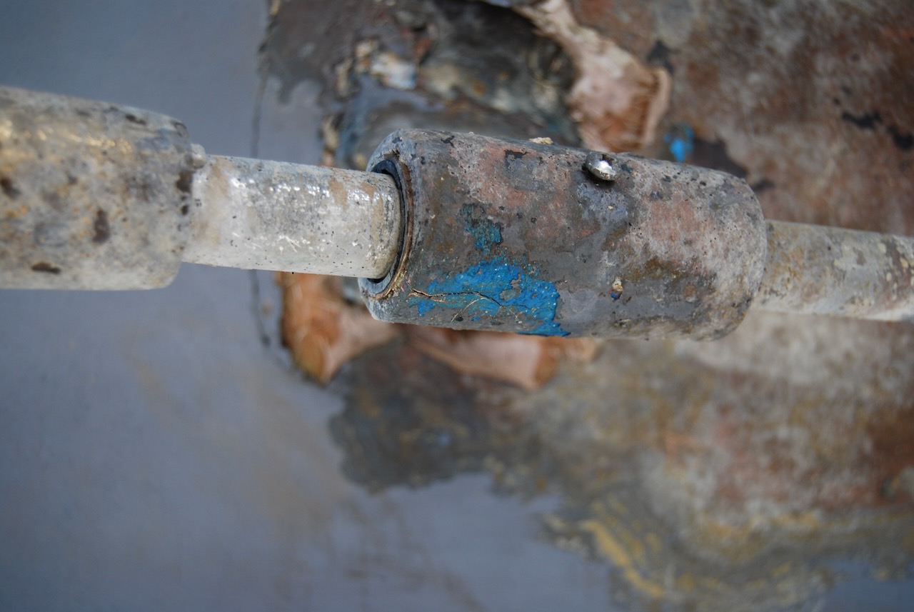

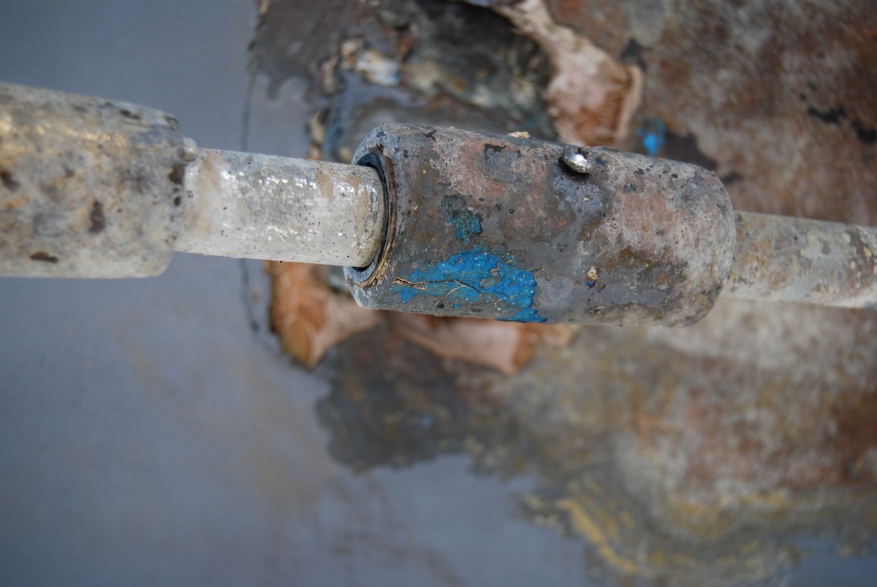

However, in modern bronze production, there are many alloys produced that are classified as "bronze" but do not necessarily follow the above definitions. There are a number of bronzes in fact that don't even contain tin... This is then even further complicated in that many manufacturers did not use a bronze as a material for the strut in the original manufacture. Without more knowledge, we don't even know what your strut is made from. That pink areas definitely look like de-zincification.
Couple of pics
From the looks of your images, I would tend to agree with the yard that your strut appears to be in good enough shape to not require replacement, at least at this point in time. The pink areas are a concern, but clean them up well. From here it's not possible to really know but it looks superfical at this point. I'd certainly defer to the advice of someone that can actually look at it.
Someone suggested putting on zincs on this strut, I agree with that. Bonding it may be didfficult to do, but if you can then that would also help. I would definately put zincs on this strut no matter.

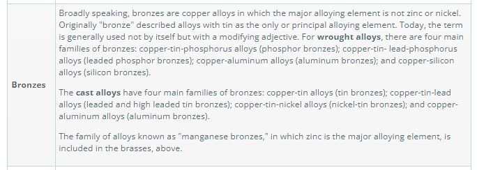

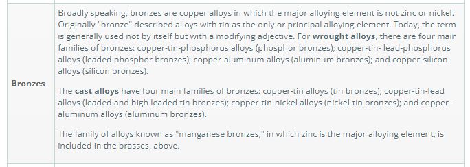

@jviss Modern bronzes are more complex than the historic use of the bronze definition of copper-tin alloys. I attach the current definition from the CDA, the Copper Development Association. If you'd care to read it, it states that a bronze is a copper based alloy that does NOT contain as the major alloying element of zinc or nickel. But, it does not state that a bronze is a copper-tin alloy. It also goes on to say that "Originally "bronze" described alloys with tin as the only or principal alloying element. Today, the term is generally used not by itself but with a modifying adjective."
Hence, as I said, you are using an archaic definition. But then I guess as you are an electrical engineer, you know everything there is in the world of engineering... I'm happy for you....
Note in the above the alloys called "manganese bronzes", a likely candidate for the alloy used in the OP's strut, is technically a brass, despite it's name...

The cause is lack of protection, especially if the strut is made from manganese bronze. Dezincification is the "normal" degradation of this kind of alloy in seawater. The OP doesn't say the age of the boat, the Newport 30 Mark iii's were made between 1971 and 1996. So the boat is somehwere between 51 and 26 years old. 26 years is a bit short for the amount of dezincification observed, but 51 years, and the obvious lack of protection, and I'd say that's darned good.
For sure the OP has to find out to what extent the dezincification has extended. It's impossible to do that via photos. The strut must be cleaned via sanding, grinding, or however, to remove all traces of the dezincified material. That will reveal what is left of the strut that is still structurally sound. No reason to go lightly here, all dezincified material has no structural integrity left. Think of the metal as having a structure more like a sponge (if cracks have not developed, another risk) rather than being solid.
