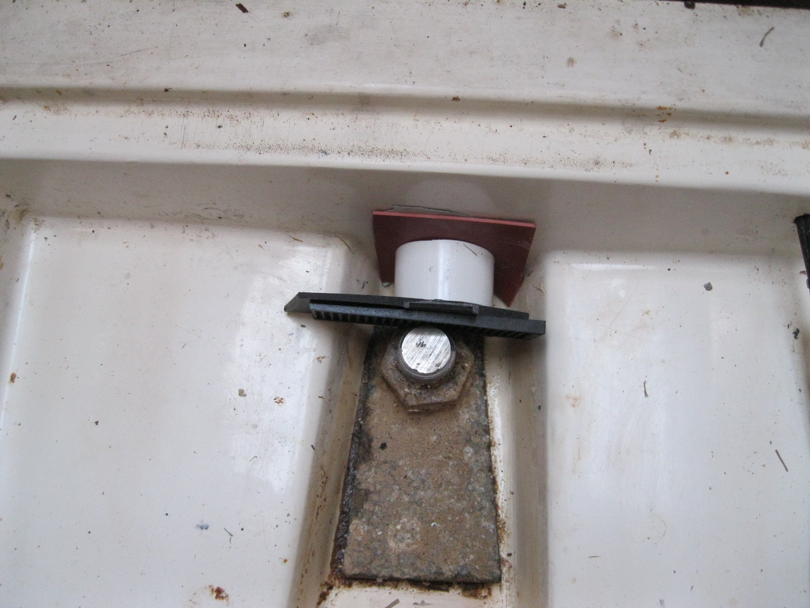

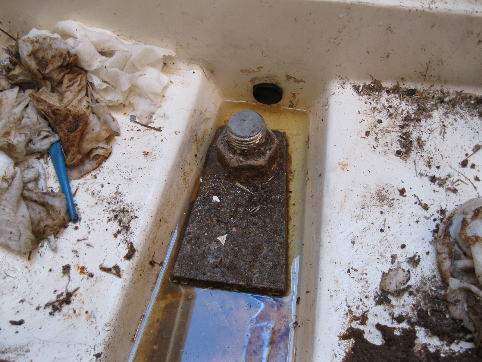

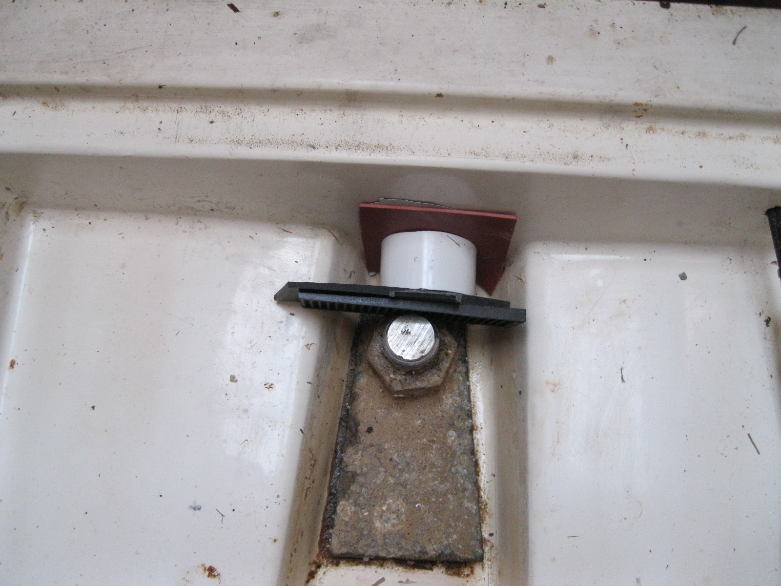

I've known for several years that my 1985 H31 has a small bilge behind the main bilge. It is under the grate that lies just in front of the companionway steps and just behind the main bilge. It has been dry on previous inspections so I've not given it much thought. However I did find water there recently and discovered that the water was coming around a rubber stopper that was placed (by someone) at the very rear of the small bilge. I've enclosed a few pictures - one showing the water and the plug in the small bilge and one with my temporary fix to stop the leak. The fix is just a 1.5in PVC pipe wedged against the plug with a rubber membrane in between . The pipe presses against the membrane and the rear section to hold in the water leak.
My questions are: 1) why is this rubber plug back here. and 2) were is the water coming from that is behind the rubber plug. I'm thinking the next time I have the boat on the hard I'll remove the plug and glass over this hole.
