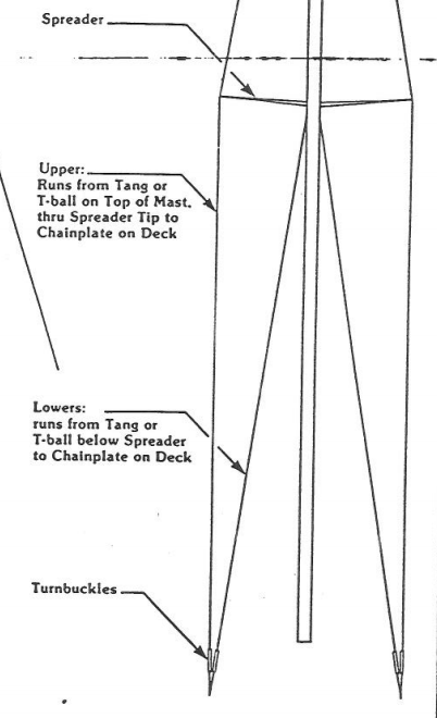

I would not expect you to turn the deck chainplate. Can you slack the shrouds at the turnbuckles fastened to the chainplate as shown in the owner's manual below, make your repair then re-tune per your manual. Hope that helps.
