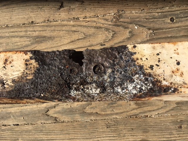

I have placed in the owner mods, the steps taken to replace the chain plate and support rods for both port and starboard after losing the port side due to metal failure resulting in the loss of the mast. also important to note with my insurance policy, it did not cover the failure due to "rust, corrosion and fatigue". Suggest owners check their insurance policies. In my case I was able to find a replacement mast from a hurricane damaged boat saving me quite a bit of money but the overall replacement of standing, running rigging and repairs to chain plates was extensive. any particular questions, please send me a IM.

Nice job with your mod posting. Looks like the support rod broke where it was screwed into the backing plate's acorn nut. Was the piece of the lower part of the rod still in the stainless acorn nut?

Yes, the lower piece of the rid remained in the castle nut. The failure was not from the rod pulling thru the mild steel plate but appears to be more as a failure between dissimilar metals over time.
Apr 5, 2009
3,333
It is scary that the rig depends on a piece of mild steel angle iron that isn't even galvanized and cannot be viewed for inspection.:eek:

Thanks for posting your article. Do you still have the piece(s) of the rod still in the castle nut? If you could take a very close picture of the actual fracture that could be useful.
Two dissimilar metals can coexist if not bathed in an electrolyte. Was the area prone to water saturation? But the failing metal would be the soft iron (the least noble). I'm curious to look at the fracture for signs of flexing (ductile fracture) or from a concentration of stress in the depth of the threads (more like a brittle break). Just trying to learn and anticipate what is in store for my boat.
Was the old castle nut free to turn (at least originally)? I thought that might have been how the entire rod is tensioned or pulled down snug to the deck.

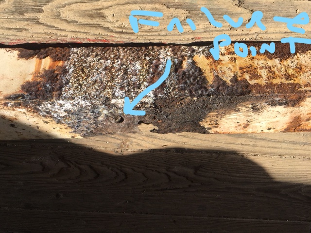

Alan - no longer have the piece parts. Attached pic is the rod where it broke in the castle nut. It appears it snapped or broke lose from the piece still in the nut. it was at the surface of the iron where it screws into the nut. The nut is threaded and welded in place and does not turn. The rod screws from the deck downwards into the nut that is welded into place. Also attached a pic of the angle iron where it snapped (see circular ring in the rusted area). It does not appear to be a flex fracture because the nut/rod did not pull thru the rusted angle iron.
The pic indicates a brittle break. As far as saturated in water, I have owned the boat for the past 7 years and have kept the deck chain plates caulked/sealed. I can't speak for the other 27 years of the boats life. I can only assume from the surface rust in the small inspection area provided by Hunter, the previous owners did not attend to this as carefully as they should have.

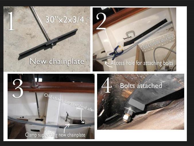

I found the chain plate pics below on the forum from a very old post on a H34 that was damaged in the Caribbean and this is what the owner did to fix. this gave me the ideas needed before cutting into hull liner. hope this helps. IM if you have any more questions.
This is something I would add to and move up on the maintenance list especially if you intend to keep the H31's and H34's. If you have access to a machine shop to fabricate the angle and new rods the repairs can be done by an individual instead of a yard once the mast is down. I was surprised how much the replacement rig and associated items cost. I had too much invested into my boat at the time of the failure and wasn't interested in any other boat except the H31. This is the perfect size boat for me and therefore I decided to go ahead with the repairs instead of scrapping the boat. also it didn't help matters with the insurance denying the claim. Check your policies. Mine is with progressive and clearly states coverage does not apply to wear, tear, corrosion and fatigue. Jerry.

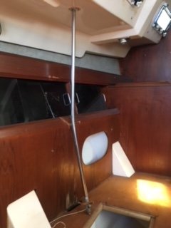

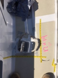

Allan - doubt a split ring would work. If rig is under load/sail, then it will pull thru the deck below pics of bent support rod and deck damage when it pulled from port side and went over starboard side. Mast hit the life line with such force it bent the stanchion and the lifeline wire acted like a knife and cut the mast where it hit the lifeline. The mast was actually dangling at a 90 degree angle from the lifelines. we were lucky one of the spreaders didn't poke a hole in the boat.

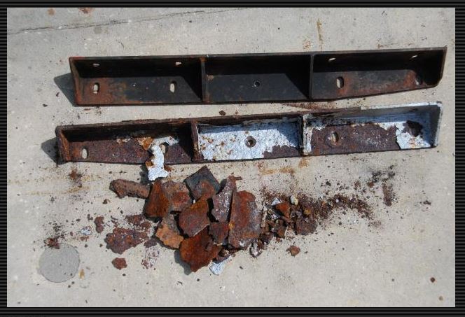

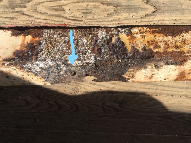

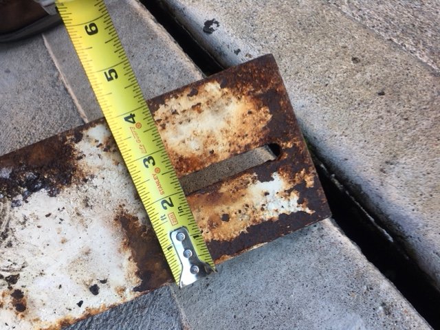

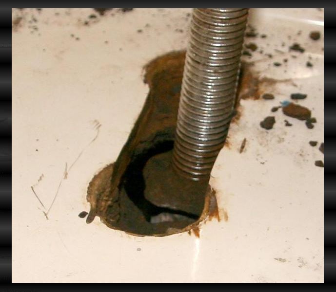

1) In this picture you posted, the angle has rusted away. Would you have been able to see this in advance if you had drilled an access hole underneath the rod? I'm thinking I should drill an access hole there on both sides and look up from underneath. Would you recommend that?

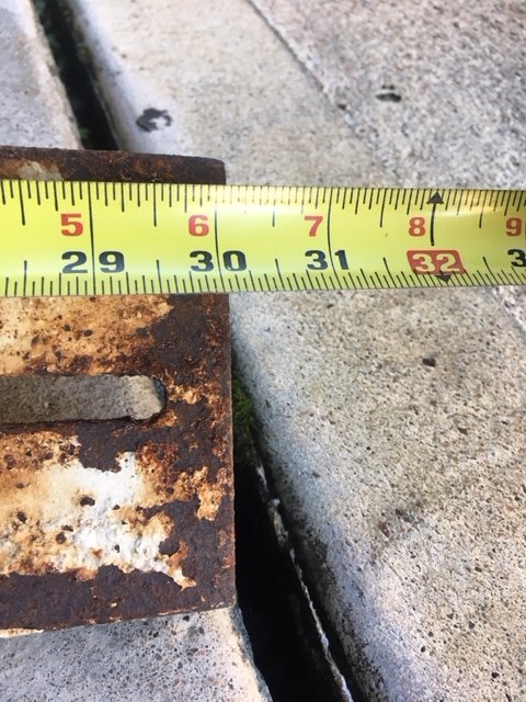

4) From your pictures, it seems like you used a slightly different design for the port and starboard side. It looks like you used a 30"x2"x3/4" thick flat plate for the port side, whereas you used an angle for the starboard side. What was the reasoning behind this?

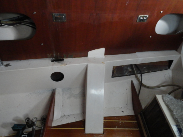

for question 1 - the area that Hunter provides on our boat for a visual inspection is not much, it measures 3" long at best and if yours is in the state of mine, you will likely see visual surface rust. You can drill an inspection hole/cover below the area where the rod comes in. I have now added these to both port and starboard for future inspection. Would this have helped me, probably not. After the failure, we inserted a camera in the inspection port and it did indicate rust on the angle iron. My failure was the rod broke where it is inserted into the plate. It did not pull thru the plate. the carbon steel was intact albeit not by much (see pic of failure point). Mine was more of a metal fatigue on the rod/castle nut connection.
for question 2 - yes it did come out easily once we cut the opening to remove. for the plate that didn't break (starboard side) we cut the rod above the chain plate opening in the cabin. that made it easy to remove. (see pic of inspection port and opening we cut into the liner.)

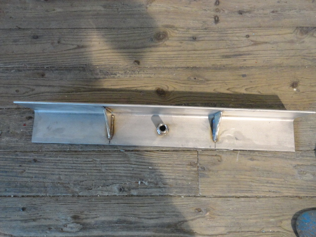

For question 3 - we used 5200 to hold the new stainless steel angle iron in place. We wanted something to remain in place when tightening the rods. In my original post, you can see from the repair pics from the H34 that Hunter originally used a bolt/nut to hold the angle iron in place before inserting the rods and tightening down (see pic of 4 pics in one - titled chainplate 1). Since the boat is already 34 years old and the fact that we went with similar metals (SS for angle/rod in lieu of original design of CS and SS rod), we elected to go with the 5200 to hold it in place. I believe the new materials will outlast the boat.
For question 4 - we used the same SS angle iron on both sides, 30" long a 4" x 1/4" thick (see pics of measurements and pic of new SS angle iron.
