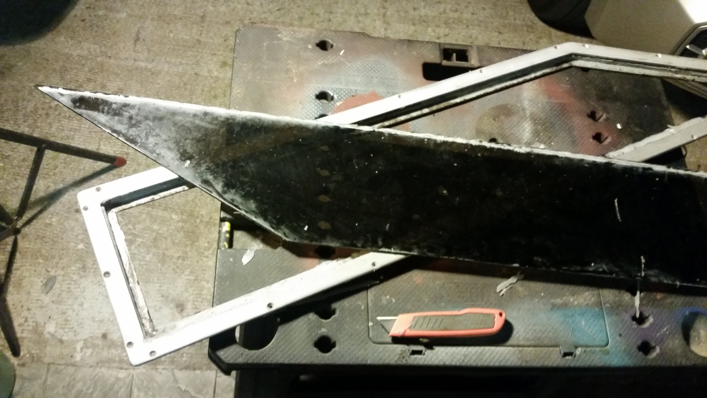

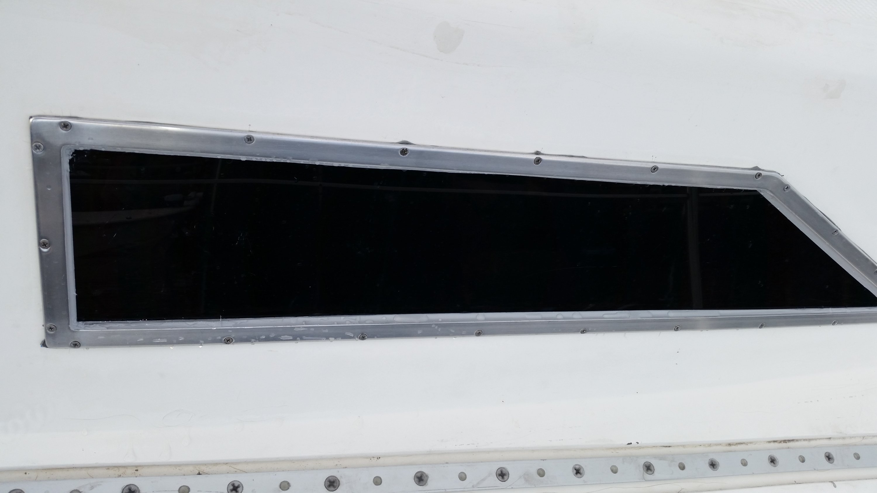

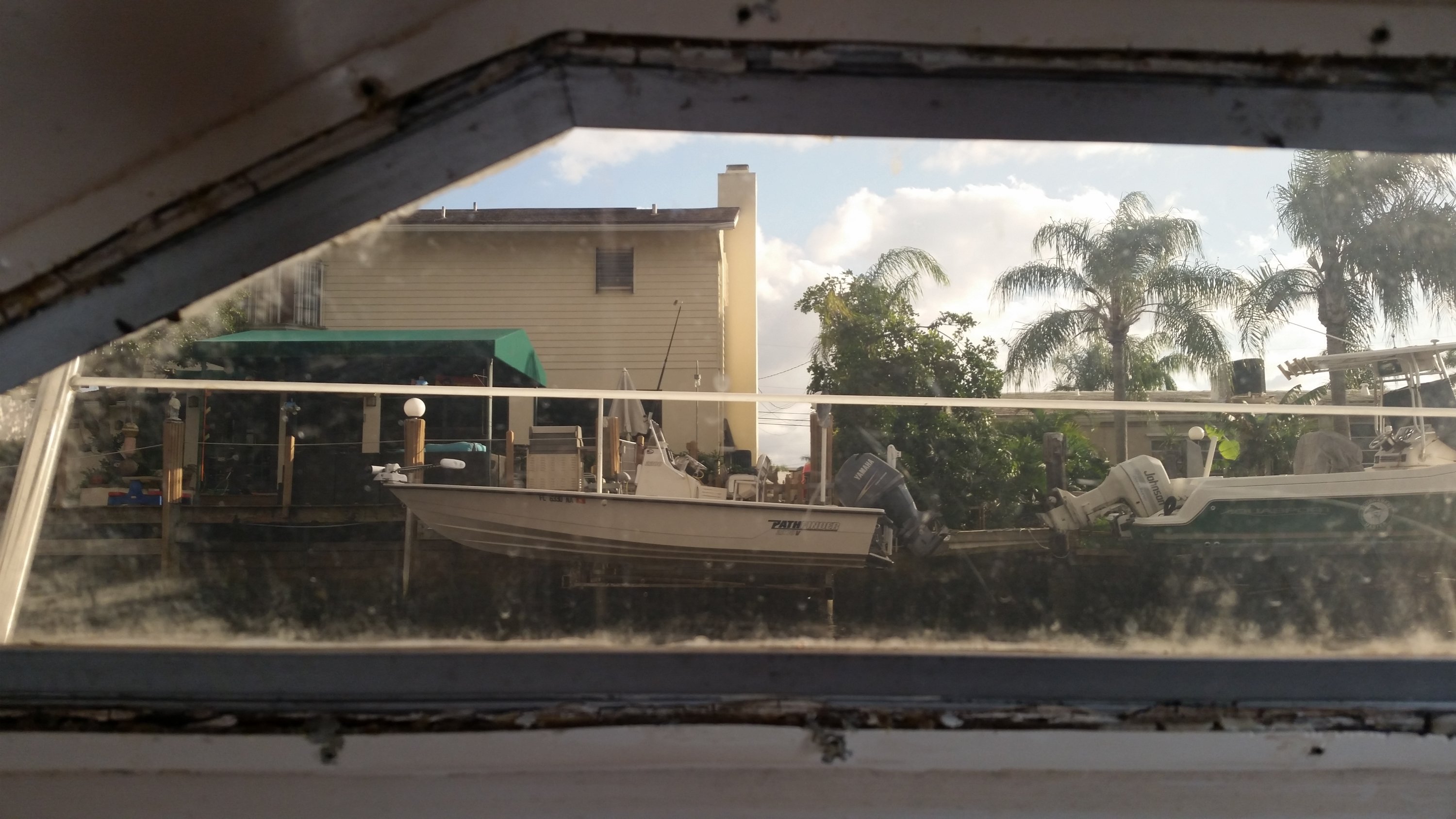

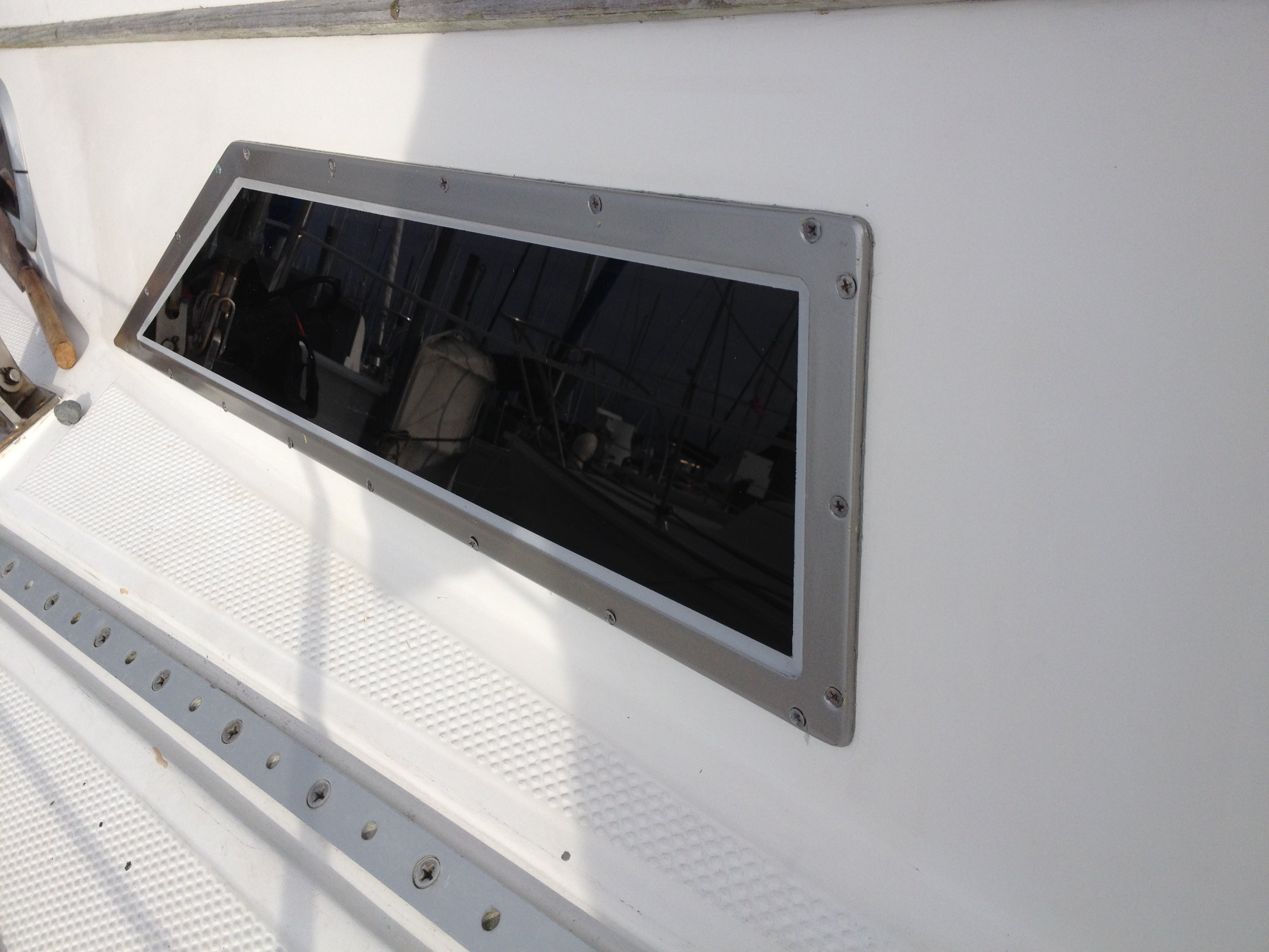

My lenses weren't cracked, just badly scuffed/etched, so instead of buying new I sanded and polished the old ones and reused. they didn't turn out perfect, but I think they are good enough.
Scratched fixed port lenses. What a mess behind the frames
You can really see the scratches/etching

All good after sand and polish.

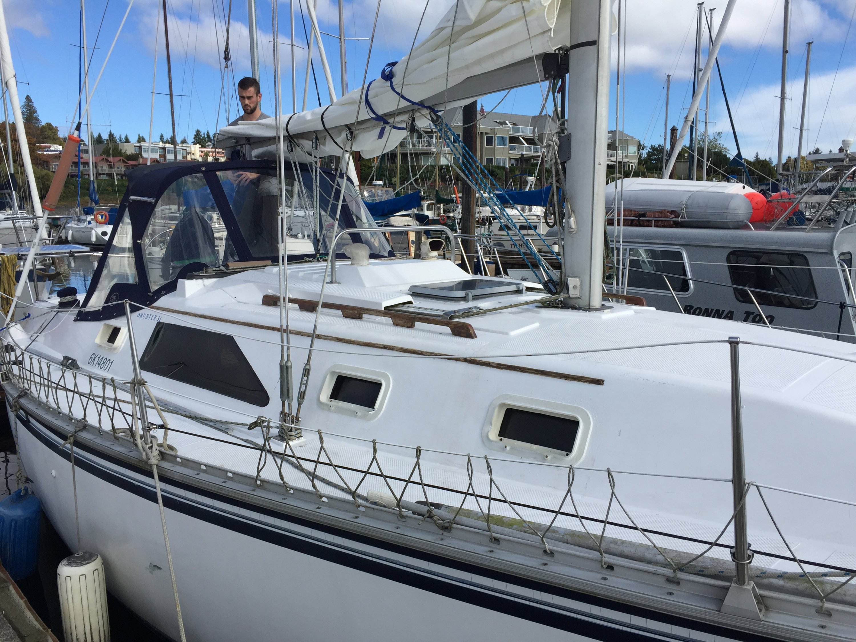

Portlights are all done, and totally dry after the last big storm, happy about that! Have attached a pic to show the new window we installed. Wooden trim being built for the inside.
Found there was water still dripping in, however not from the windows. You may want to check that thin wood detail above the windows. I found 13 screw holes on the stbd side. Both are coming off and all the screm holes fiberglassed, water was seeping in through the screwholes. Did the STBD side yesterday and doing the port side today. Found one screw was missing and just an exposed hole. At very best check it to make sure its sealed tight.
