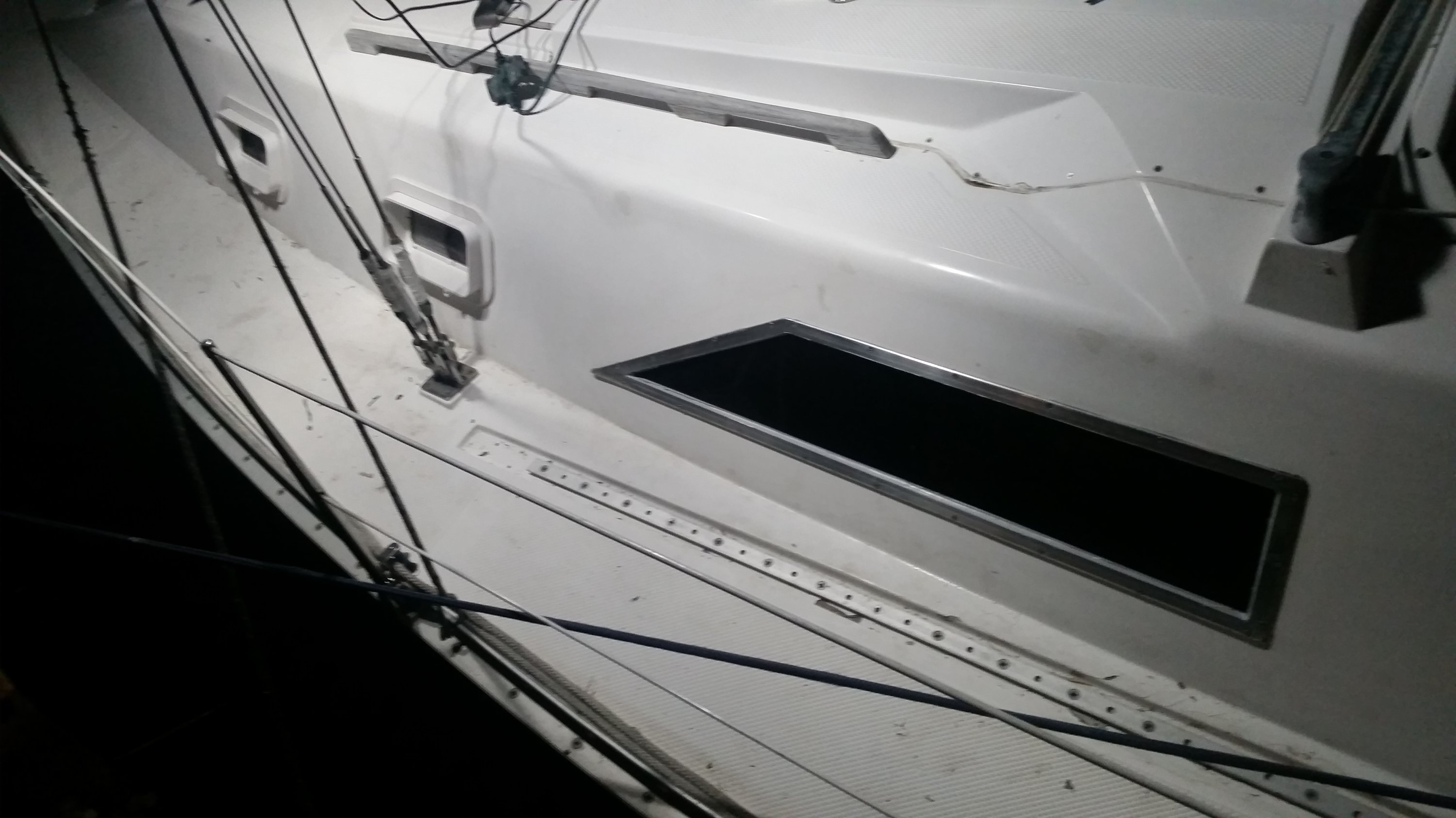

Decided this morning to tackle the large fixed window port side, because that had the biggest leak. Kinda cheap window. Undid all the screws holding the trim on the inside, and that's it for screws! The window is simply sealed in from the outside, pressure fit I guess, no screws to anchor it. Took a while to carefully get it out but did OK, prying and cutting with a knife both inside and out.
The plywood inner wall was rotten and water logged at the two ends on the bottom part of the window. Dug at least three inches out until I got to decent wood. Covered it all up after cleaning the fiberglass in and out, and now letting it dry for a few days.

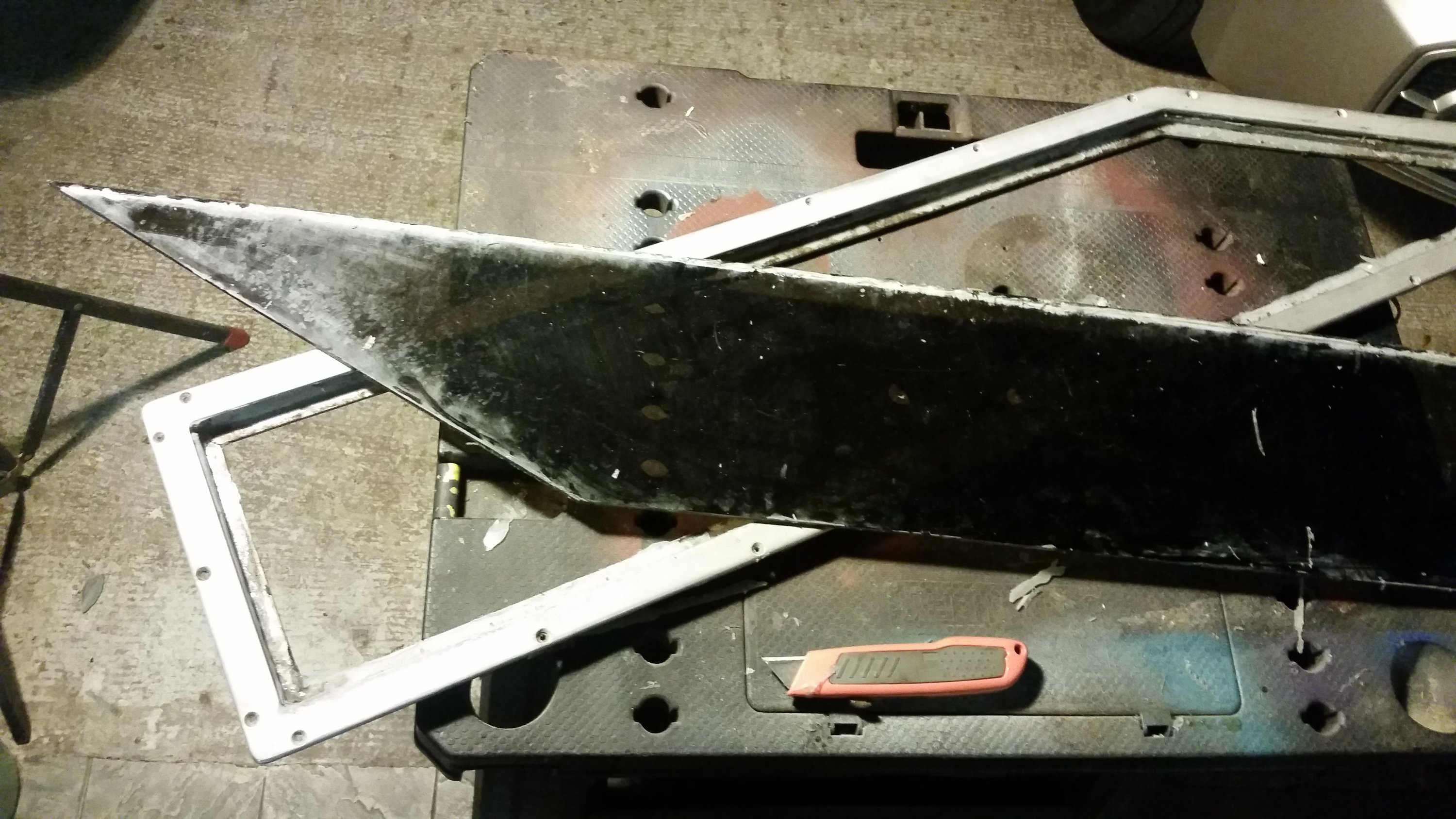

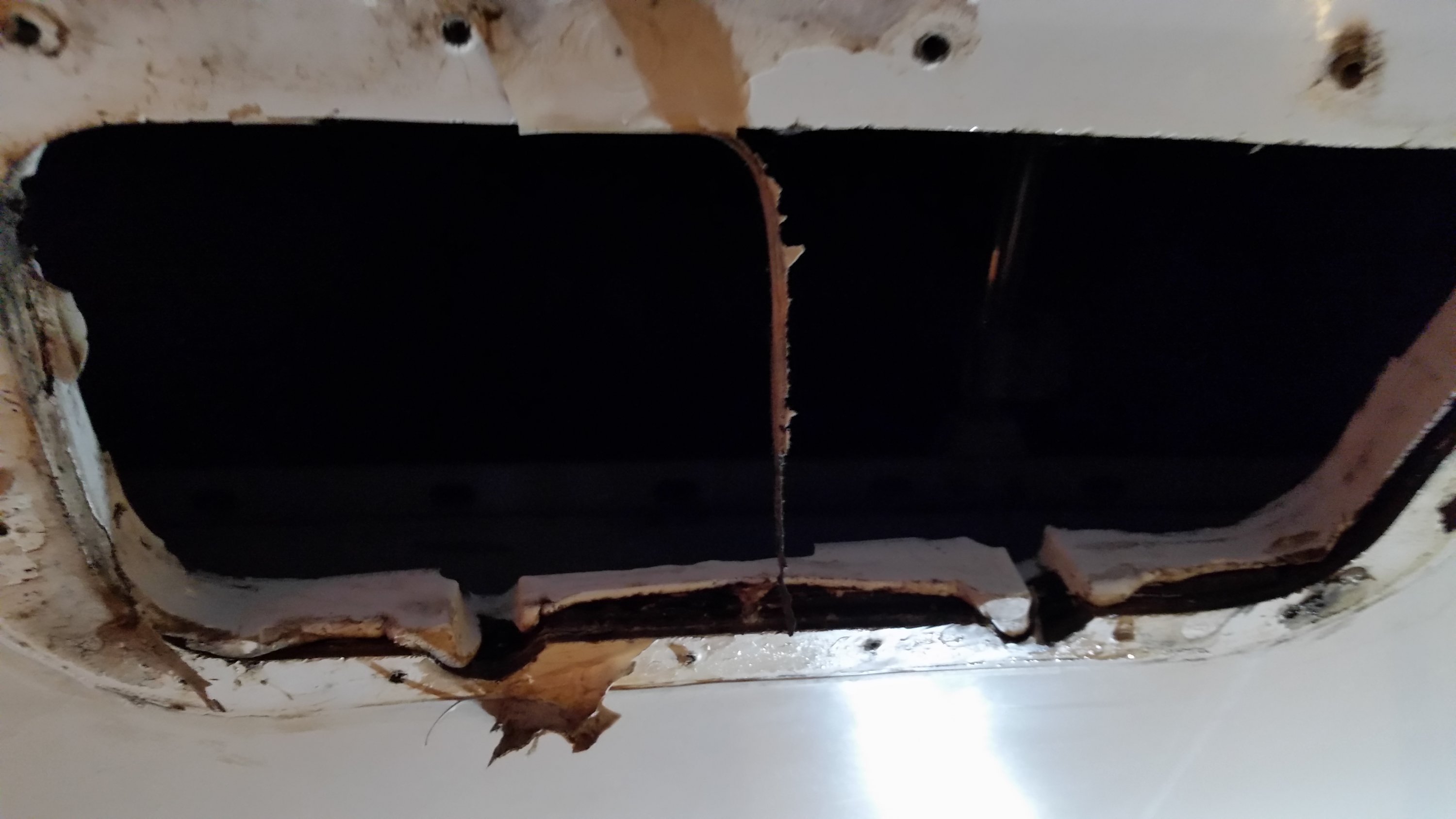

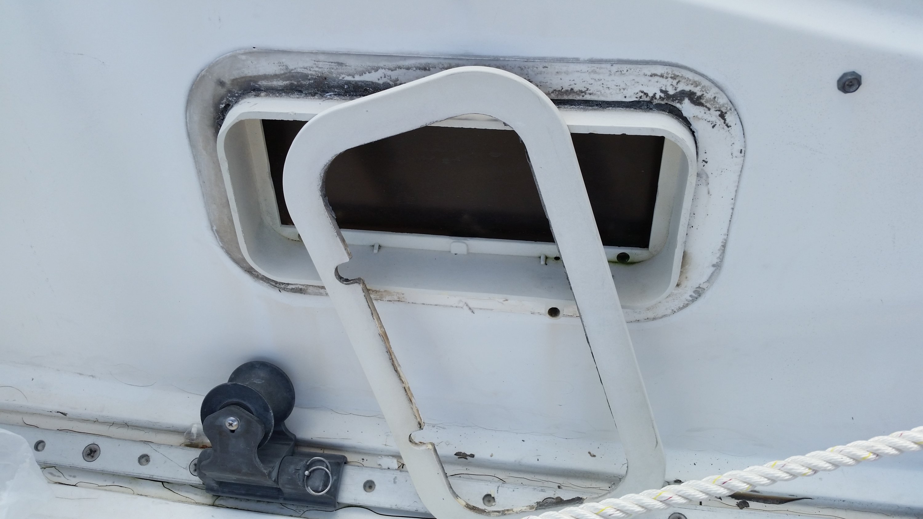

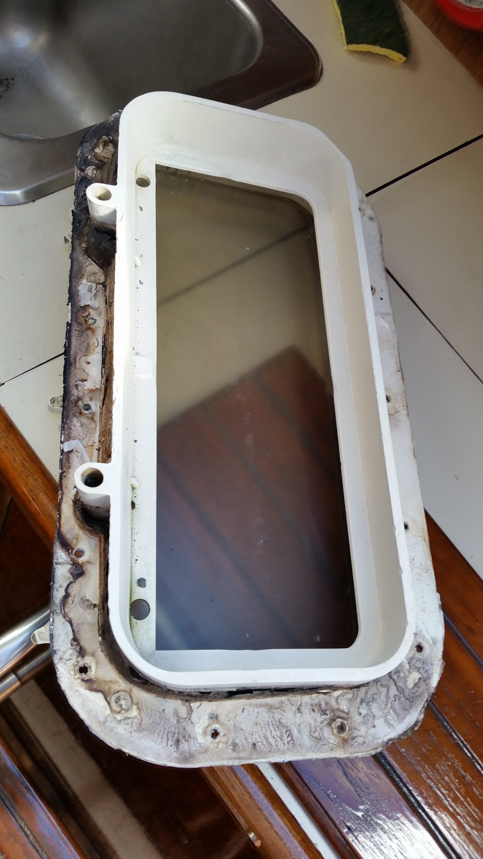

Mine were pretty bad off, with lots of old sealant.

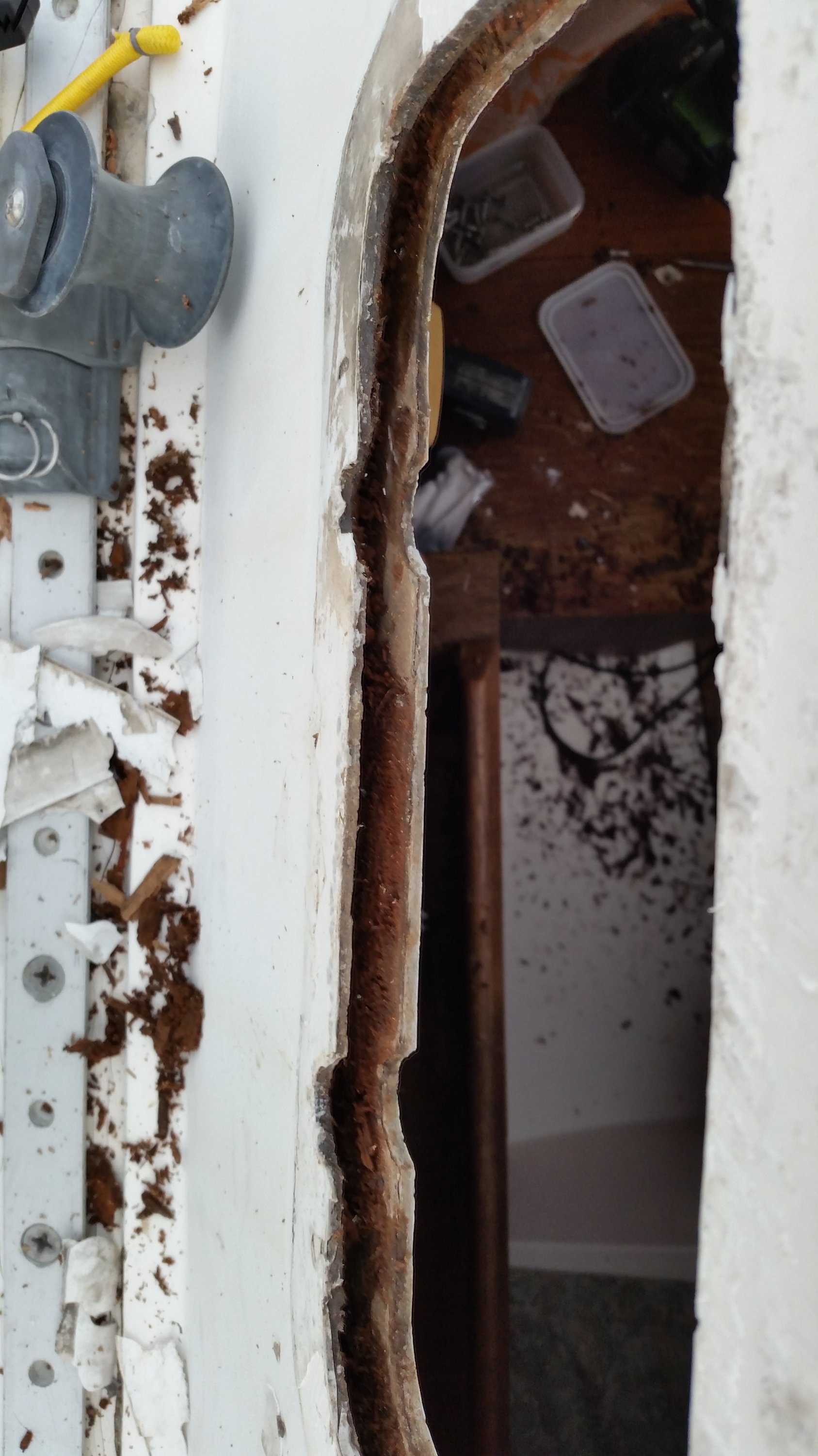

Had to hog out a lot of soft wood surrounding them

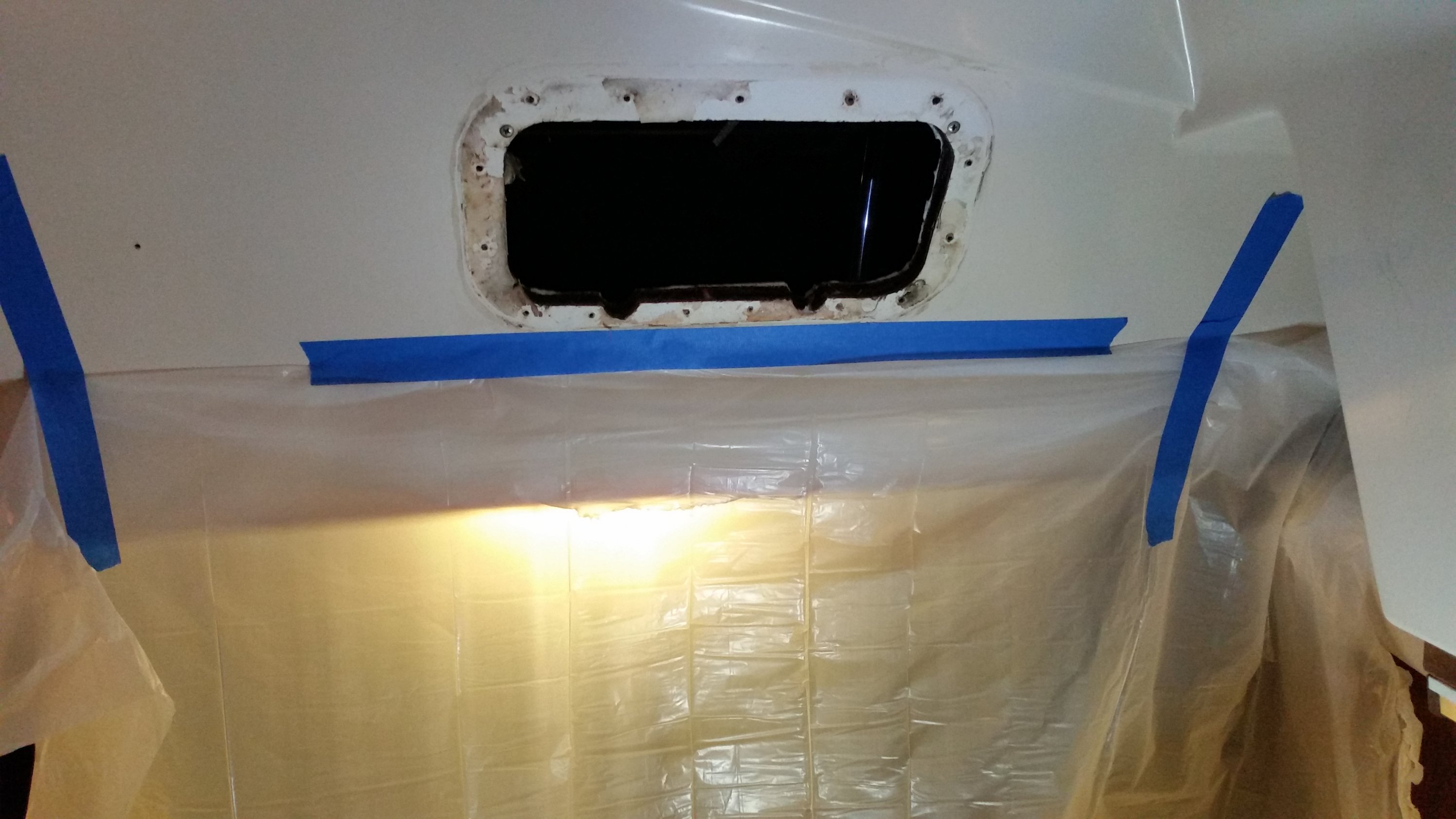

Let dry for a couple of days and filled the spaces with Bondo-Glass, This stuff is really drippy, so use lots of masking tape and plastic sheeting to protect whats below the ports.

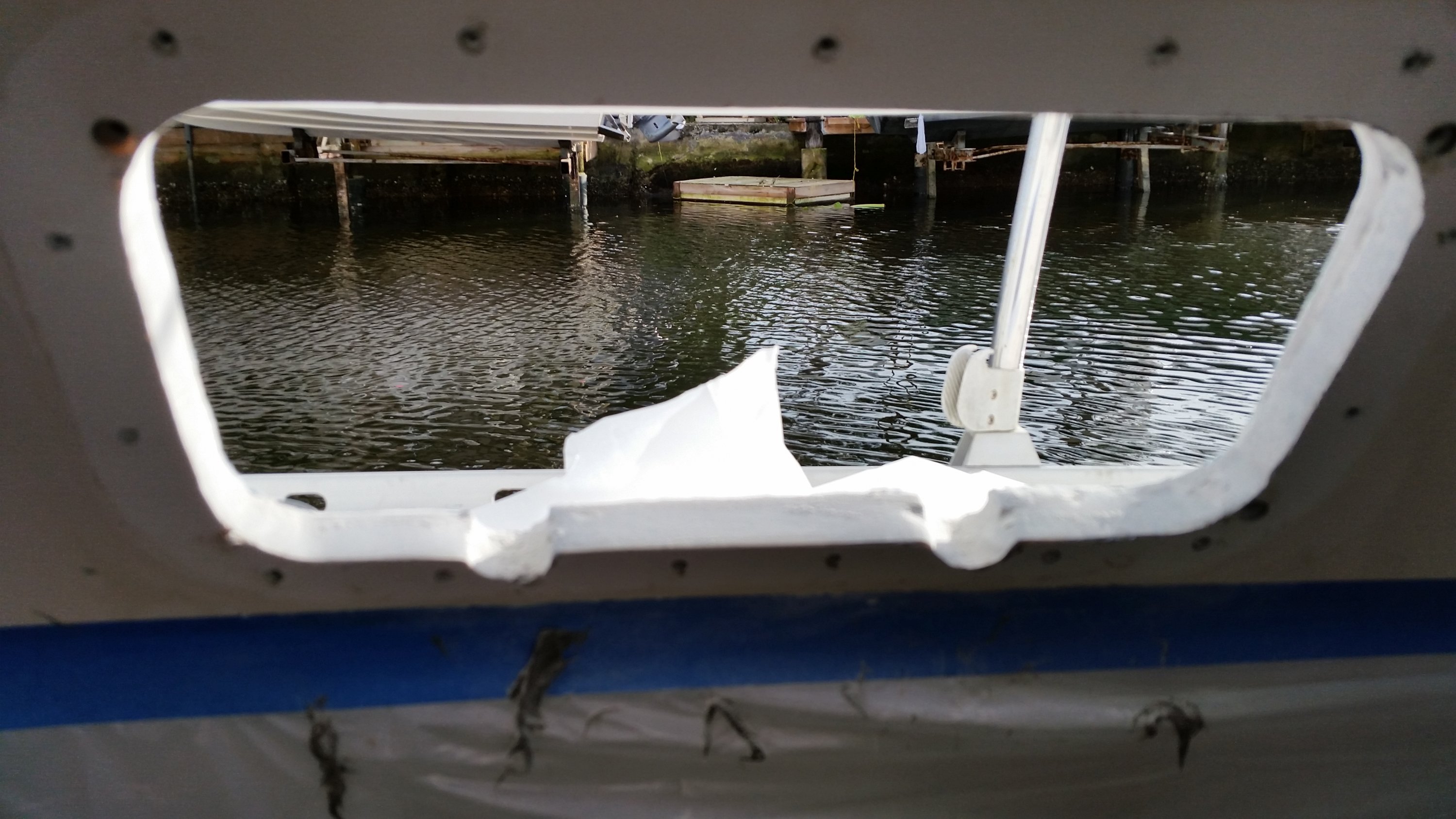

I then routed/ground/sanded the openings to the correct shape, and coated with white pigmented epoxy. I really didn't need the pigment and did not use it on the other ports.

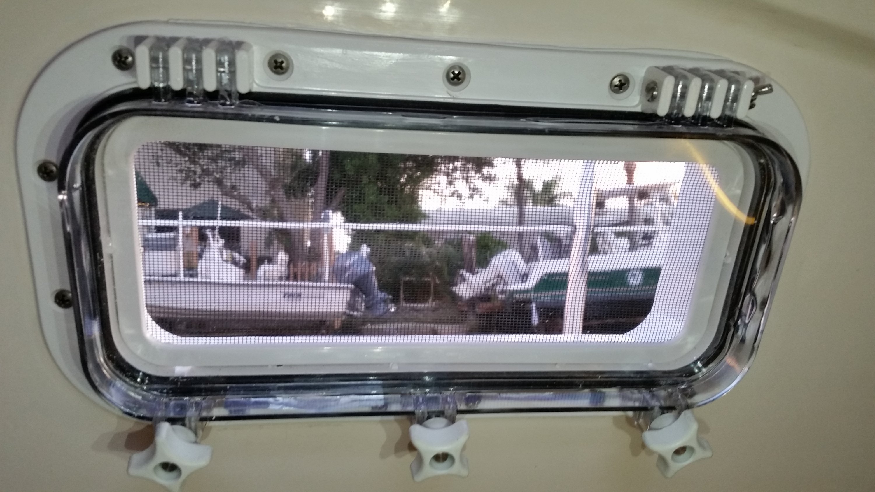

I had picked up a deal on some factory second ports from Pompanette at the Ft Lauderdale Boatshow. They had minor blemishes, but the final results made me quite happy.
Let me know if you have any questions. Hope this helps.

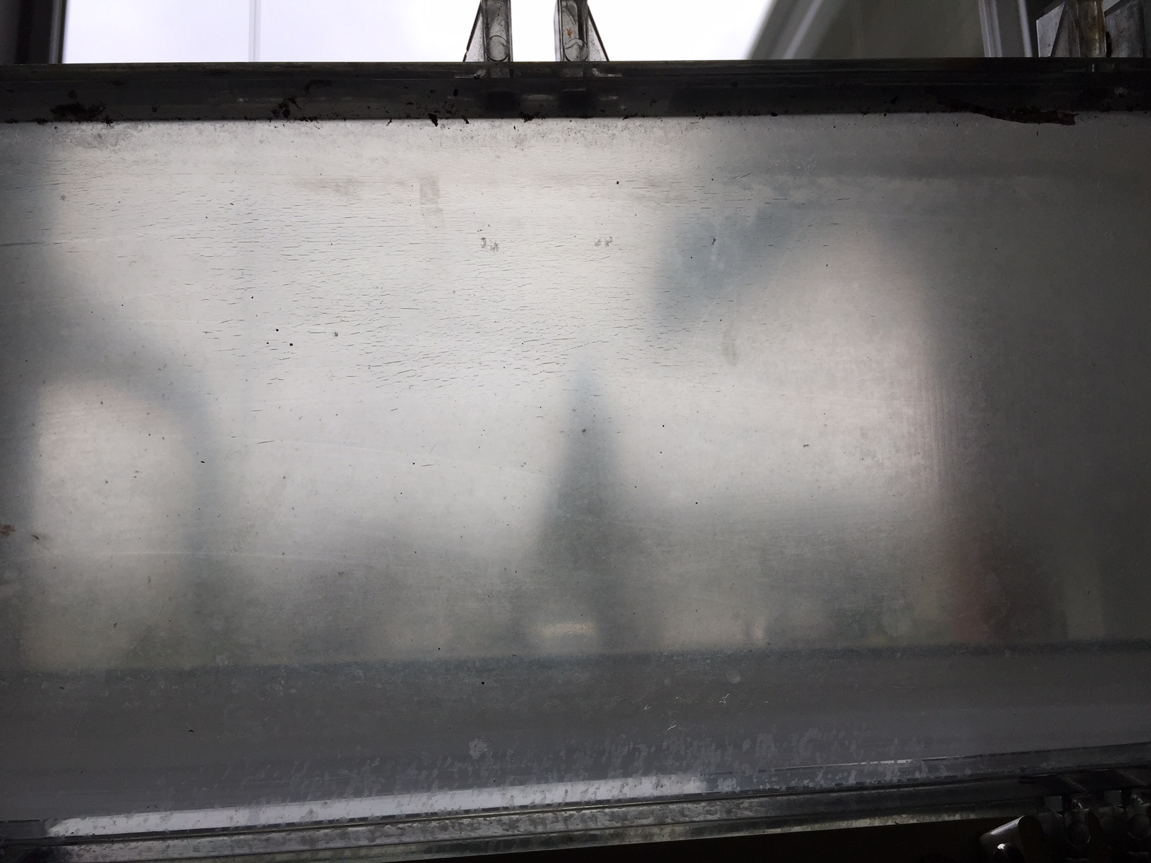

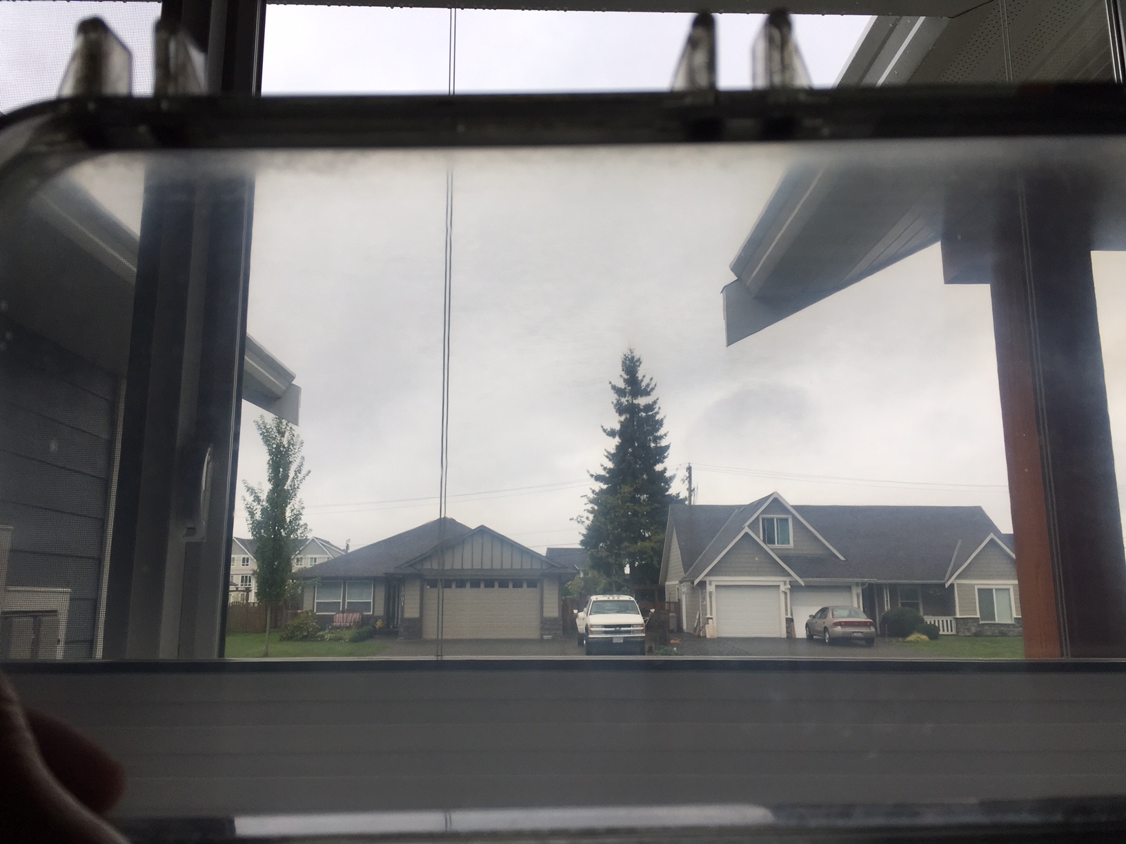

Well, managed to get the 6 cabin small opening port-lights back in today. Used Boat Life Life Seal. Made sure the outside surface was completely clean, no old silicon residue using scrapers and acetone. Where the lights go through the wall, the plywood is no longer showing, I made sure the exposed plywood was covered with fiberglass resin all the way around. No more rotten wood if they ever leak again. Did not get new port-lights, installed the old ones. The lenses were completely opaque from sun and water exposure, however I used car headlight cleaner (wet sand then applied the buffing cream and a protectant coat after on both sides of the lens) and they came out pretty clear. Not as good as new but almost! Have added a before and after shot (Hadn't quite finished when I took the after shot, it is the dirt line at the top is gone ). Now to tackle the two large fixed port-lights; the plexiglass is ready so will try and get them done in the next few days.

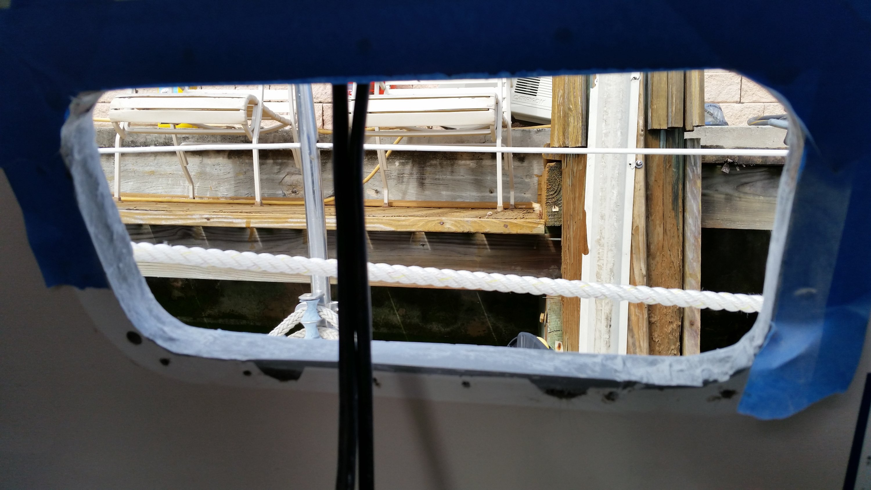

The opening needed a lot of work and epoxy.

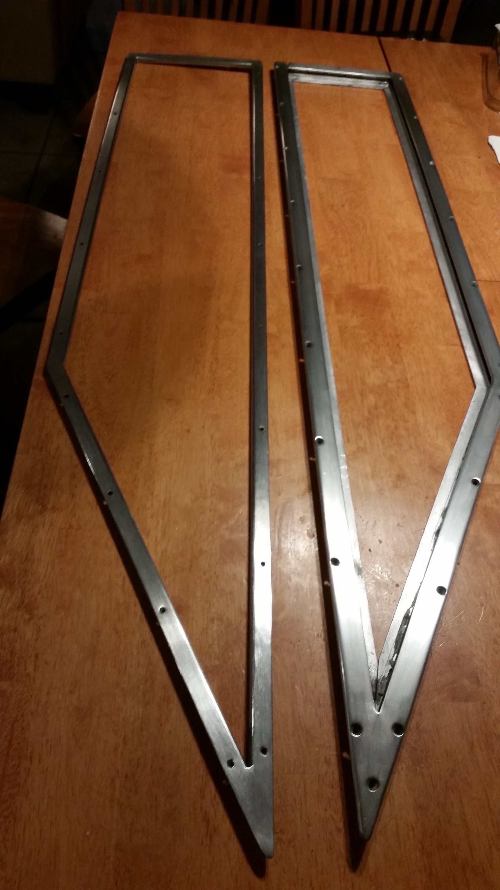

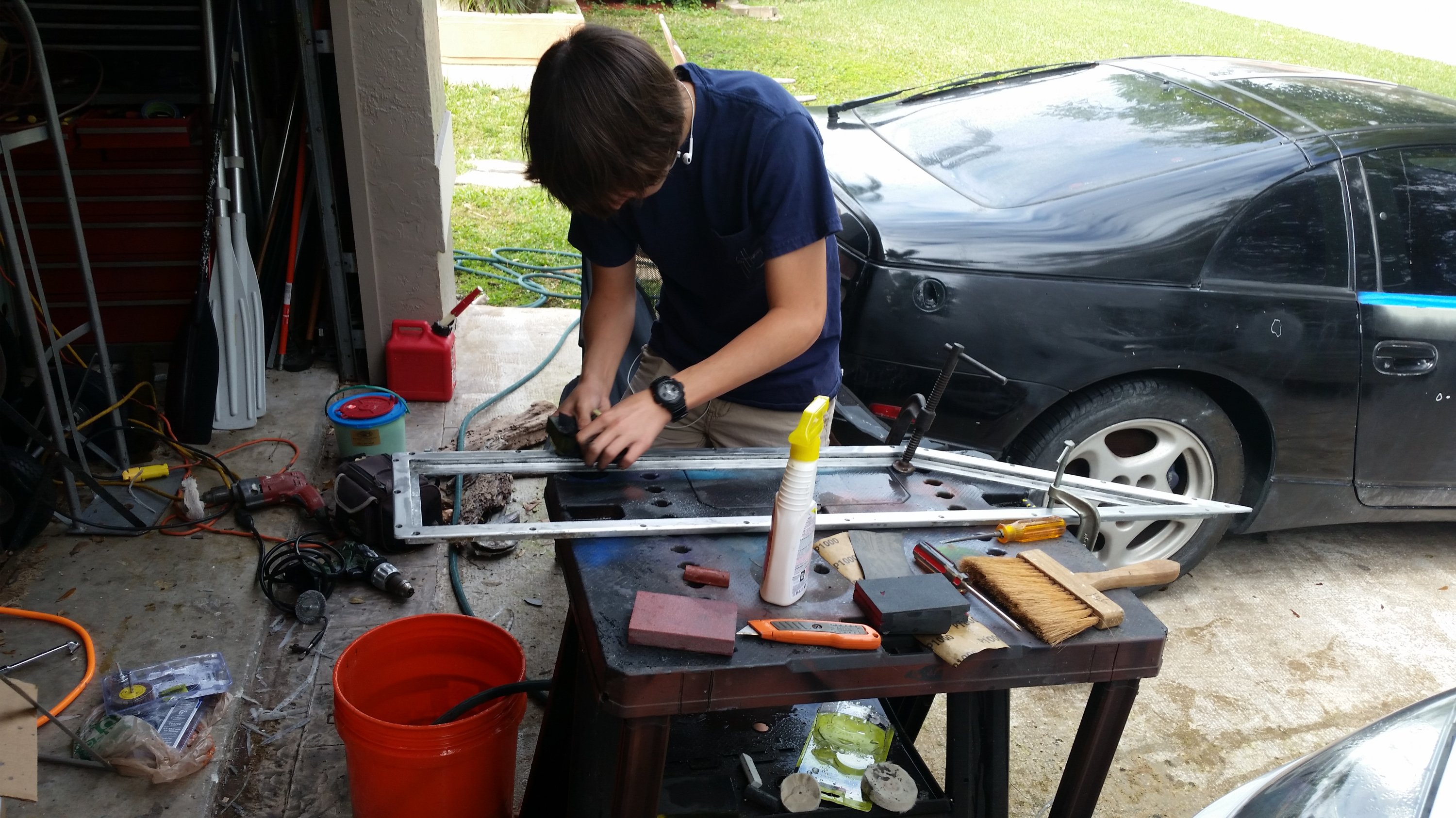

My son Helped to sand and Polish the frames
They Came out Pretty Shiny

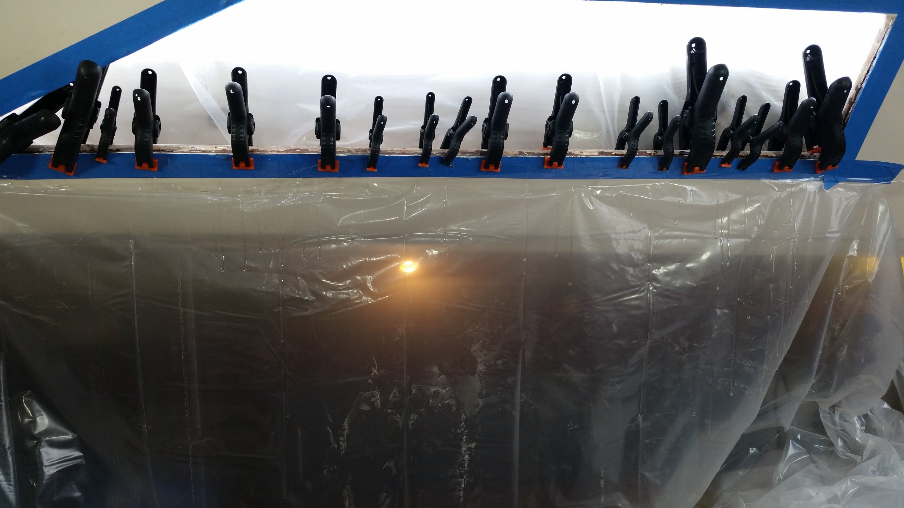

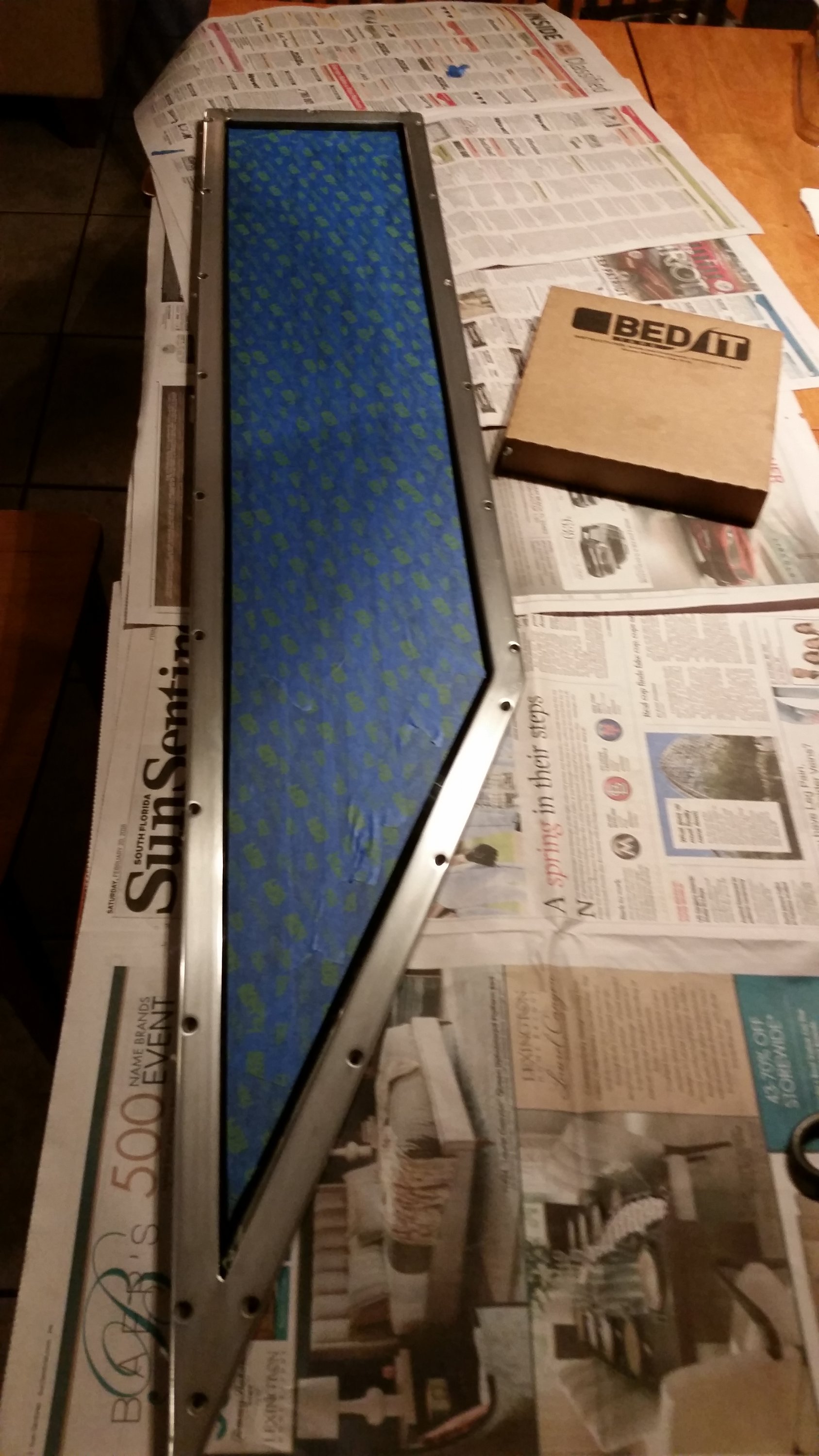

Taped them up nice.

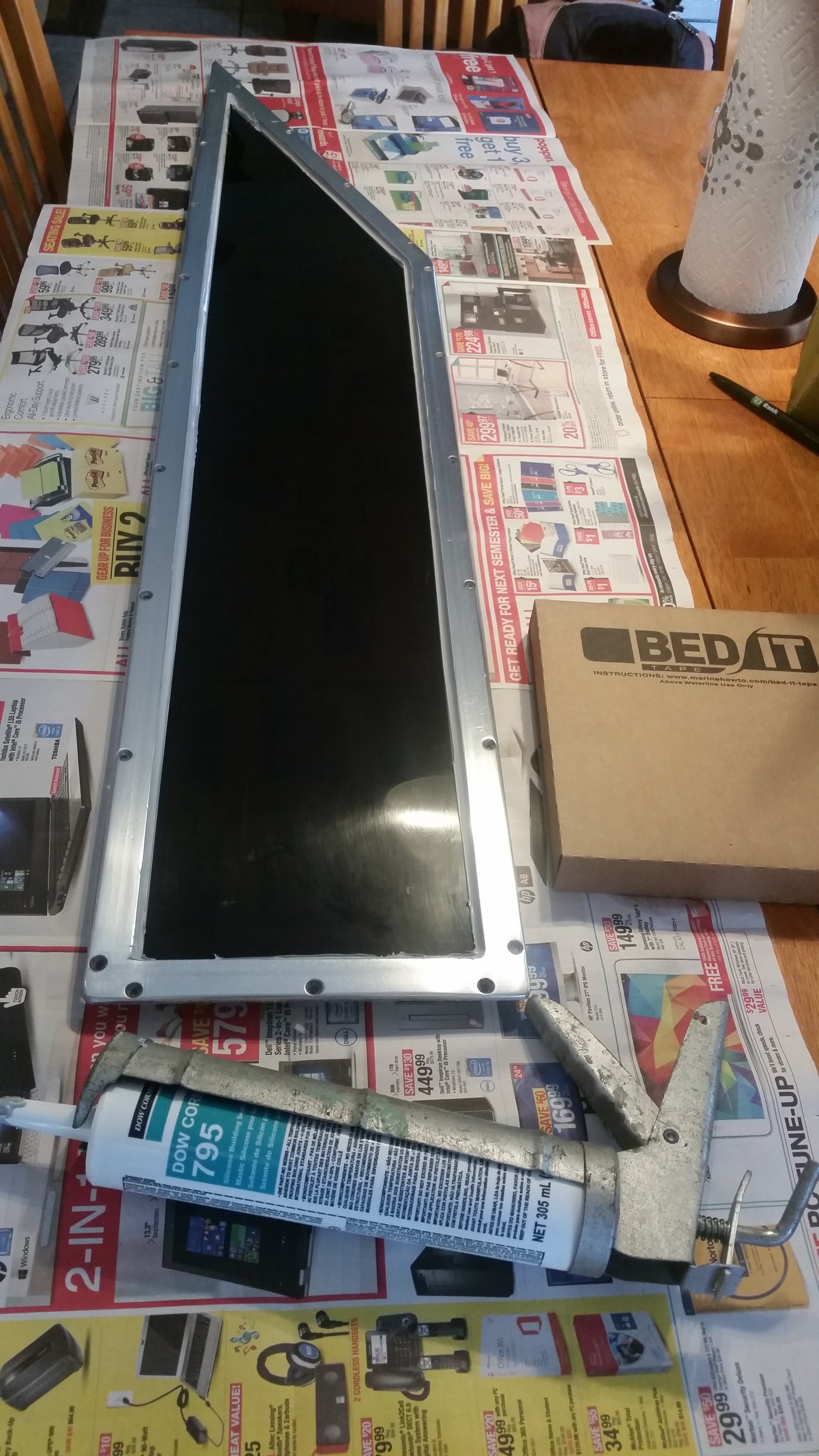

Re-bedded them with Butyl Tape and DOW 795
