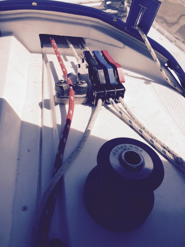

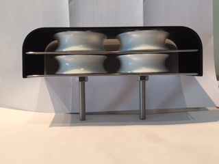

IMG_0438.JPG IMG_0439.JPG IMG_0438.JPG I had a local machine shop/rigger make a stacker set identical to the original. It was more expensive but i did not want to drill/tap new holes in the deck & aluminum plate below and allow for another moisture point. Was able to run all lines under the hood to addl clutches
