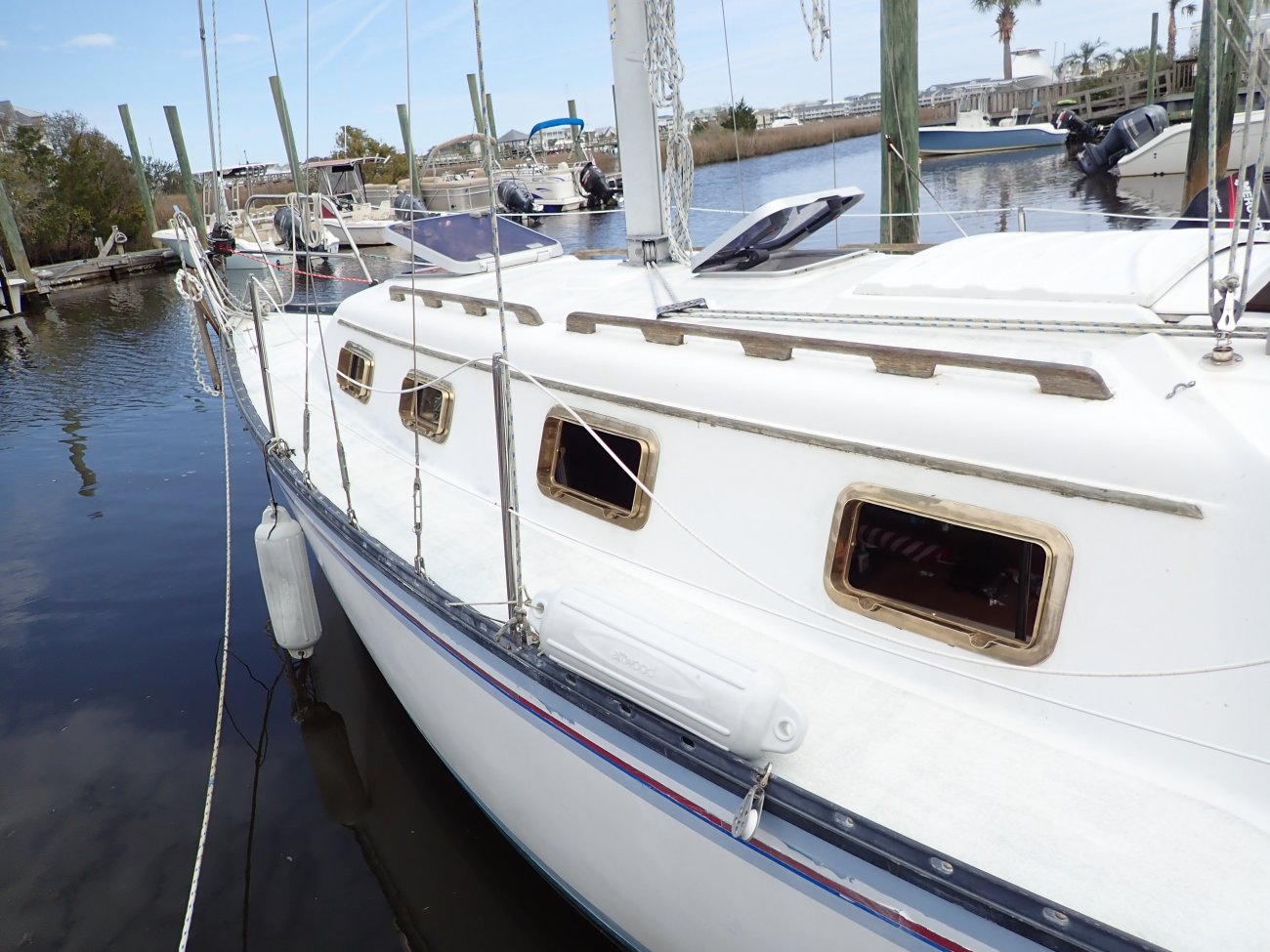

I have just finished replacing the original Gray Industries plastic ports with New Found brass ports. I am offering the old ports, or parts there of, for free, plus shipping. The old ports are the standard 5 x 12 and 7 x 15 (4 of each) for the h27 and are in poor shape. Most have at least 1 crack, but none leaked at the time of removal. I have not cleaned the old ports yet, but will hold them in my garage until April 15, 2019 to see if there is any interest; if no interest they will go to the dump. You may contact me directly at amcmahon@ec.rr.com if interested. Below is pic of new ports in Radiant Beam.

Good question, it really was the look. There are some disadvantages versus stainless - the SS don't tarnish. The brass tarnish VERY fast. The first one was already turning green by the time I got the second done; and with New Found, the stainless have hinges that hold the glass open at any point, but the brass need a chain holder to hold the glass above the head bumping level. But I love the look and they have a neat little chain devise to hold the glass up.

Nice job on the ports. Where did you get that forward hatch, mine is a trapezoid shape and yours looks to be square.

Thanks for good words - A ton of work to install though, after learning on first two, averaged 5-6 hours per port!
It is square, they sell with flat flange only and it sits nicely on wide flat edge around hatch opening. Installed with butyl and screws maybe 7-8 years ago, been perfect. Lewmar Ocean.
