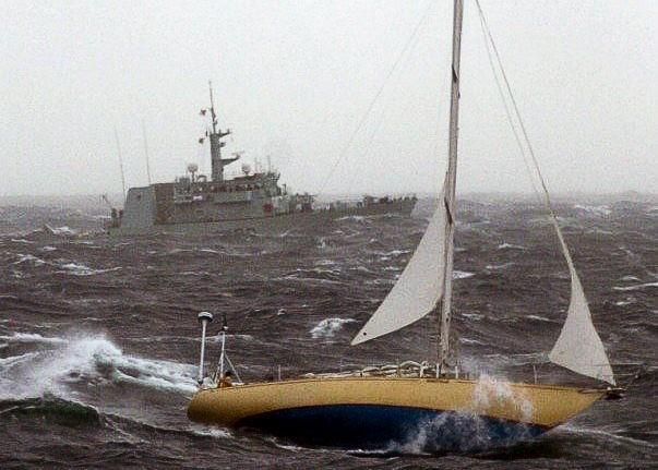

HI, looking for a C&C 41 that will take you around the world?? I'll tell you where you can find one. There is an older version for sale in Canada on Yachtworld. Here is a picture of that same boat sailing in conditions that you will hopefully never encounter! I have no connection to the boat - nothing in this for me. It has a new repower, and the price will save you a lot of $$$'s for the things you need to add.
