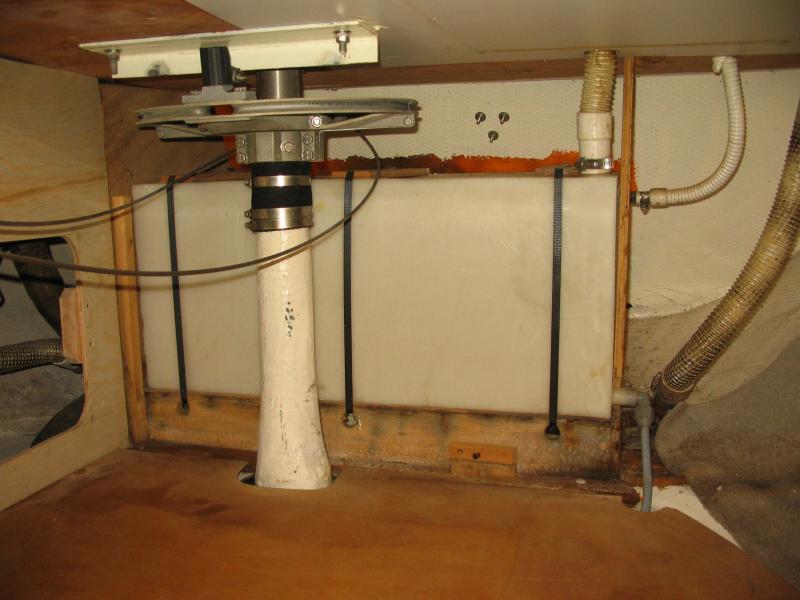

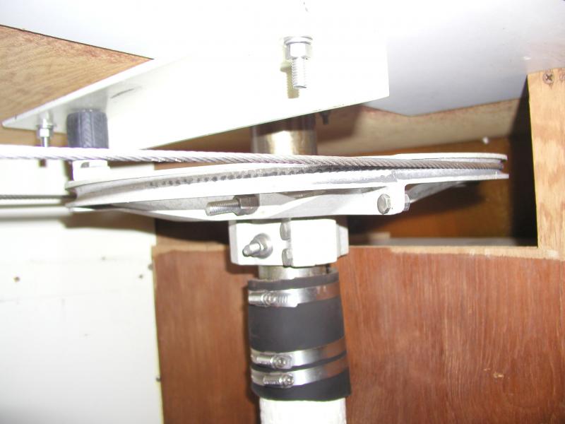

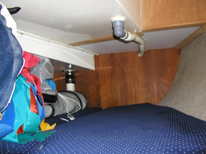

Welcome to the gang of 34 folks, wkuzon.
The tank is immediately behind the port-most panel at the aft end of the aft bunk. I have attached a couple of shots; you can see that the cover over the steering gear has to come off then the panel. You can see the top of the poly tank just aft of the rudder post, in the gap normally hidden by the cover.
While you are playing with the aft tank, best to rebuild/replace the tank selector valve if it hasn't been done yet.
EDIT.. Here is a shot from Claude Auger showing the tank with the cover removed.. I think his 34 has the fill in the bottom of the lazarette, so I don't know if the hoses are correct for your boat..
