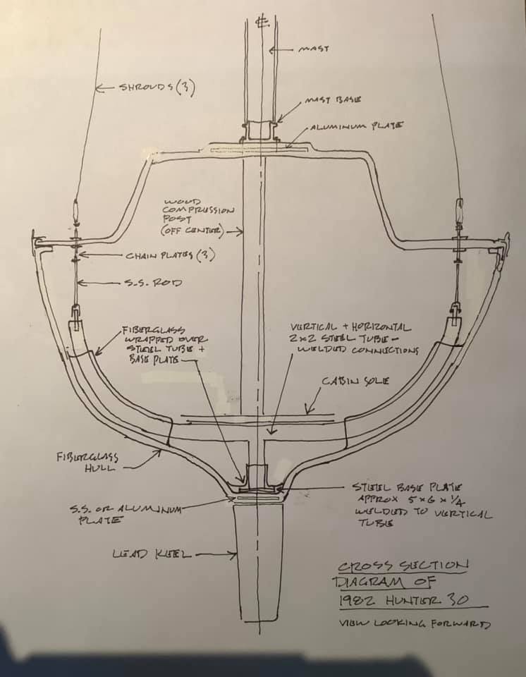

Thank you! Maybe I should have been more specific, but on this "83 Hunter 30, the chain plates on the deck are supported by 3 rods that are inside the boat, and these chain plate rods are supported by a joining "thimble" and then that is attached to some metal "band/beam" that runs down toward the compression plate and up to the starboard side joining in the chain plate rods on that side. This steel "band/beam" has corroded completely from at least the bilge and half way up the port side. I just wonder how in the world this can be repaired???

I didn't take pictures, the surveyor did though and I can share after I get them. But, this is how it was explained to me by someone who is having the same issue: (My issue is in bold italics).
This is what you are dealing with. I have the same on my ‘82 H30. If just the vertical portion in the bilge is rusted out, it’s an easy fix. Cut it out and replace it with an epoxied together stack of 3” x 3” G10 fiberglass blocks. If the horizontal rib is bad, that’s a bigger deal, hard to replace without major surgery, but moving the chainplates out to the toe rail and abandoning the steel tube rib (except for the vertical part) seems to be an option. There has been much discussion about this on the sailboatowners.com forum. Look for posts by Dianna of Burlington, aka John Cherubini Jr, son of the designer of these boats.

I e-mailed Lance and cautioned him about what sounds like a truly ridiculous set-up with this all-metal apparatus connecting all the chainplates together. I've never seen the like of that in a boat of this vintage or price range and I truly don't see any advantage in it. Given a good view of how it looks now, I would redesign an entirely new system relying on fiberglass, not metal. In my experience nothing that's structural metal and involves exposure to bilge water ever lasts very long.
I would need to see good photos of the as-is condition before making any serious recommendations; however (big HOWEVER) I would be very strongly inclined to fabricate something all-new that makes more sense than how the current situation seems.
It appears the poor H30 is suffering another metal-based construction/design disaster, the first being the terribly ill-advised I-beam in the bilge. BOTH of these liabilities can be easily fixed using structural fiberglass and, if done properly, will never give trouble for another 35-40 years easily.
Speaking as one who's been building wooden, composite and fiberglass boats since well before the H30 saw the light of day (and I was actually there when it did), I would not devote any effort to restoring the metallic madness that's there but would rather focus on using better methods and better materials from this point forward.

Seeing the above diagram as well as the H34 chainplate mod linked above, I tend to agree with Dianna of Burlington. Keep unnecessary metals out of the bilge - especially in salt water! I envision chainplates attached to knees and bulkheads as in the H33 (79 - 85?) and H37C.
