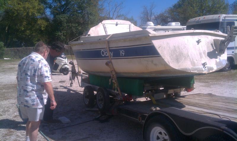

Hello everyone. Glad I found this site as I am sure I am going to have many questions on the quest to save this 80 Oday 19. I am a Navy Vet but this is my first sail boat.
Funny story we got her home around 4:45pm last night and went out to eat then stopped to drop my parents mail off to them and told them what we had been up to all day. They said "was that you about 4:30 we saw a sailboat on a trailer on a trailer backwards on highway 19". Yep that was me. hehe
Is there a site that has the rigging diagrams or any other info? I found the original brocure on here but it is too small to read. Anyone have it in real size PDF or know where to find it?
I have to repair the whole right side from dock damage as someone thought pvcpipe and a little fiberglass mat would solve the problem. There is also a very bad patch on the stern I am going to grind out and redo correctly.
My goal is to get it water tight and motoring so we can enjoy it while I fix it up.
Any info or links on these boats is greatly appriciated.

It took most of the day today scrubbing but the topside, interior and bilge are clean. I used Bleach then Awesome Orange.
Someone has painted part of the topside basically just the cabin to the bow. The rest came out looking real good. I have my work cut out for me on the fiberglass repairs hopefully my Corvette repair days will come back in my head. I need to glue the topside back to the hull in several places then rebuild about 4' of the right side rub rail (after removing all the pvc pipe repair from someone else).
There are some cracks in the keel pocket inside the cabin. Do you think this is from him putting it on the trailer with rollers directly under the keel? Looks like the keel hit the top.
Is there some give with the sail size? I found some local for $50 but I can't find his ad now.
From what I have read they are supposed to be like 24' x 9'

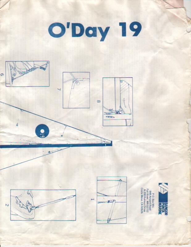

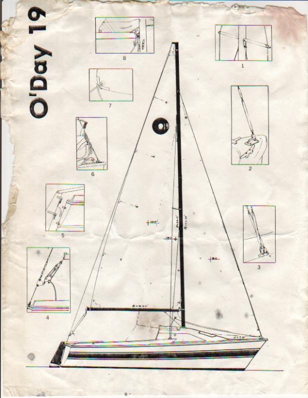

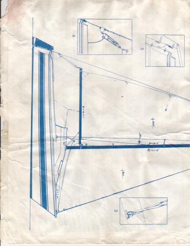

I have copies of the original rigging diagram. I'll attach below. You could also call Rudy Nickerson at D&R Marine (508) 644-3001, he has the actual 2-sided instruction sheet. D&R Marine is a little Pop & Mom shop run by Rudy and his Wife, Debbie, Rudy was the Parts Dept. Manager at O'DAY and now runs his little shop making and selling spare parts for O'DAYs. Worth a call! Also, check out his web site www.drmarine.com however, a phone call is faster than an e-mail and more informative.
I'm in the process of creating a usable WORD version of the O'DAY 19 Manual, I think I've got the text done, but the 11" x 17" Rigging Diagram page is still not copying satisfactorily (I might be able to get one of those copies of the original from Rudy next time I visit.).
