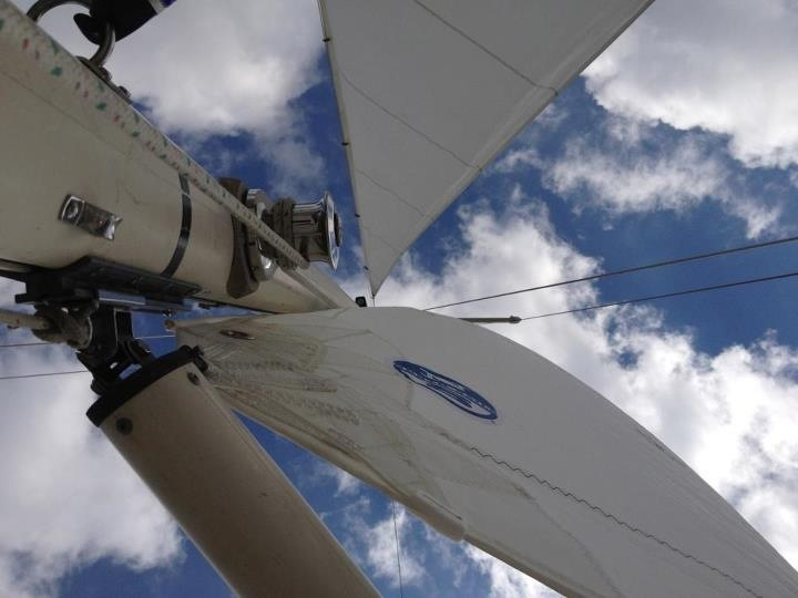

My 23 was the exact same way..... A little mushy under the step too. There were tell-tale cracks underneath in the roof of the cabin as well.
I pulled all the bolts, upsized 1/16 in size. The hidden one was a lag bolt so I upsized that by 1/8" in dia. Let me backup a bit... I was going to cut the deck up and replace the core etc.... someone had previously messed that job up so it would have been out of my scope of handiness. So, I pressed some thinned epoxy into the gap left, redrilled, and mounted a Prop or compression rod. ( I've found there are a few names for this little mod).
So, here are some pics of the finished product...... works perfectly!!!!!!!
