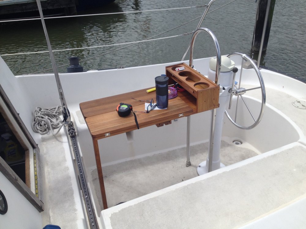

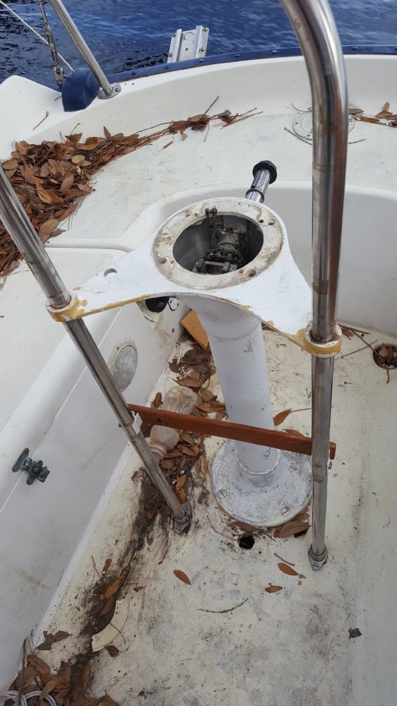

Last winter I connected with a Floridian Gentleman that was scrapping/parting out his 1978 H30 due to storm damage. Actually the connection was initially made on this forum. He insisted that the pedestal system he had was Edson. I assumed mine was too, because our boats looked identical. When the components arrived I cleaned and painted the bracket and polished the guard tubing, drilled and retapped the tubing base anchor set screws. Two weeks ago I installed the bracket and guard (easy peasy) above the control lever housing with only needing to make a slight bend in the speed control lever so it wouldn’t hit the guard support bracket. The original setup looked like this during dismantle.

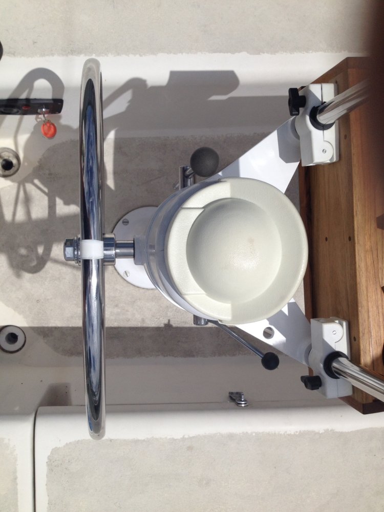

After the images provided in previous contributions from you and @Roland5048 commentary I now know my pedestal is a YS. I believe the round pedestal base may be the best clue. Regardless, I also believe that Edson and YS are interchangeable with respect to the guard and bracket. Perhaps the Floridian was also mistaken. Our completed project looks like this.
If you need dimensions, please let me know. I’ll be at the boat this next Sunday.

blowmeaway thank you very much your pedestal is identical to mine and what you did is exactly what I want to do..great info..did you use the 12" guard or the 9 1/4"?
Honestly I’m not sure, but thinking it’s more like 14-16” wide. The removable clamps on the table are placed to the appropriate width when you install that. So the table will fit any guard with two down tubes. The table actually comes shipped with two sized rubber grippers for 7/8” and 1” tubing. I’ll measure the span of my guard on Sunday and anything else you need. I’m also thinking the 12” span may work better for you, since the bracket would be narrower than mine and not cause issues with the motor speed control lever (aka throttle lever, I got schooled recently here on SBO about Diesel engine controls).
I’ve attached a pic that you might be able to scale if you’re in a hurry.

looks great.. i got ahead of my self I already got the exact table you installed. the pedestal gaurd is the only thing holding me up.. I will let you know if I need more measurements thanks again..
