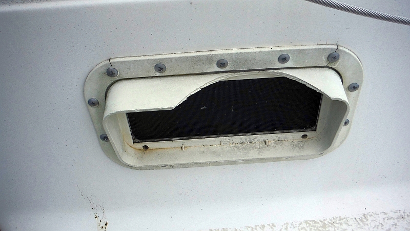

I have a fairly dangerous issue with one of my starboard port lights. We apparently had some unwelcomed visitors on our boat while it's on the hard this winter. Just a week or so ago I found this damage to the cowling on the most forward port light, which appears that someone had actually stepped on the cowling and fractured it in its brittle frozenness. Now it's a razor sharp shin serrator. Since discovering this, I'm actually toying with the idea of replacing all four of the port lights with more flush mounted ports, and getting rid of the cowlings altogether.

You can cut the "cowl" off flush or almost flush with the trim ring to get rid of that protrusion.. Use a "multitool" very carefully and then sand the protrusion with a block sander or a palm sander and you'll be surprised at how fine the result is. Put a thin line of tape (1/4"" maybe) around with one side flush to the trim ring then use the outside edge as a guide for the multitool vibrating saw blade.

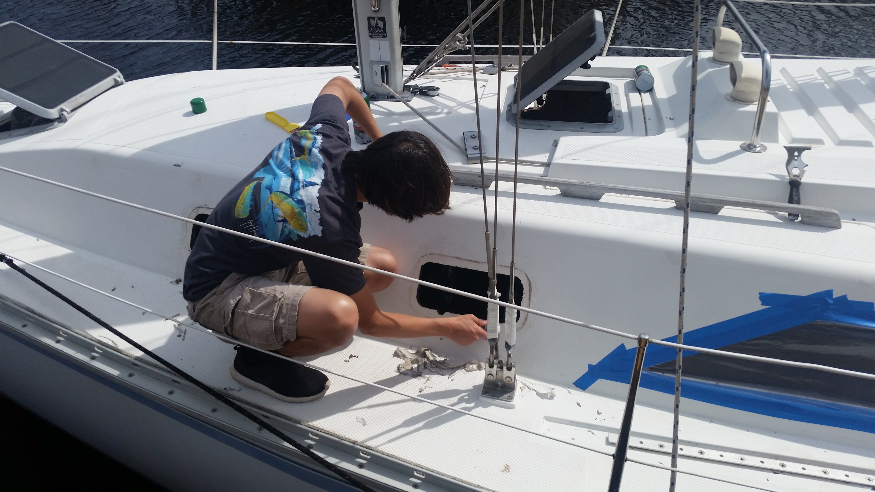

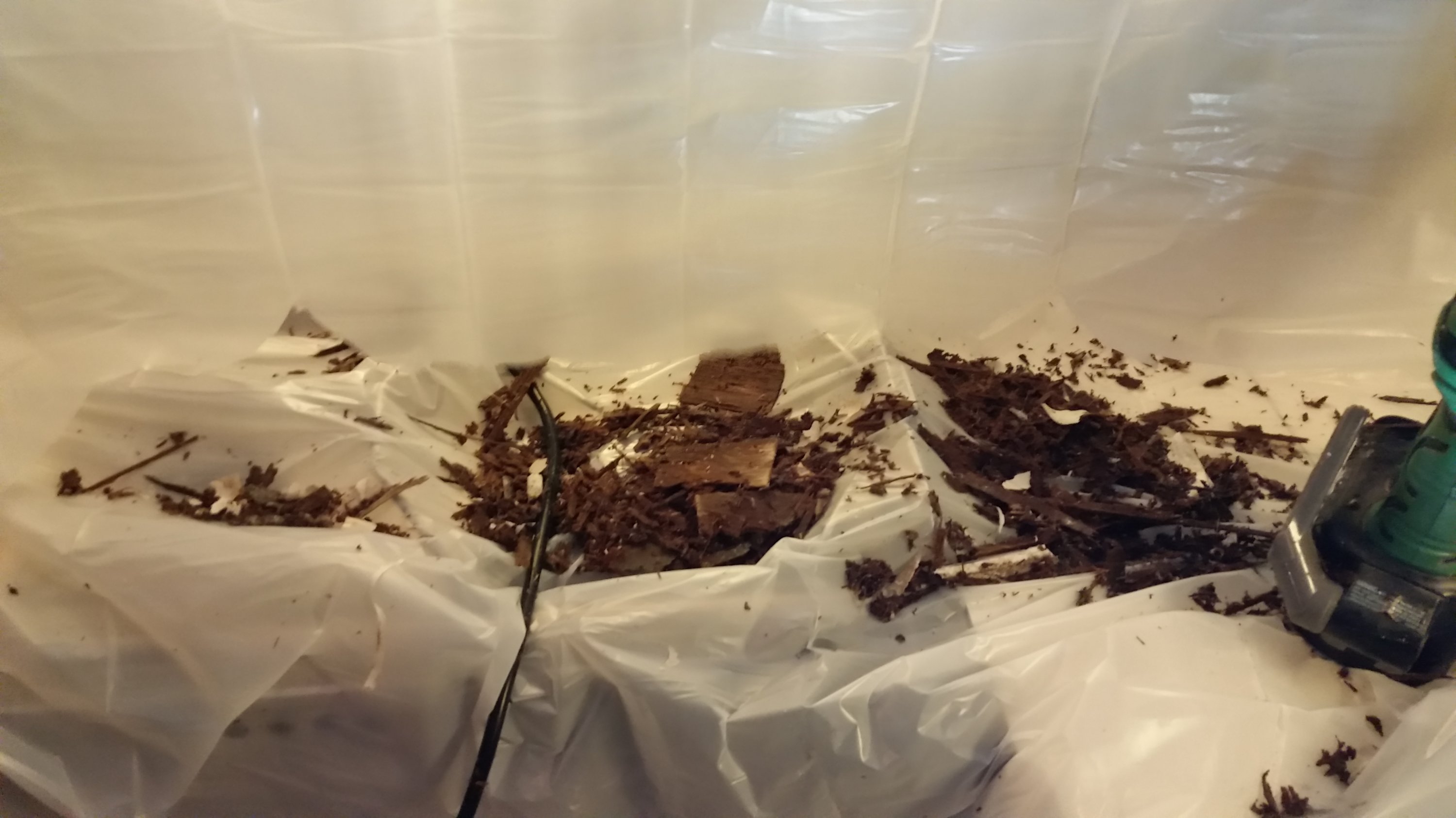

I decided to replace with the same Gray 512s My son Helped clean the old openings

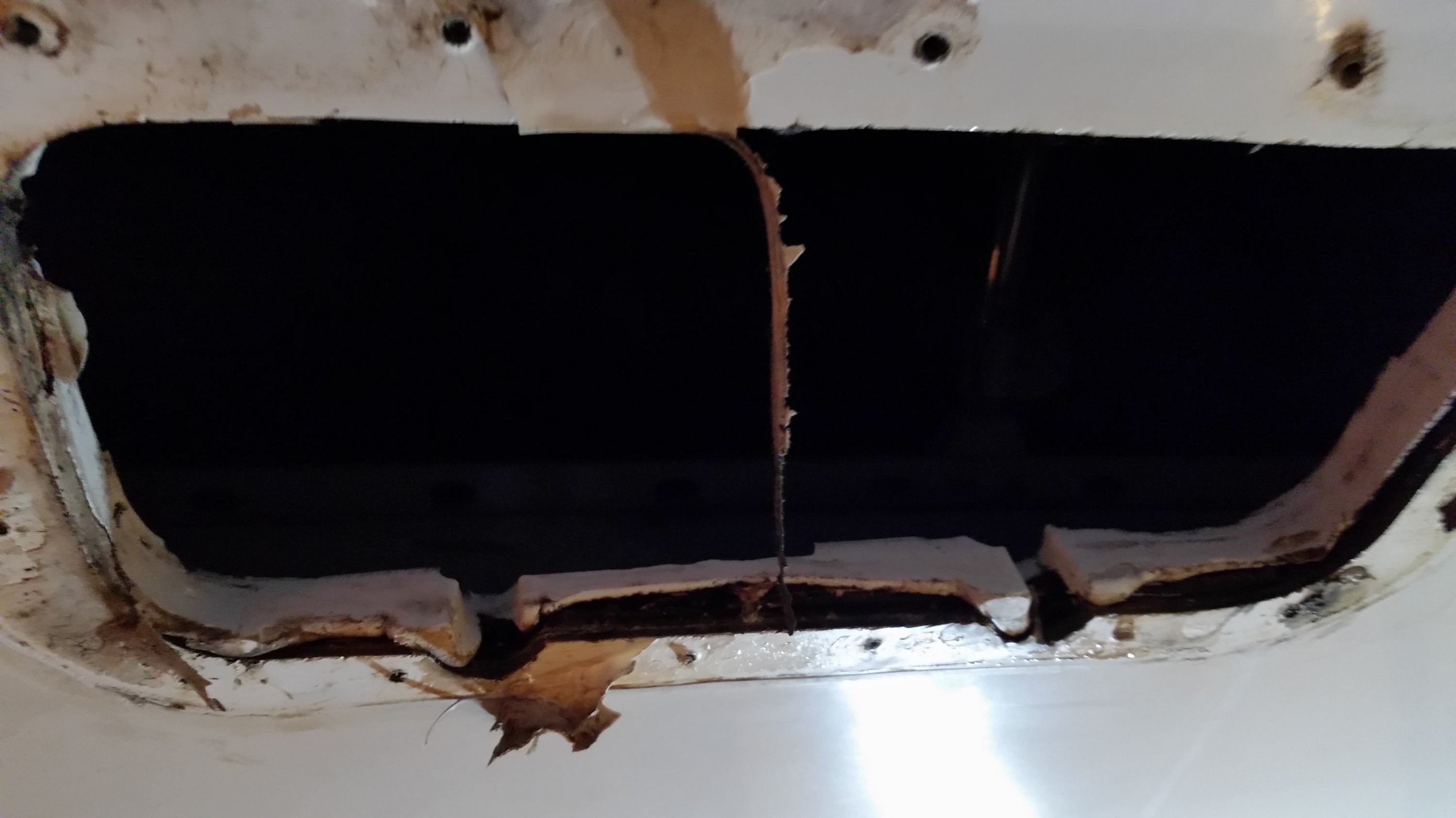

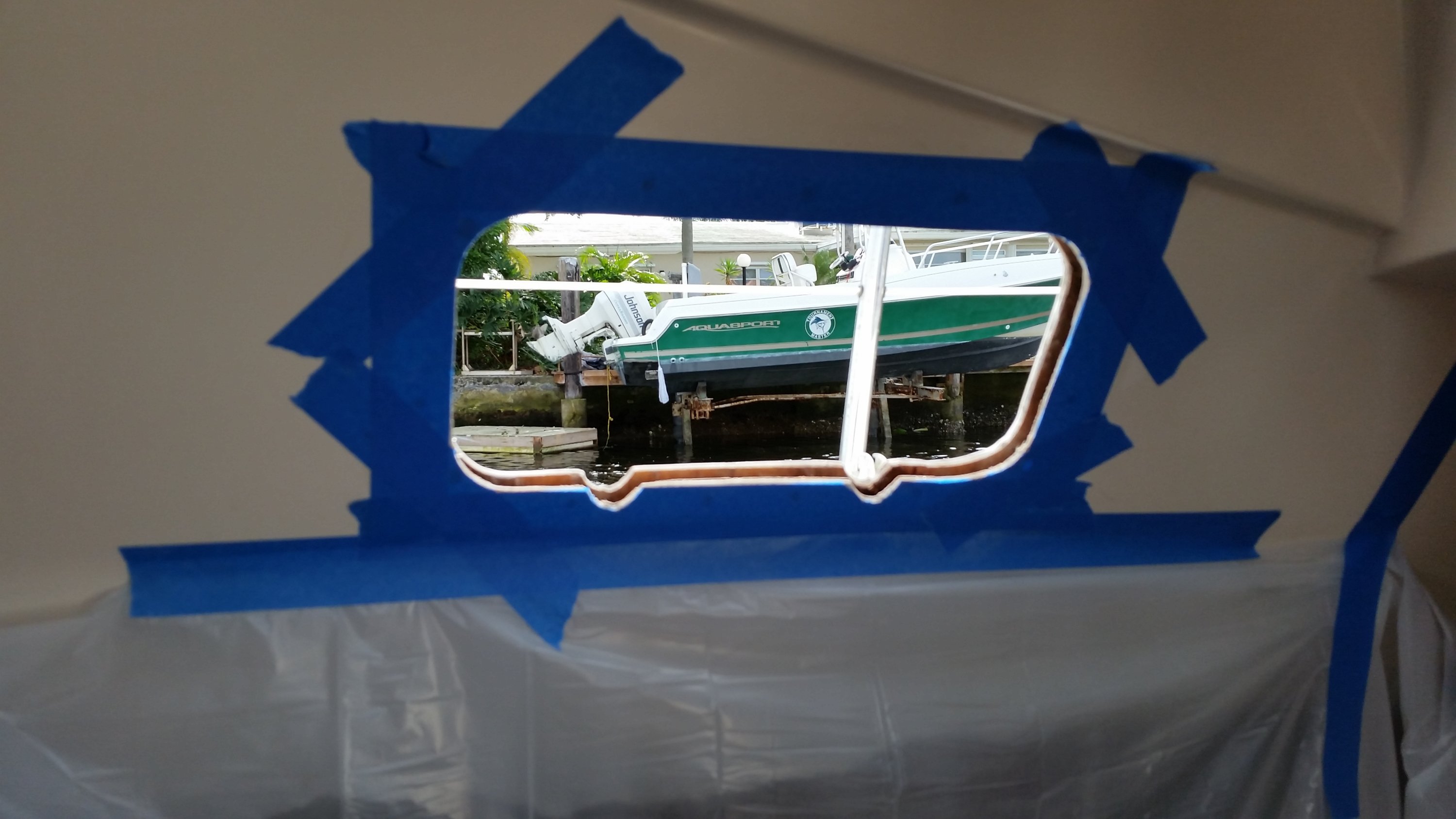

I had to hog out a lot of Soggy core directly around the openings.

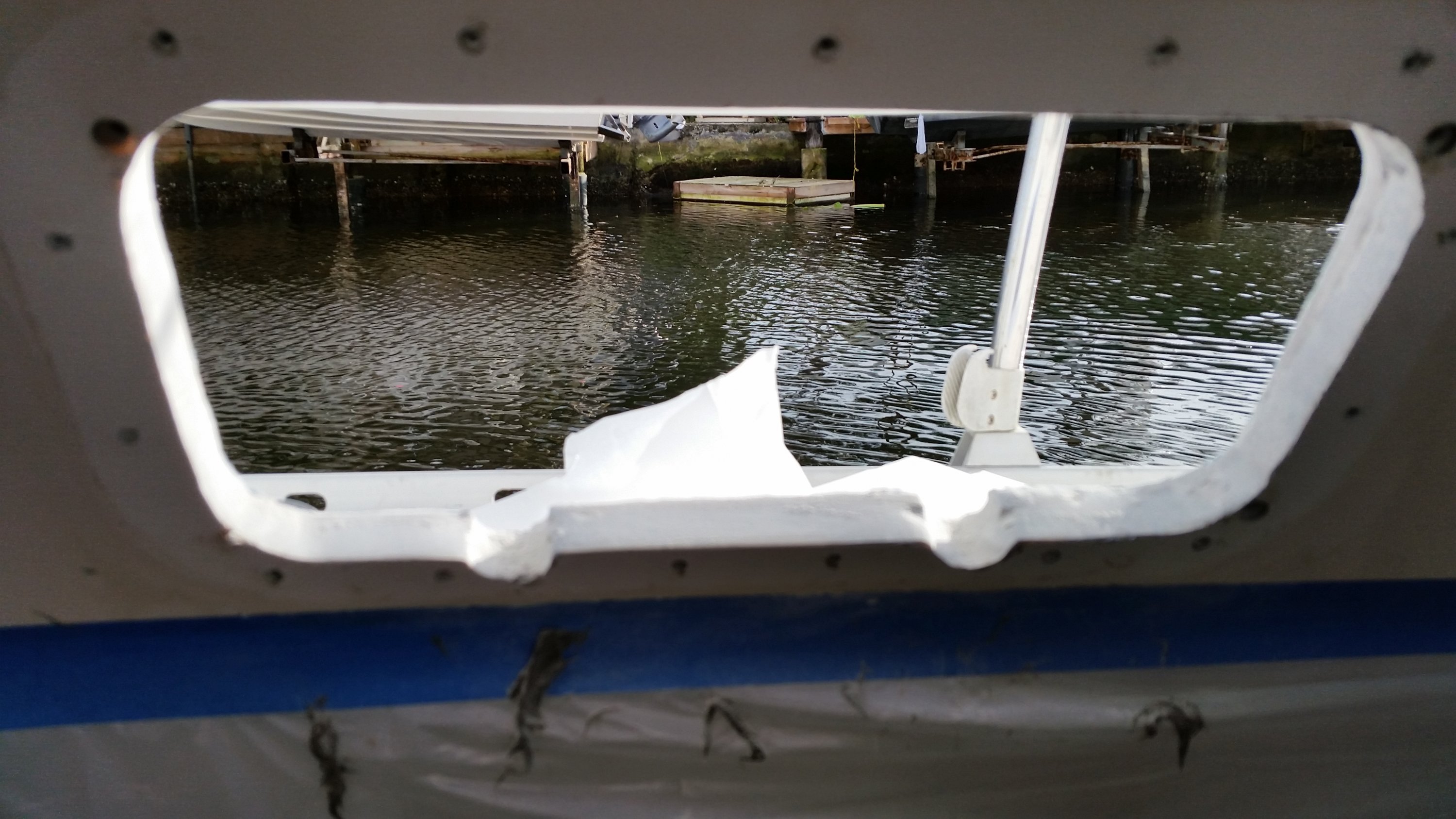

I then refilled the clean gaps
With BondoGlass covered with epoxy

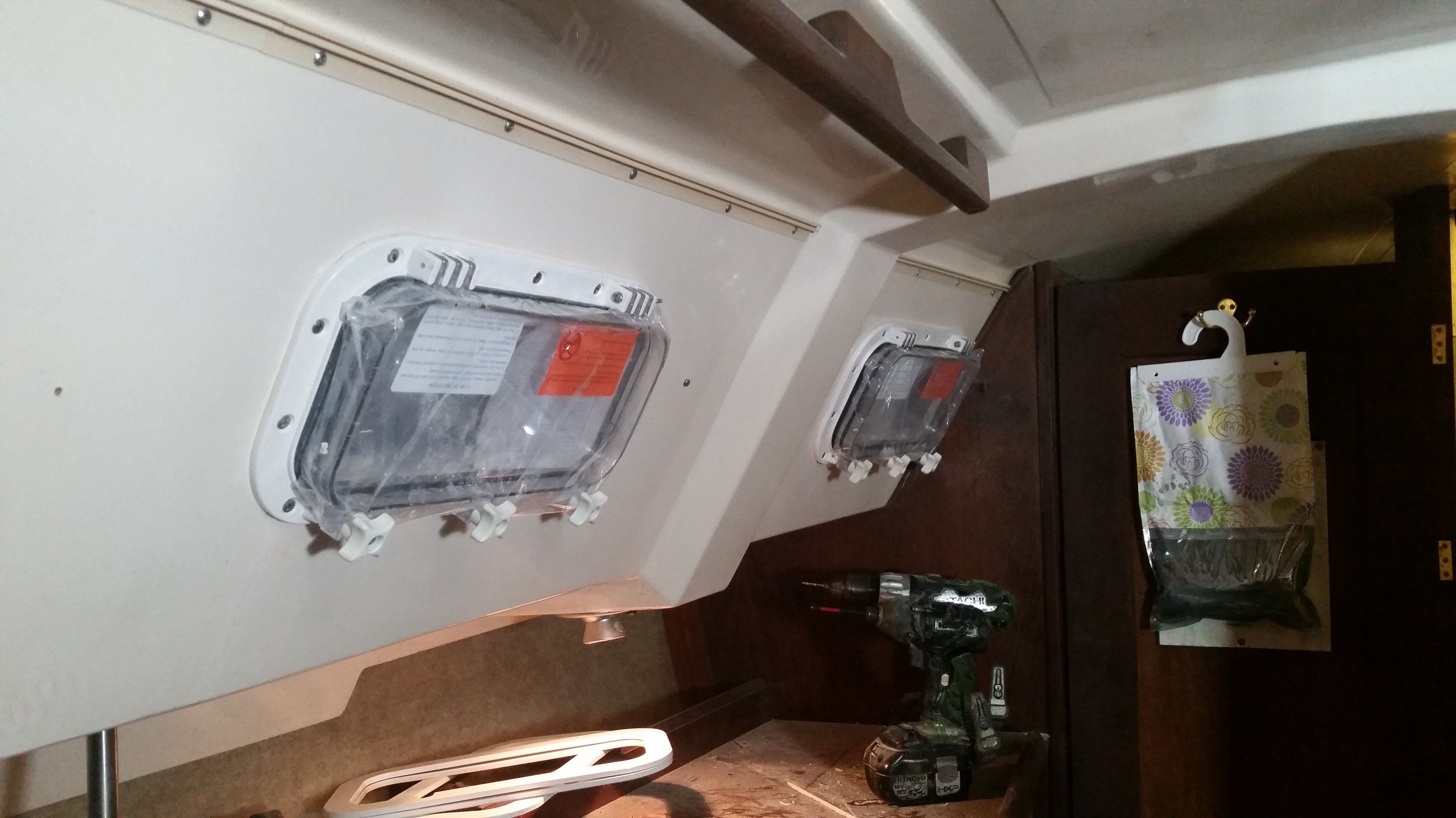

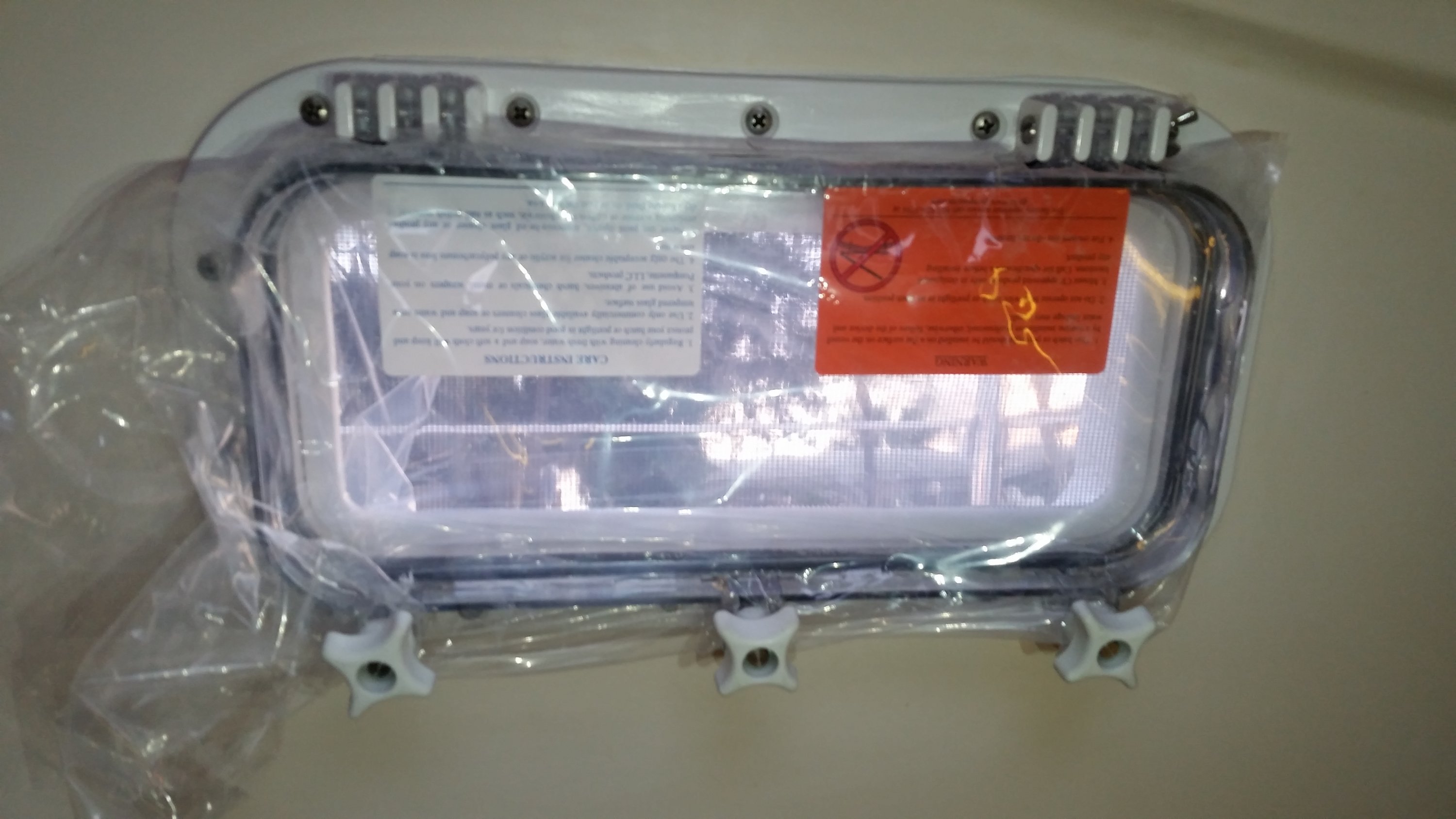

Reinstalled the New Ports
They turned out great. Good Luck

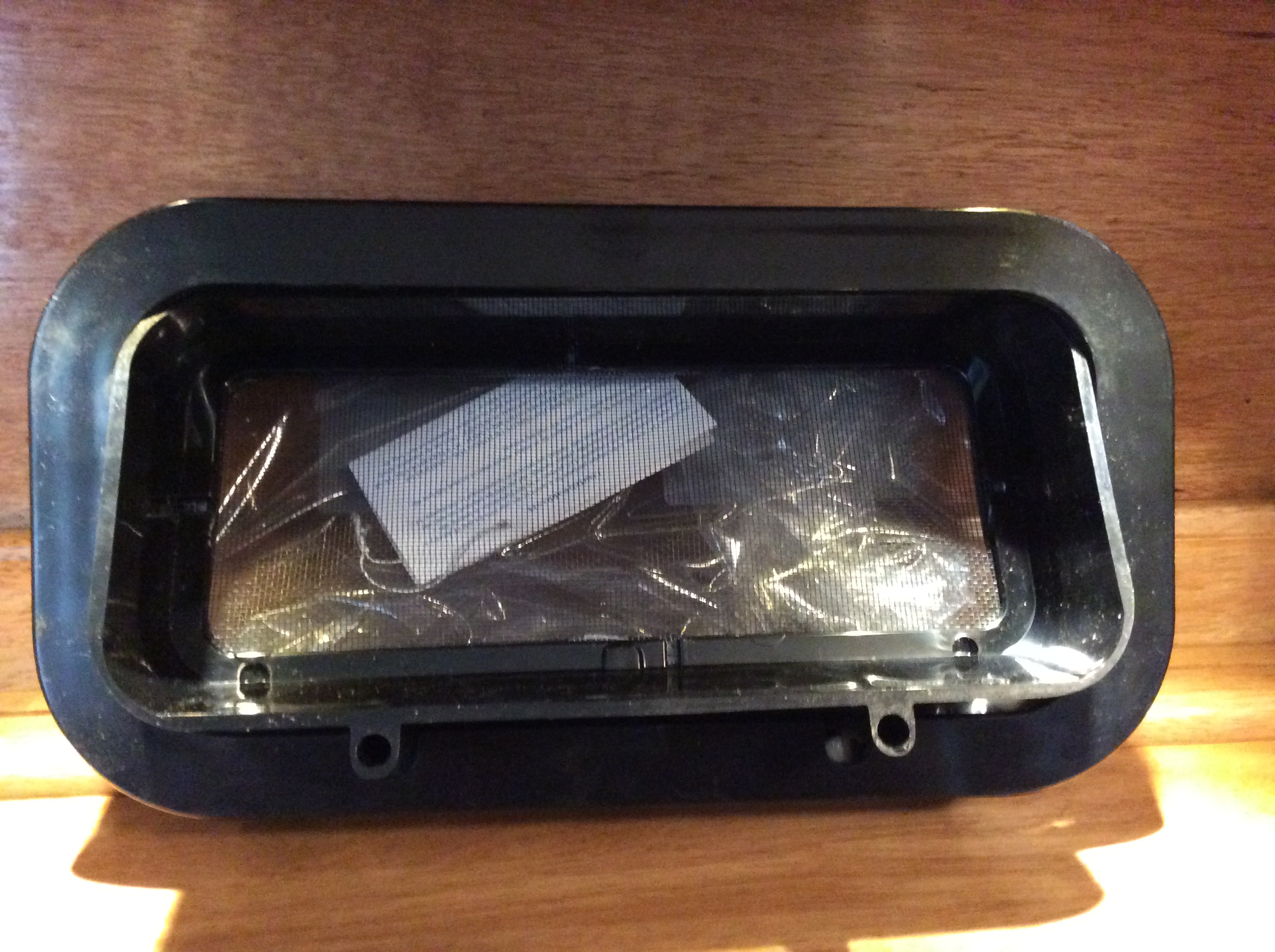

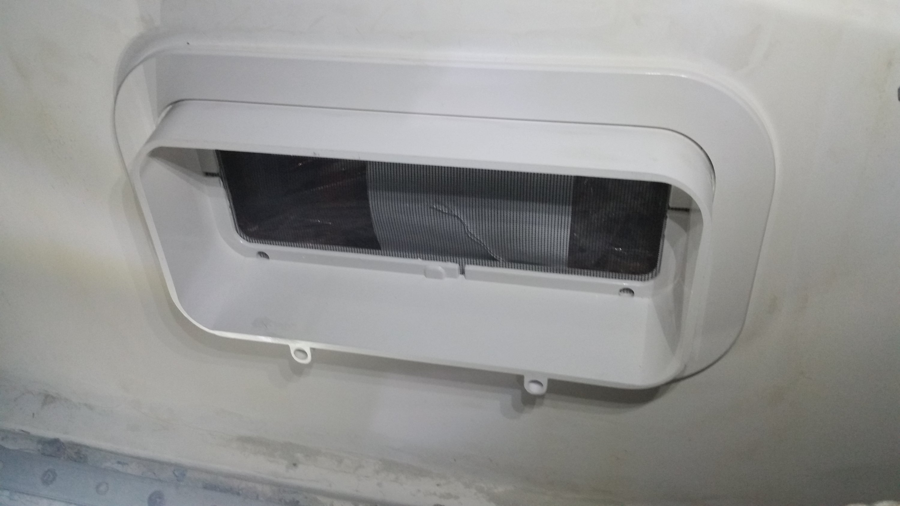

G'dafternoon folks, my port lights arrived a week or so ago and I'm thrilled with how they look. I do have one question regarding the external frame mounting. What adhesive have you applied to anchor and seal that frame. My old/original port lights had screws (which in retrospect I hate).
Pateco's installation looks like this (lovin' it):
My new ports are gonna look like this, grateful for no counter sunk screw holes. I want the nice clean look too.
Yes, we're doing black, in my mind the contrast will be awesome and match up with the Jacobean stain on the deck teak, black mainsail cover, jib bag, and lines.
Just need your input on a good adhesive/sealant for these frames.
Thanks...Wayner
Likes: 51RD55

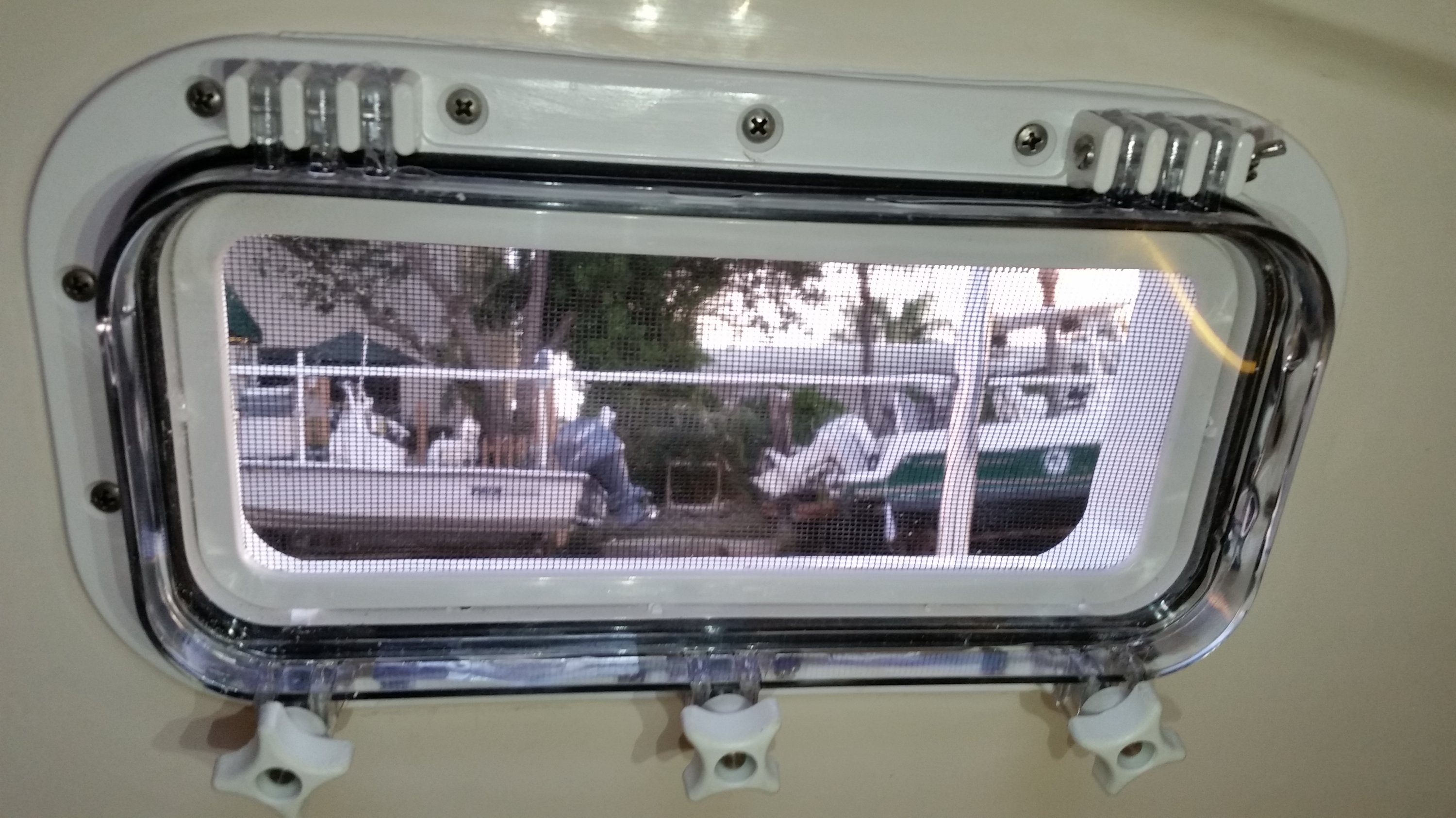

The frame is actually held in with screws from the inside.
For sealing the ports, and adhering the outside trim rings (they have no structural purpose, they just neaten up the install so you don't see all of the sealant around the port). I used DOW 795 on most of them, and then 3M 4000 on the last 2 when I ran out of 795 on a Sunday, and couldn't get it locally.

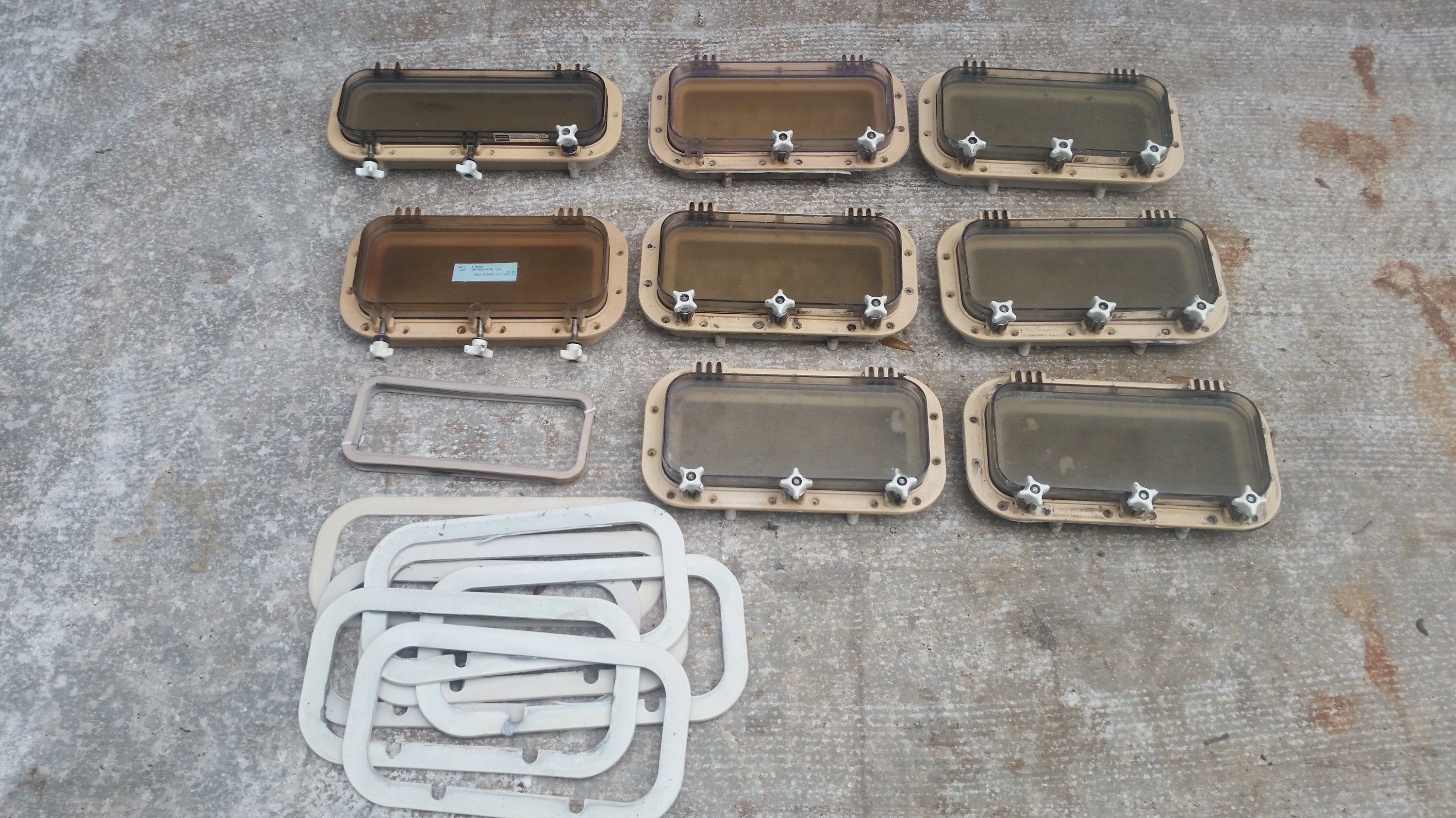

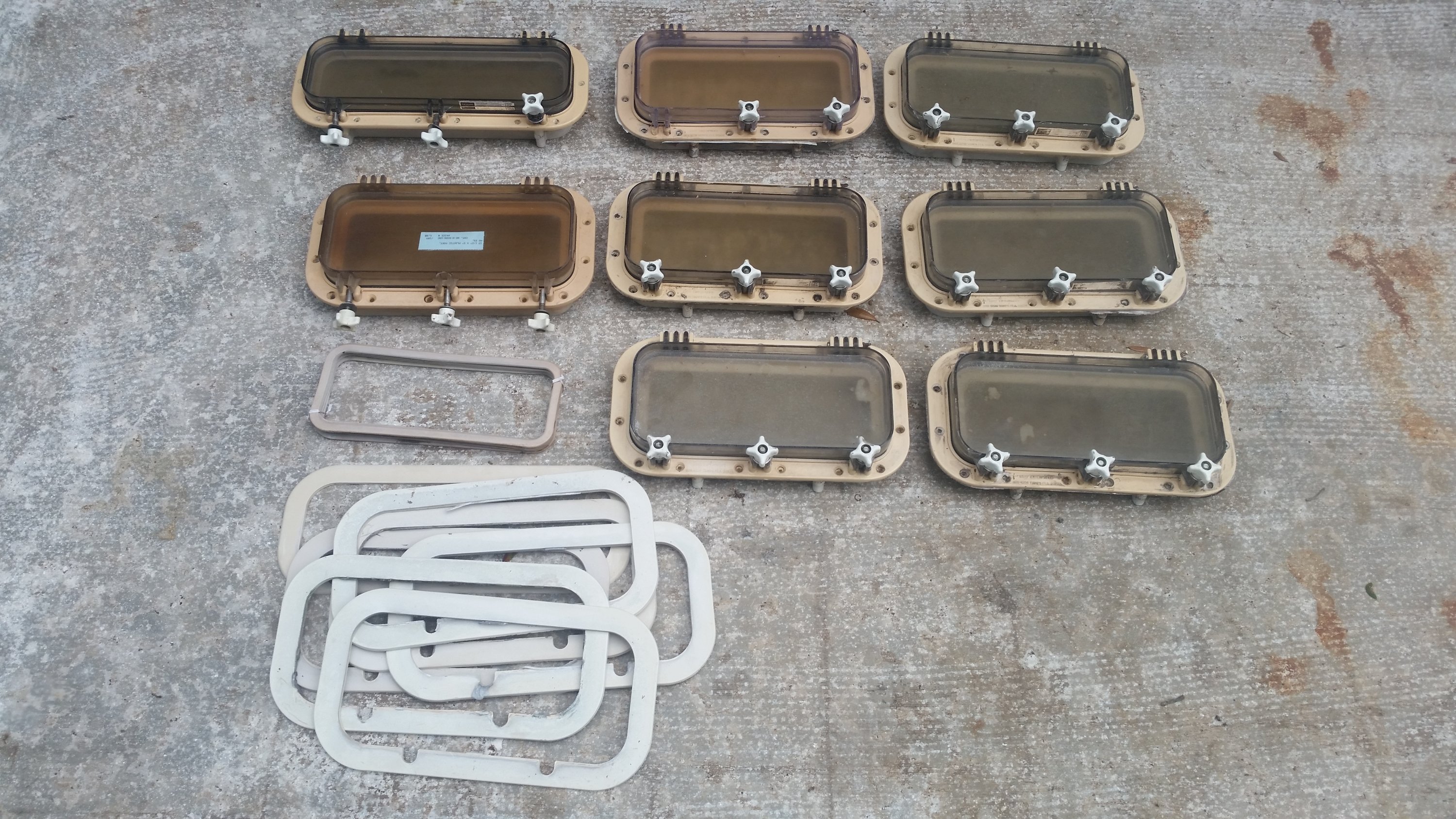

PS: the old ports are available in the classified portion of this site for anyone who needs spare parts or replacements . FOR SALE: Used Gray Enterprise 512 and 414 Ports
