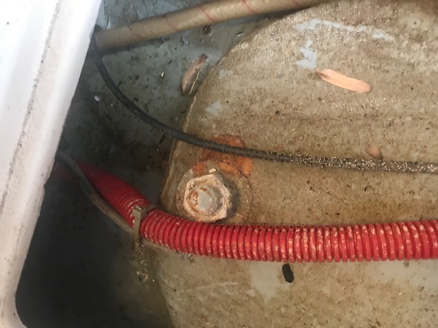

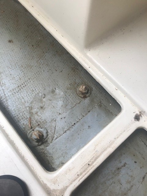

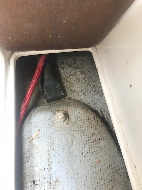

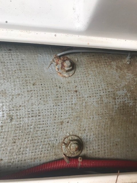

Good evening, here are pics of keel bolts. Please let me know what you think. I am interested in getting this boat; Hull 1433. Thanks for your help

Ask the owner if you can back off the nuts to inspect the tops of the bolts. One at a time of course. It will be obvious if there is any crevice corrosion.
