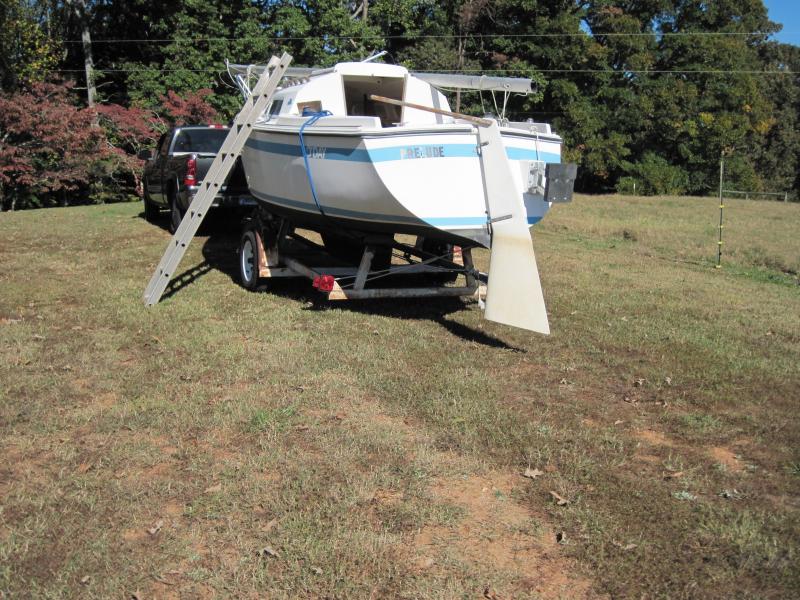

Oday 22 Carrollton, GA in my driveway.
Another new boat owner. With questions. My wife and I decided to quit buying gas for the gas sucking power boat and go with the flow. So we sold it with the old camper and bought the O'day. Ah camping and sailing. :D
I have a few new items bought for the last boat I want to install, I have a GPS/depth finder that I would like to mount on the deck to the right of the companion way. I'm not sure if that would get in the way of anything. Second what is the best location to mount transducer to shoot thru hull?

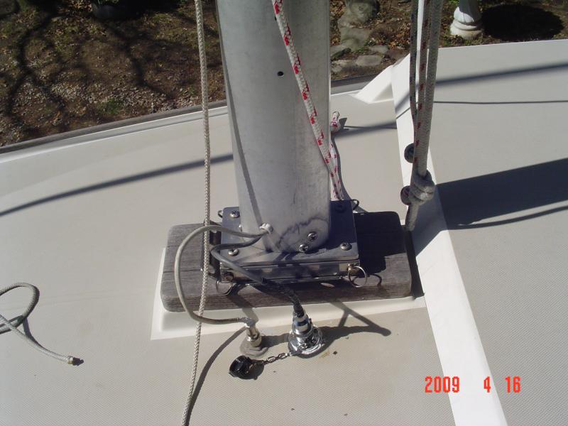

I'm mounting a VHF and a AM/FM radio and not sure of the best way to run antenna wire from outside into cabin. I have a 8' fiberglass antenna and would like to mount it to the mast with a Windex also if possible. How well does the signal splitter VHF- AM/FM to antenna work? Or I'm I better off going with two antennas?
I also have new bilge pump that I want to install, whats the best location for this? Stern? Or in the sump above the keel?
I need a outboard for it also any recommendations as to the size/HP, whats to small whats to large?
I have one more question about the mast mounting to the hinged plate, but I will need to take a few pictures to explain.
Lots more questions I'm sure.
Thanks

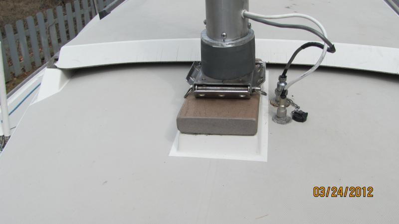

I drilled a hole near the mast and used one of those water-tight thru-deck cable mounts. If you can drill in the center of the mast mount you wont have any exposed wires on deck.

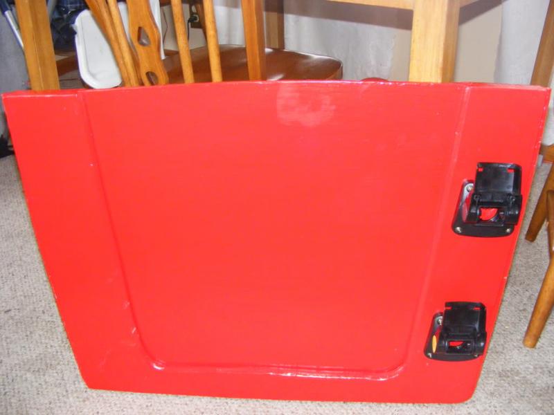

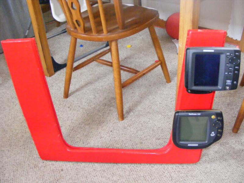

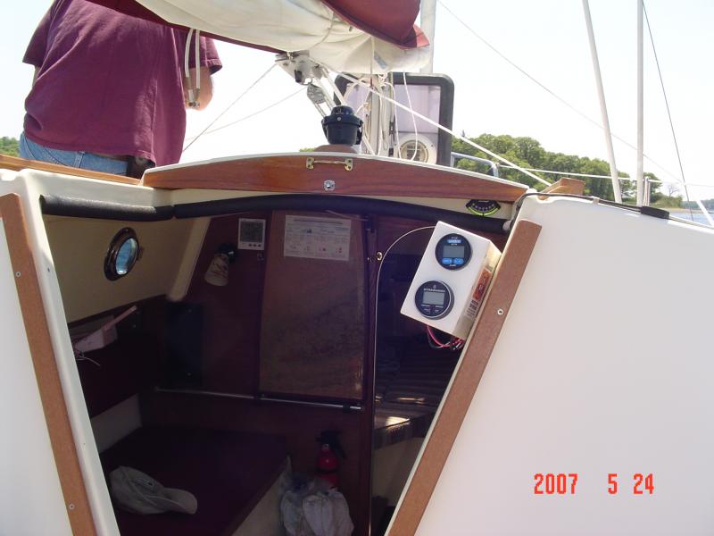

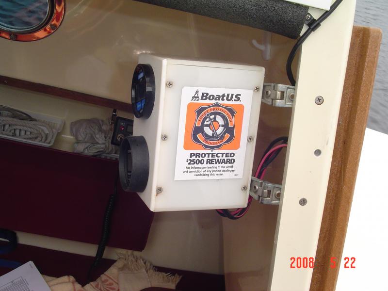

Just wanted to share the pics below of former O'Day 23 owner Dave's companionway board mod. Can be flipped inside for use of the instrument when below. Really great idea for a boat with a wide companionway.

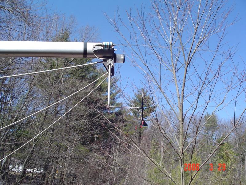

I would mount a Shakespeare Stubby antenna on the side of the mast up top and mount a 12 extension bracket pointing aft for a 10" Davis windex.
Install a thru-hull coaxial fitting in the cabin top next to your mast tabernacle for the antenna coax. Buy the screw on cap for it when you buy the fitting.
I like to lean against the back of the house and stretch my legs out on the cockpit bench so I don't mount anything there.
That's clever.

That is a great idea for your round instruments. Is the box home built? Did you use a standard hinge? I may try that on my boat.

Those two pics showing the box are of Wayne's Seaward 22. I'm not sure about the hinges he used but he made the box out of HDPE or StarBoard. Another material that can be used is PVC Trim board.

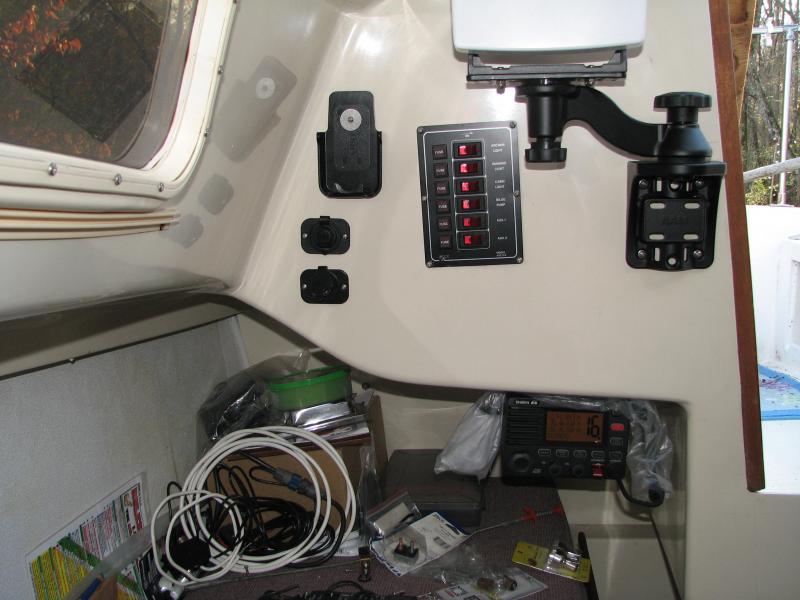

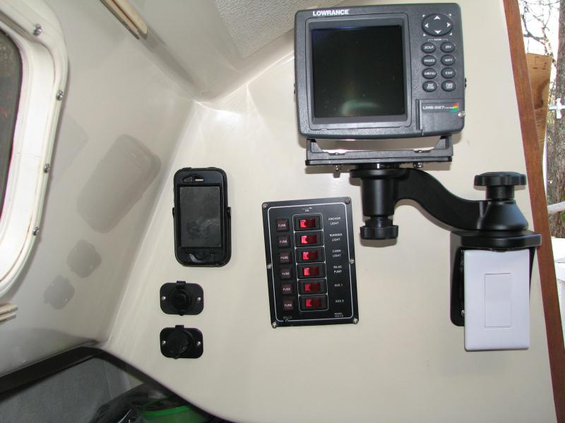

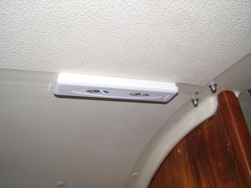

I installed one 12 volt and one USB power charging sockets . I mounted my VHF and a GPS/Chartplotter with a ram mount. The ram mount swings around to face the cockpit. I replaced the bulbs in the cabin lights with red LED's. I like to fish at night and I am thinking it will help with my night vision. I bought two sets of lights. Each set of lights came with two lights with two LED's and a wireless switch. I installed one LED light over head and under the port holes facing down lighting the the two seats/bed in the cabin and one in the V berth area. They really light up the cabin. So I mounted one switch inside the companionway and the other in the V berth, so I can enter turn on lights and turn off lights off from the V berth or the reverse. Each LED light has a three position switch on off and RF. They work on AA batteries. Bought some Wax Cleaner and found with a little rubbing the chalky gel coat cleaned up real nice (much more to on that). Pictures explain themselves. Last picture is a used stern rail I installed, also have a swim ladder to mount.
