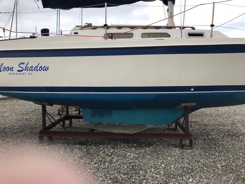

Here's a pic showing the location of the thru hull in the boot stripe. Enough above the water line to not be an issue. Be sure to double clamp the hose.
Now the galley sink drain definitely needs a seacock as that thru hull is below the waterline.
And, if it is a gate valve, replace it before putting the boat in the water. My 1980 25 had a gate valve. They saved it for me when I had the yard replace it with a quarter turn valve. The "gate" had completely disintegrated rendering it useless.
