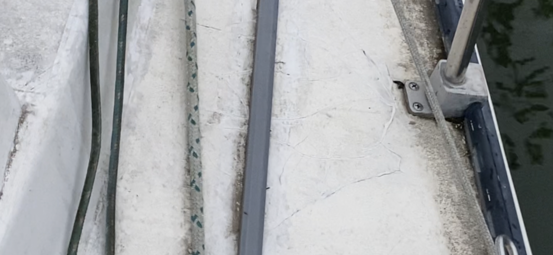

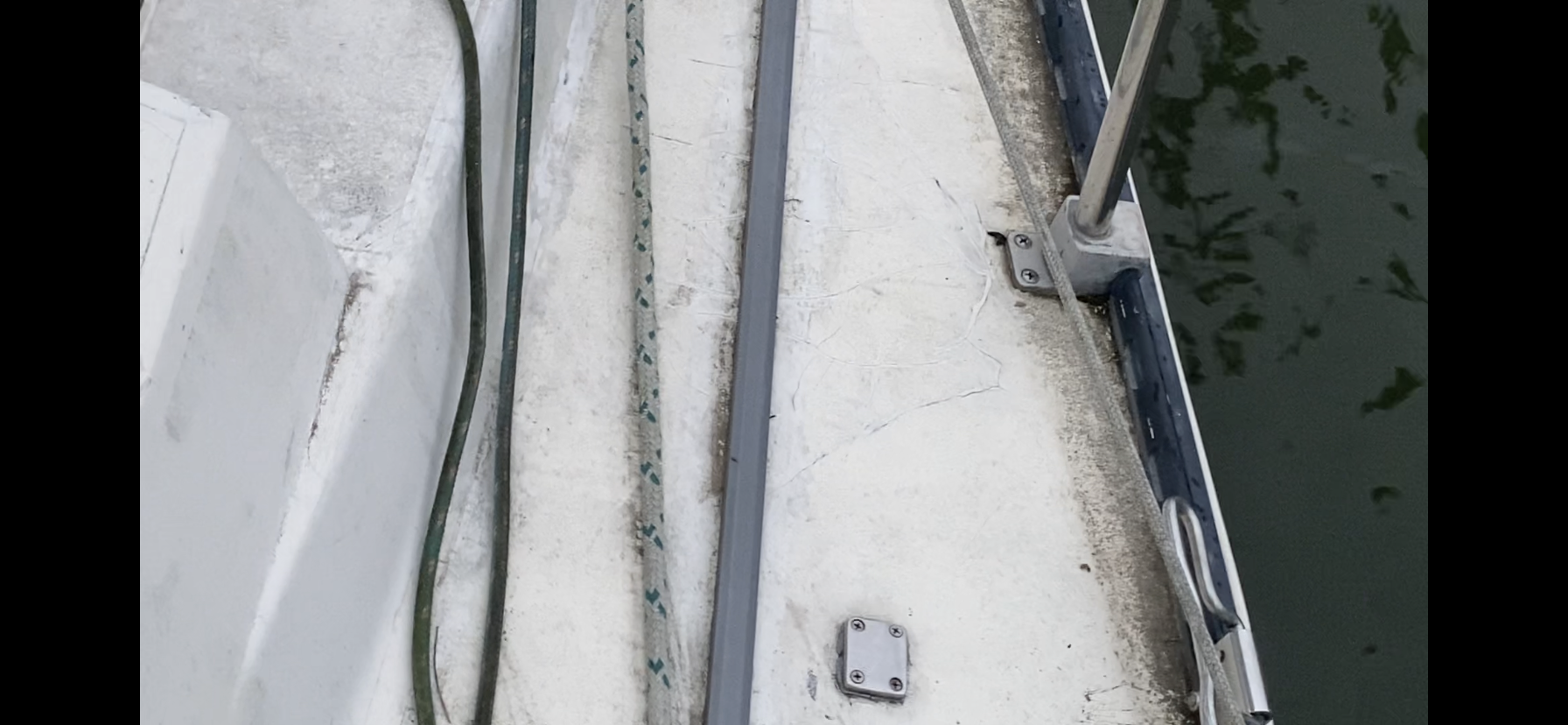

I did a 10 minute sounding test on the deck yesterday. It sounded nice and sharp, high pitched with one area excepted... That area is on the narrow deck area outside of the coaming upstand, and above the portside quarter berth. It looks to me like a repair that didnt go quite far enough and has allowed moisture in over time. Below there are also traces of slight discoloration on the gelcoat which wipe off. So pending the haul out and hull, rudder and fin keel inspection (soon) I'm feeling pretty good about taking this forward. I guess that area would be a cut and replace core job, pending confirmation with a marine survey. The damaged area is a little over 1 sf and is where the dull sound occurred. (See pic looking aft.) so this would be a part of the new deck repair/restore/gel oat etc.

May be the result of leaking fasteners under the track.. That one willl have to be lifted for the repair, so once ya see that one's attachments, then re bed the other one as well.. Bed It Butyl tape is the ticket for that.
Thanks for that link, very helpful. We are leaning toward removal of most/all deck fastened components so the deck can be worked on, repaired, painted then rebedding and installing components.

Those cracks look a lot more serious than anything in your other photos. It looks as if the core has disintegrated to the point that the top laminate is also failing. It may be a trick of the camera, but it also looks like that stanchion base is breaking through the laminate, which may be where it started. Definitely plan to re-core this section.
Likes: Dnea

I agree.
This is the most compromised area. Its not good but seems very localized.
Thanks for your input.
