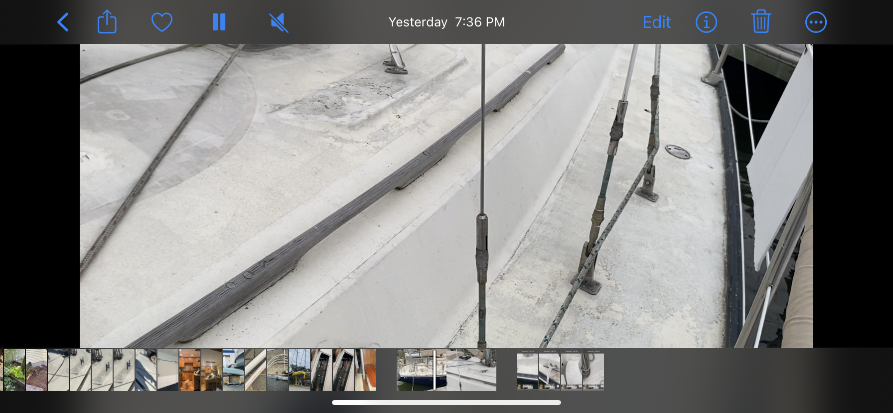

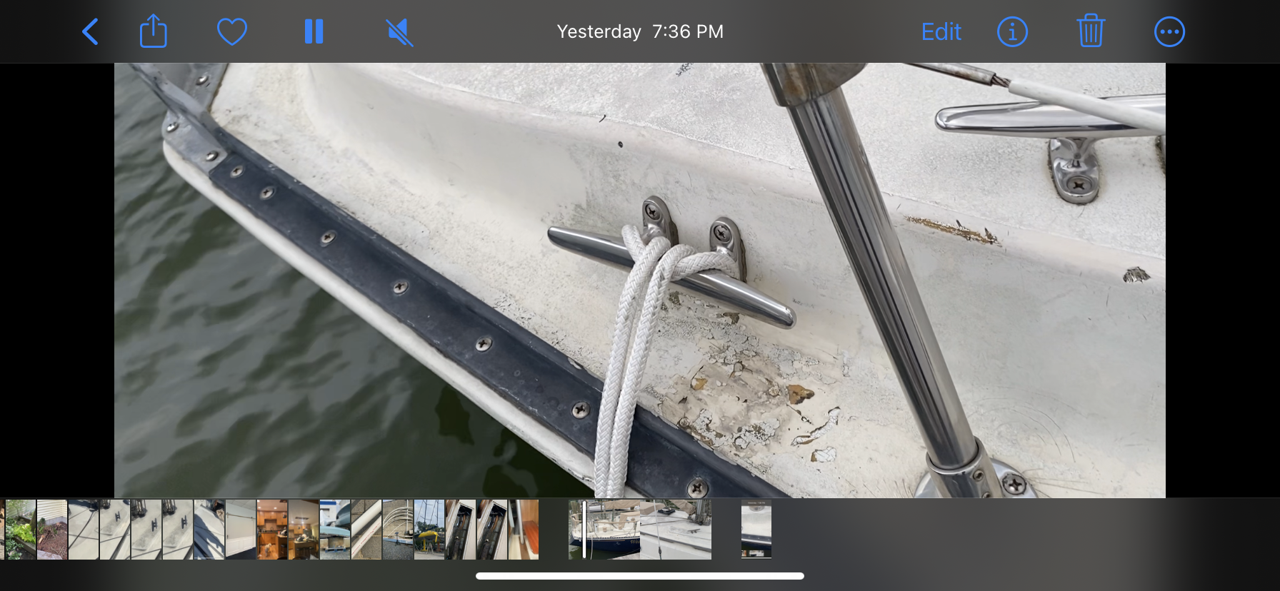

I know it needs a lot of work and not quite sure of the scope or what the best options are. I want to do it right, I am in no hurry and will do the work myself.
Btw the deck is not soft, and doesnt appear to be leaking anywhere. The cabin does not smell like water damage.

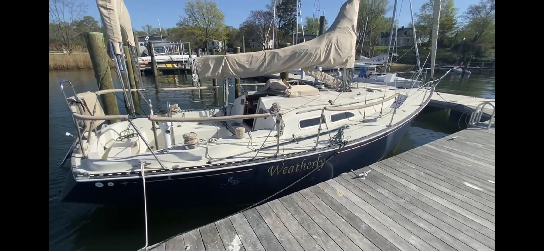

From what you show in the images, I would guess a previous owner (PO) had deck cracks or damage and did a minimum patch to get the boat sailing. On a boat that is 48 years old that is not a surprise.
I suggest you start watching some YouTube videos from BoatworksToday. Andy provides a good "How To" on fiberglass and deck repair.
I would be more questionable of the basic infrastructure and boat layout before shelling out money to buy it.

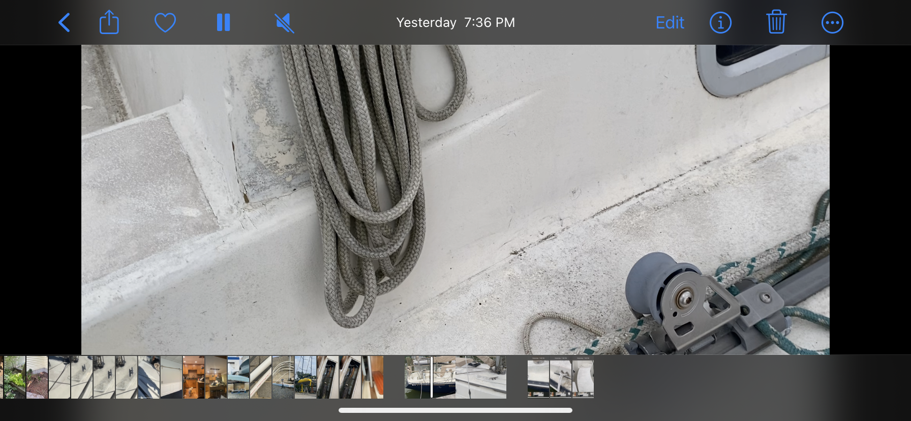

Not sure what your question is ... can't even tell if you are considering this for purchase or if you already own. There is a lot of grunge on the deck surfaces. I can't tell if it is peeling paint or damaged gelcoat. It looks like it might be a combination of both. I guess I would start by removing as much dirt and loose material as possible by just about any aggressive means. What are your intentions with this boat?

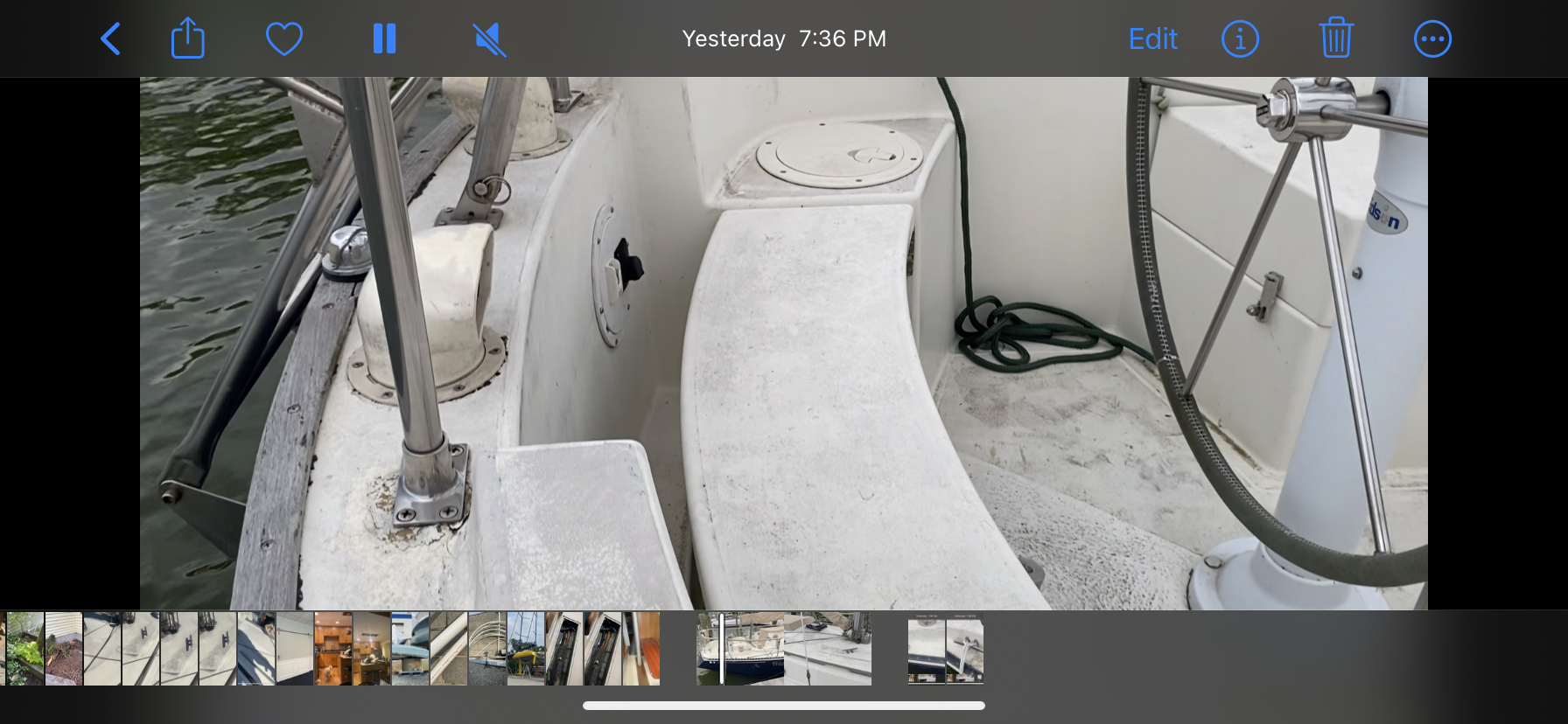

Looks like anti skid paint was applied to the side decks and the pads on either side of the mast. The first step I think, would be to pressure wash the whole deck and cabin top being very careful to not hit any caulking around bedded items of deck hardware, like fixed ports, cleats, etc. I think that the anti skid could be hit hard and mostly removed with a pressure washer.. I have found that the little electric ones (Light Duty Pressure Washers - Harbor Freight Tools , or Sun Joe 1600 PSI Max 1.45 GPM 11 Amp Cold Water 4-Wheeled Electric Pressure Washer SPX3160 - The Home Depot ) Not endorsing, but they are good for boat cleaning. After an aggressive hit on the peeling stuff, you'd have a better idea of how to paint the deck and coach roof. Prolly the "roll and tip" method with a good paint would get her in top looking shape.. Not a trivial project.

It looks like a lot of surficial damages or neglect that may not be so bad to recover. It's a good sign if interior rot doesn't appear to be significant. I would plan on expenses for replacing standing rigging and hardware for sure. But the winches look like they have been protected, only a few stanchion bases look like they might be compromised. For a project, it looks like it might be a pretty good candidate! Are you going to order a survey?

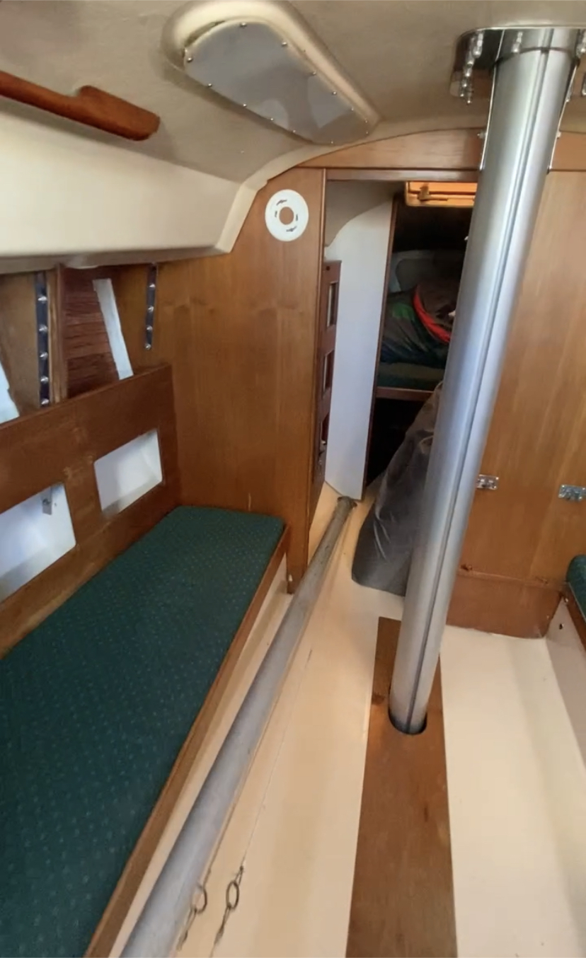

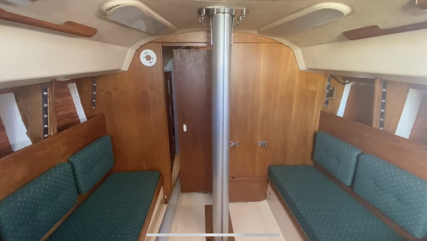

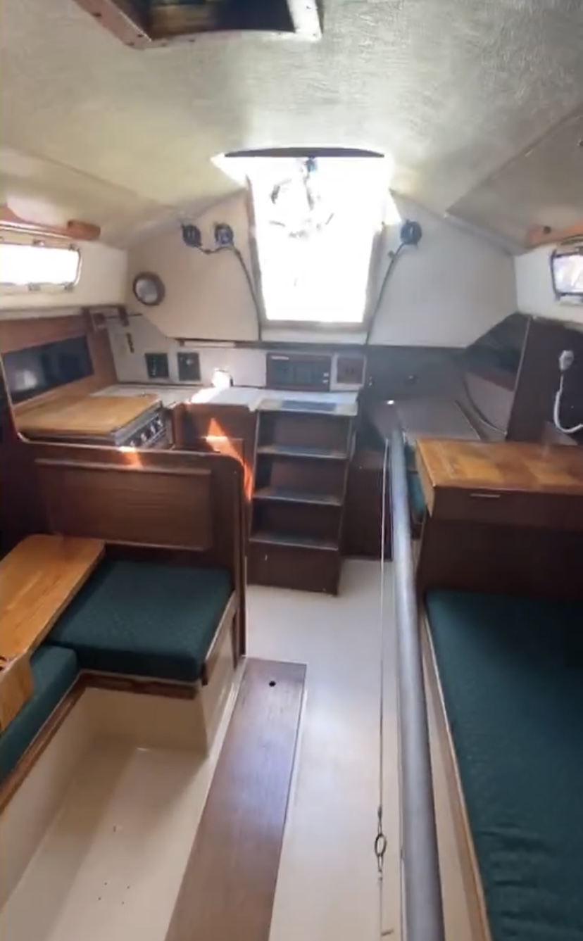

A little arm-chair surveying .... On older boats you usually see some water stains (at the least) where the shroud chainplates bolt through the bulkhead. These look very clean. That is a good sign. I also don't see any issues where the compression post bolts through the cabin top nor around any ports. A pressure wash and some paint might just double your value...:thumbup:
If the underside is solid you might have a real (dirty) gem here.

Thank you - I agree with fingers crossed :) No real sign of water discoloration on the cabin woodwork at all. And doesnt smell "musty", seems fresh. Its interesting because most of what I have seen of the cabin, bilge, chain plates, keel bolts etc looks like the PO cared for it pretty well(except for the deck which of course is not good)

I would definitely remove, inspect, and re-bed that aft stanchion (first post) and inspect the chain plates (because they hold your mast up, not because there's anything obviously wrong); otherwise I don't see anything except cosmetic issues. Re-bedding is an easy job with bed-it tape; do a search for Maine Sail's posts on the topic. Having done some deck re-coring myself: it's not too difficult either if you have tools, space, and time, unless you want your repairs to be invisible.

The inside is so good that I suspect this is just a "miracle" deck coating that has failed. It will have to be sanded off and some new deck coating (with non-skid) applied.
But I would talk to the owner. Anyone who takes care of a boat that well will know the story of the deck. Are you sure it's not soft? Have you tapped it?
I'd assume that all the deck hardware needs rebedding. But that would be expected on a boat this age.

JBP-PA
