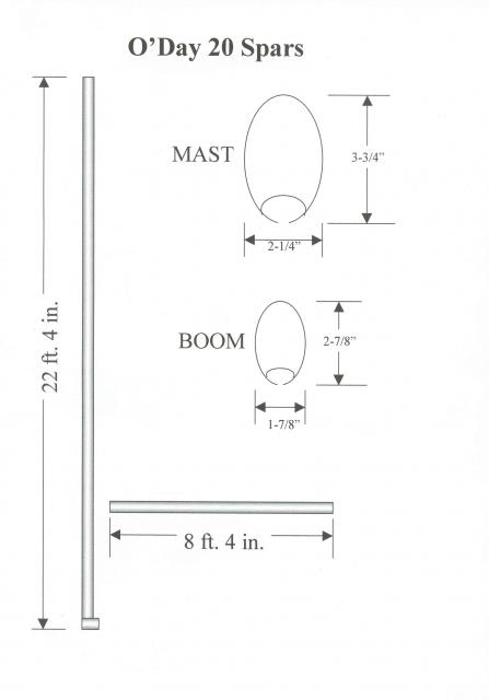

I have some copies of brochures & technical info that came with my boat. They're in .pdf format & I'll be glad to post them or email 'em to you.

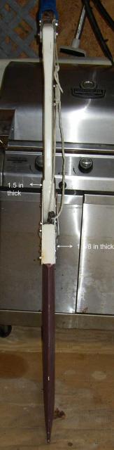

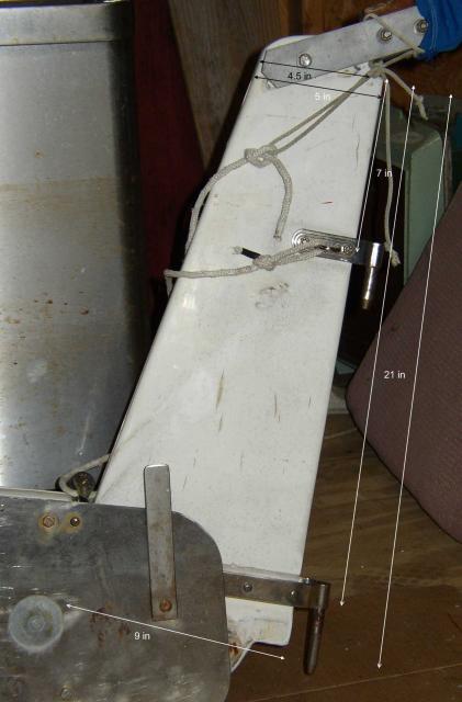

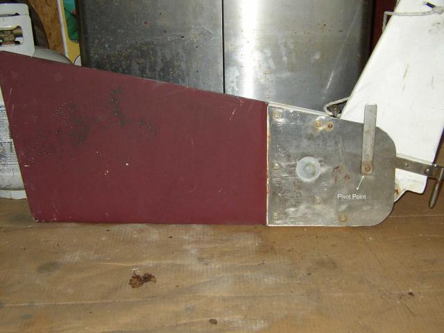

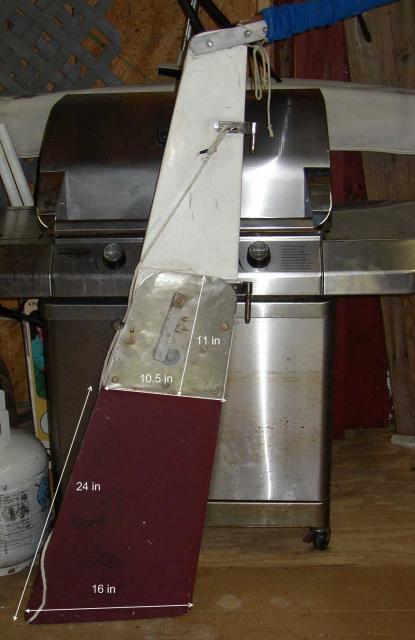

Slarkin: Attached are pix of my rudder with close (but not exact!) measurements. The board is in 2 pieces (except the tiller) and is joined with a stainless steel sandwich. It appears to be glass coated and the kickup piece has the weight (I didn't weigh it, but I'd guess about 50#).
The pivot point is a stainless bolt and nut with a handle to adjust the friction at the pivot. Good luck.

is this the original rudder or did someone modify the original rudder. the rudder looks alot like my original oday 20 rudder only mine is fixed. it also doesn't weigh 50lbs as i lift mine out each time when the water is low.

I'm having difficulty with this Forum (could be my lack of computer skills), so if this reply is a repeat, I'm sorry.
Bought this boat used & PO was not the first. I suspect that the rudder is original - the boat is a centerboard & was well taken care of; very few mods.
The weight was just a guess, I'll try to borrow the Admiral's bathroom scale and weigh it.

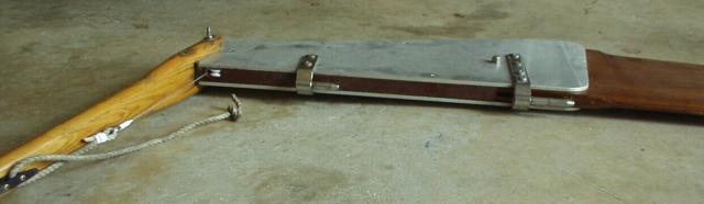

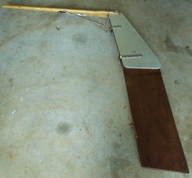

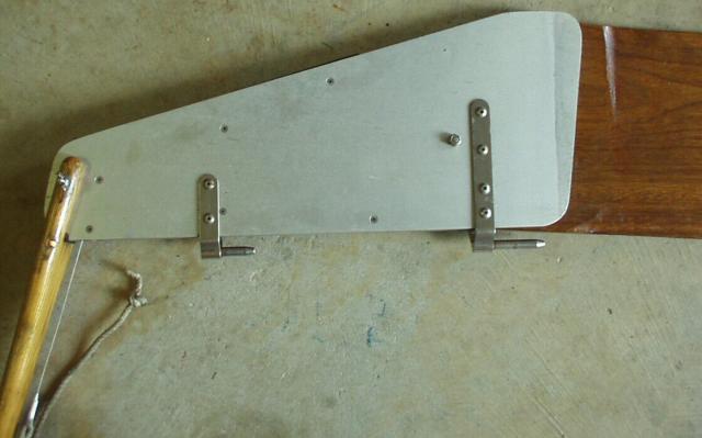

This appears to be the original fixed rudder, modified to kick-up. The Factory Optional kick-up rudder looks similar but has aluminum cheeks that extend up to the top of the rudder. Profile seems to be the same as the original fixed rudder, but construction is wood and aluminum instead of fiberglass w/foam-core. Here are some pictures of the factory-optional kick-up rudder, I received these from an O'DAY 20 owner.
BTW: All O'DAY 20's were built as Keel/CB boats as far as I know, and the standard rudder was fixed, not kick-up. I'm not sure why O'Day didn't make the Kick-up rudder standard from the start like on the 192 and 222.
